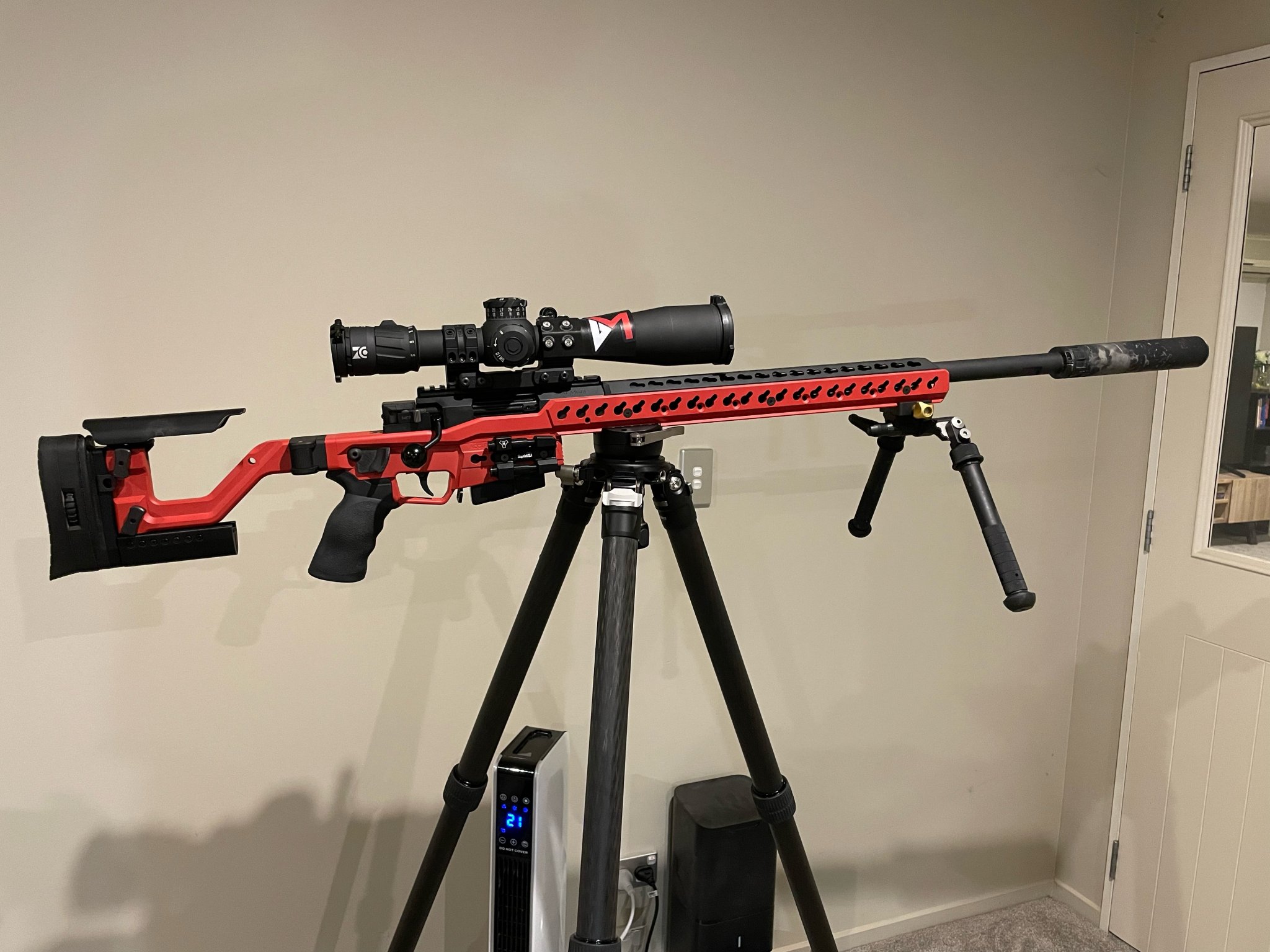

Not the exact model you're looking for but I'm also using the 20moa mount with 38mm height. Without the forend bridge rail you have enough space to fit your fingers underneath.
