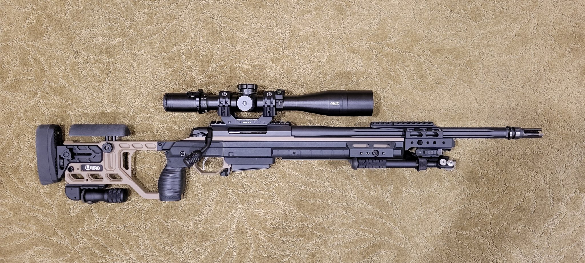

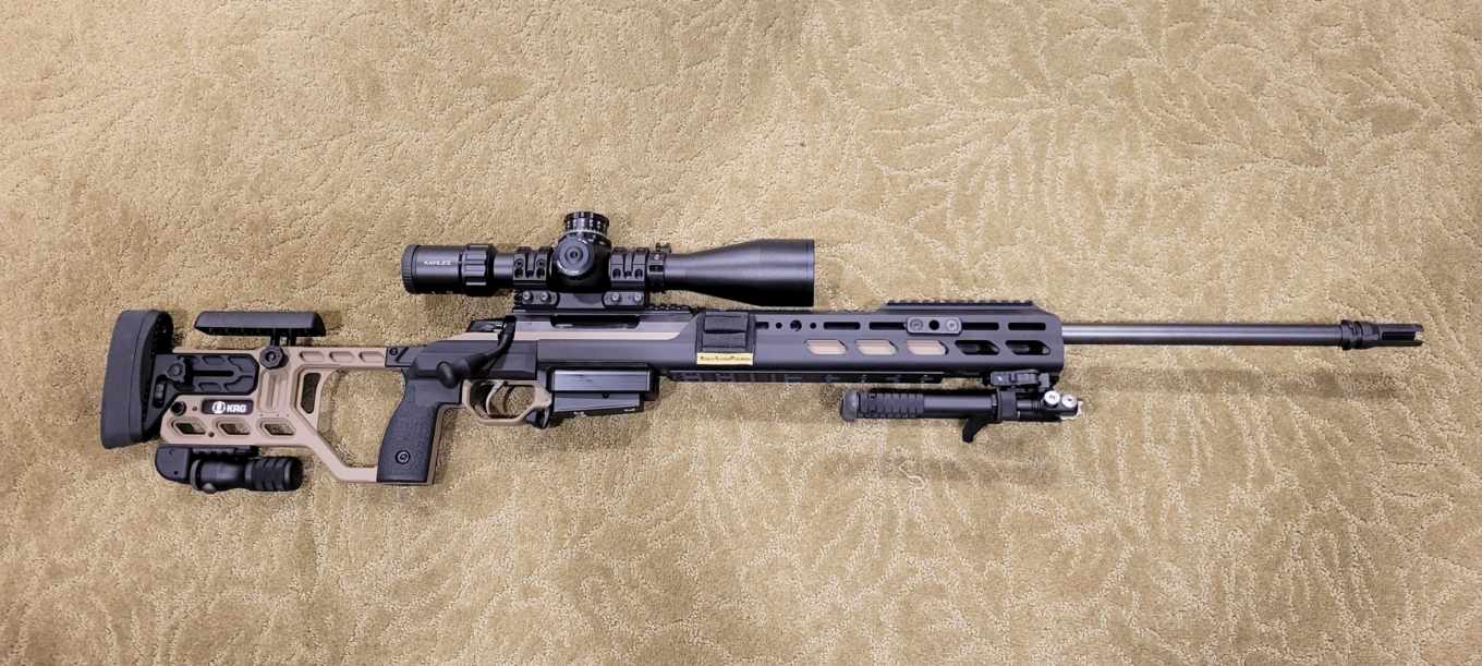

Pictured 1.36 and 1.50 mounts for comparison. The 42mm ATACR objective + 1.50 will have slightly more space over the barrel as compared to my 44mm front on the LRHSi.

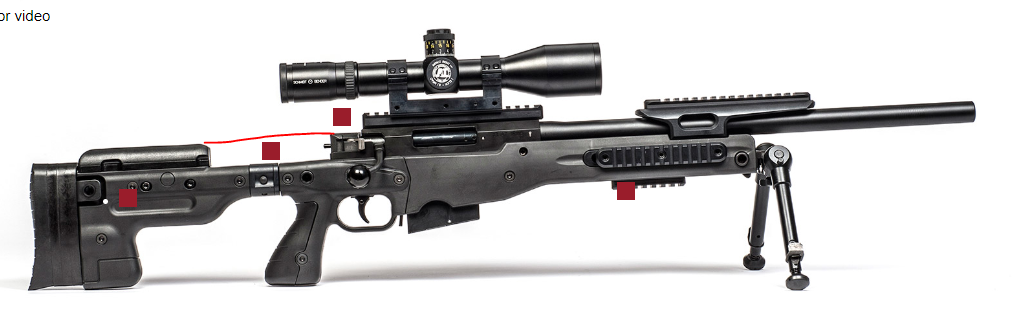

Have you shot an at? The cheekpiece at its lowest on an at is equal the top of the action where others are halfway up its adjustment range to get to that level. Its not that you need that much clearance for the scope itself, its that you need that much for your face to get in line with it without rocking it on the side like a confused puppy. .
For me at least.
