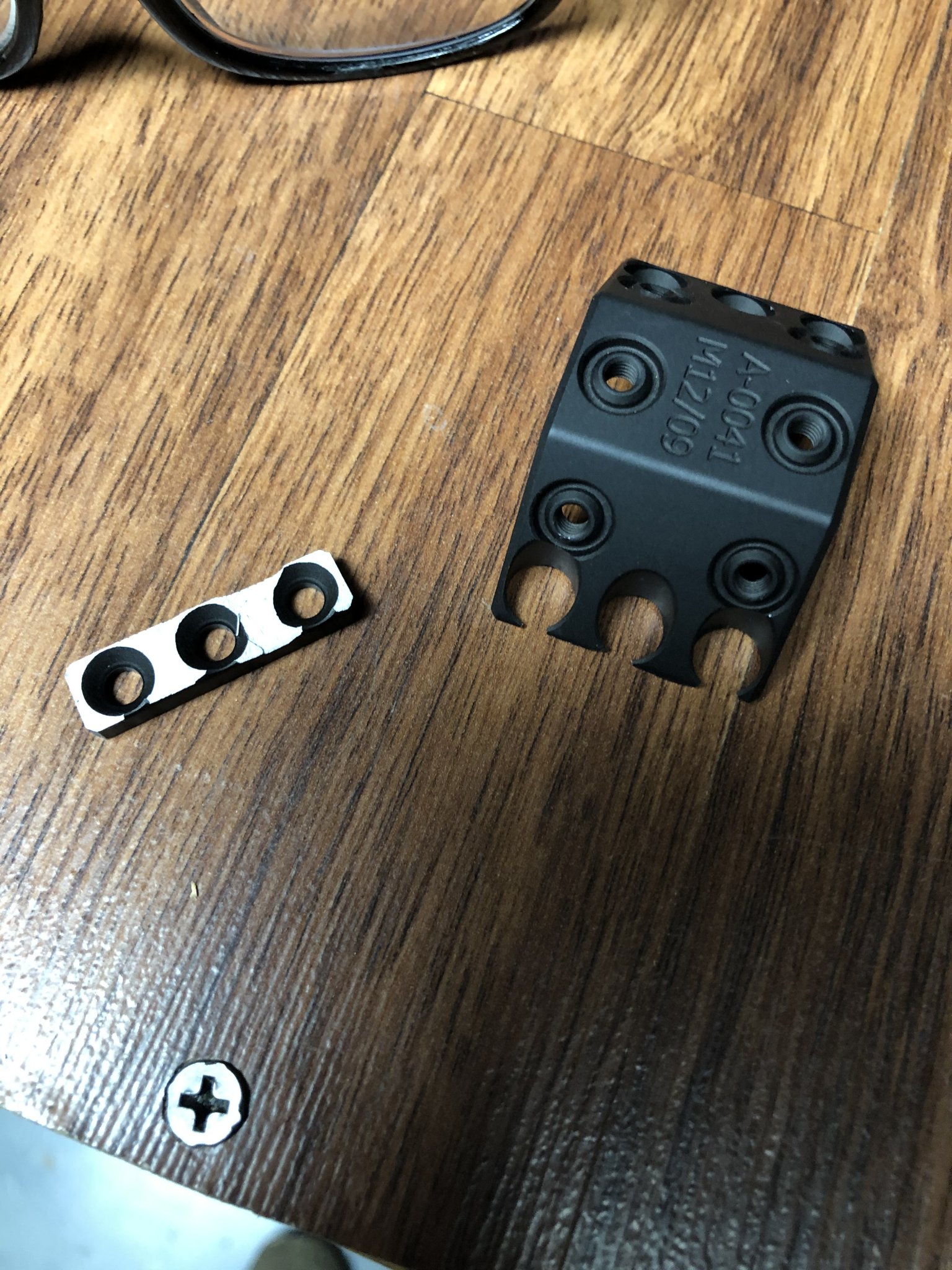

Spuhr revised the ring screw spacing a couple of years ago to leave more material around the outermost screws, possibly for this exact reason. Both of the pics you linked to are of the "gen 1" design (identified by the totally flat ring caps.) The "gen 1" ring caps get rather thin near the edges of the counterbores for the 4x outer ring screws which probably serves as a nice crack propagation point.
The "gen 2" revised mounts moved the outer ring screws in towards the center ring screw a bit to leave more material around the 4x corner ring screws, and they can be identified by a milled "trench" cut connecting the two middle ring screws. I've seen those pics of cracked "gen 1" ring caps before, can't recall ever seeing a cracked "gen 2" ring cap. Unforutnately you can't swap a gen 2 ring caps onto a gen 1 mount as the screw spacing is different.

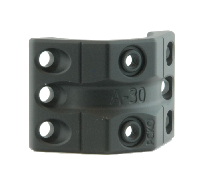

I had a ring crack a couple years ago on one of my Spuhr mounts in the same spot as described. Spuhr sent me a new ring and did not seemed surprised about the crack. They seemed to know it was an existing issue.
A picture I found on another forum.

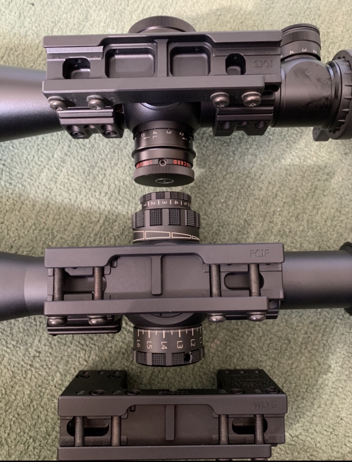

Can someone post a V1 vs V2 photo showing the "more material around the outermost screws" please?
I think I have two of each but what the hell do I know...
Gen 1
Gen 2
Note how the gen 2 moved the 4x outboard screws in towards the center a bit more leaving additional material at the outside webs, this makes them less susceptible to cracking.

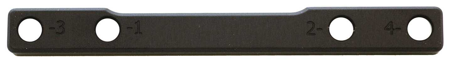

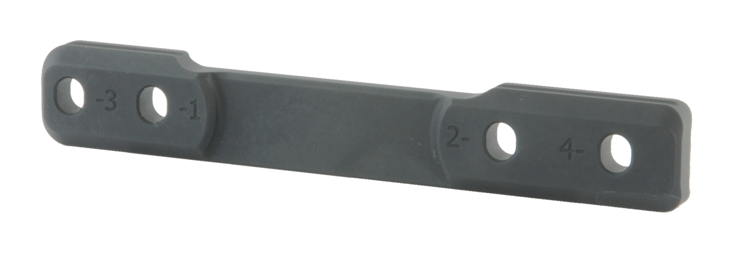

Spuhr also revised and added additional material under the screws on the clamp bars a while back.
Older style flat clamp bar, I've cracked 2 of these at the outermost screw holes.
Newer clamp bar with extra material thickness under the screws. Besides the extra thickness, the outer 2 screws are no longer as close to the edge of the clamp bar.

Gen 1
Gen 2

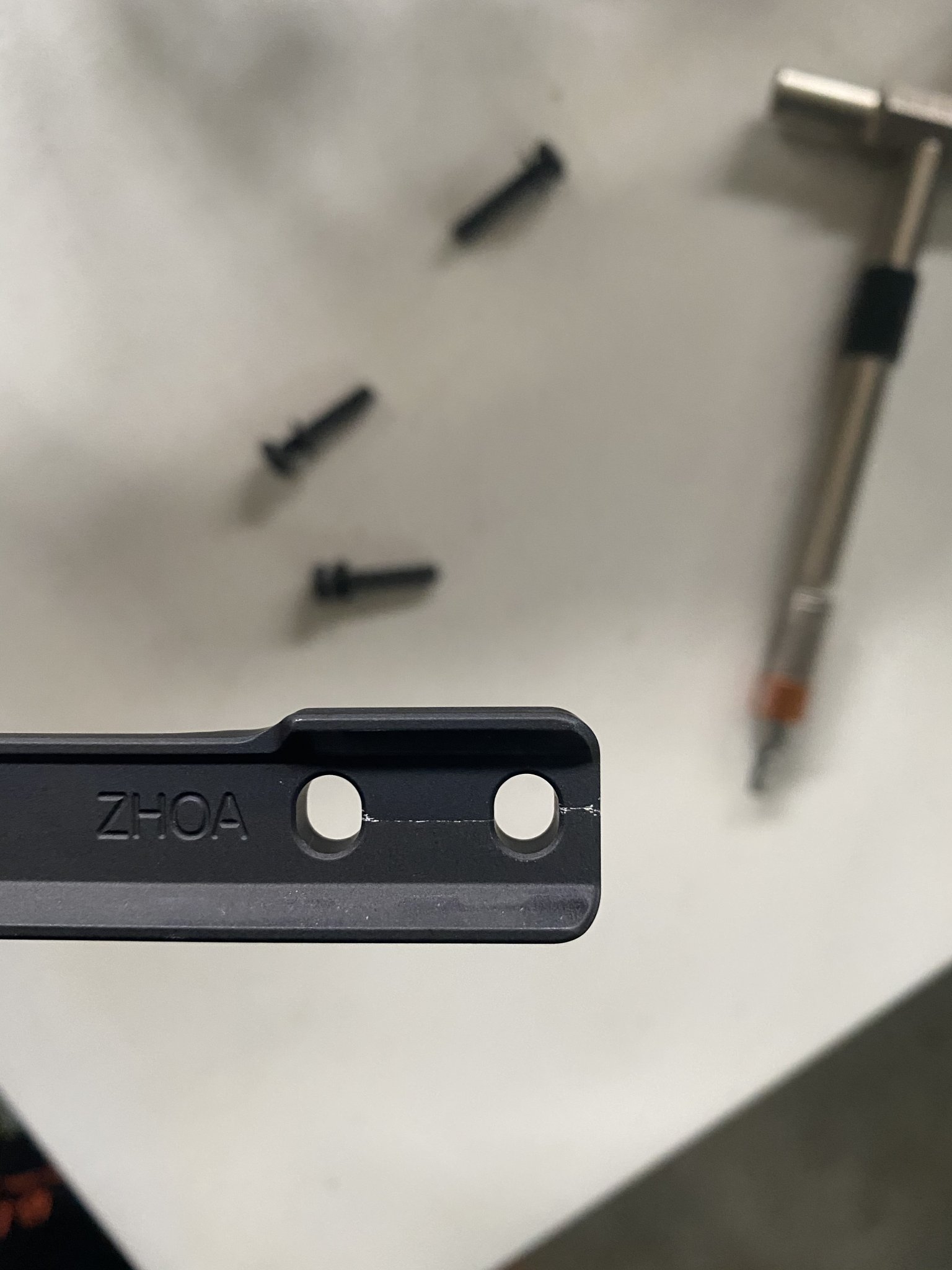

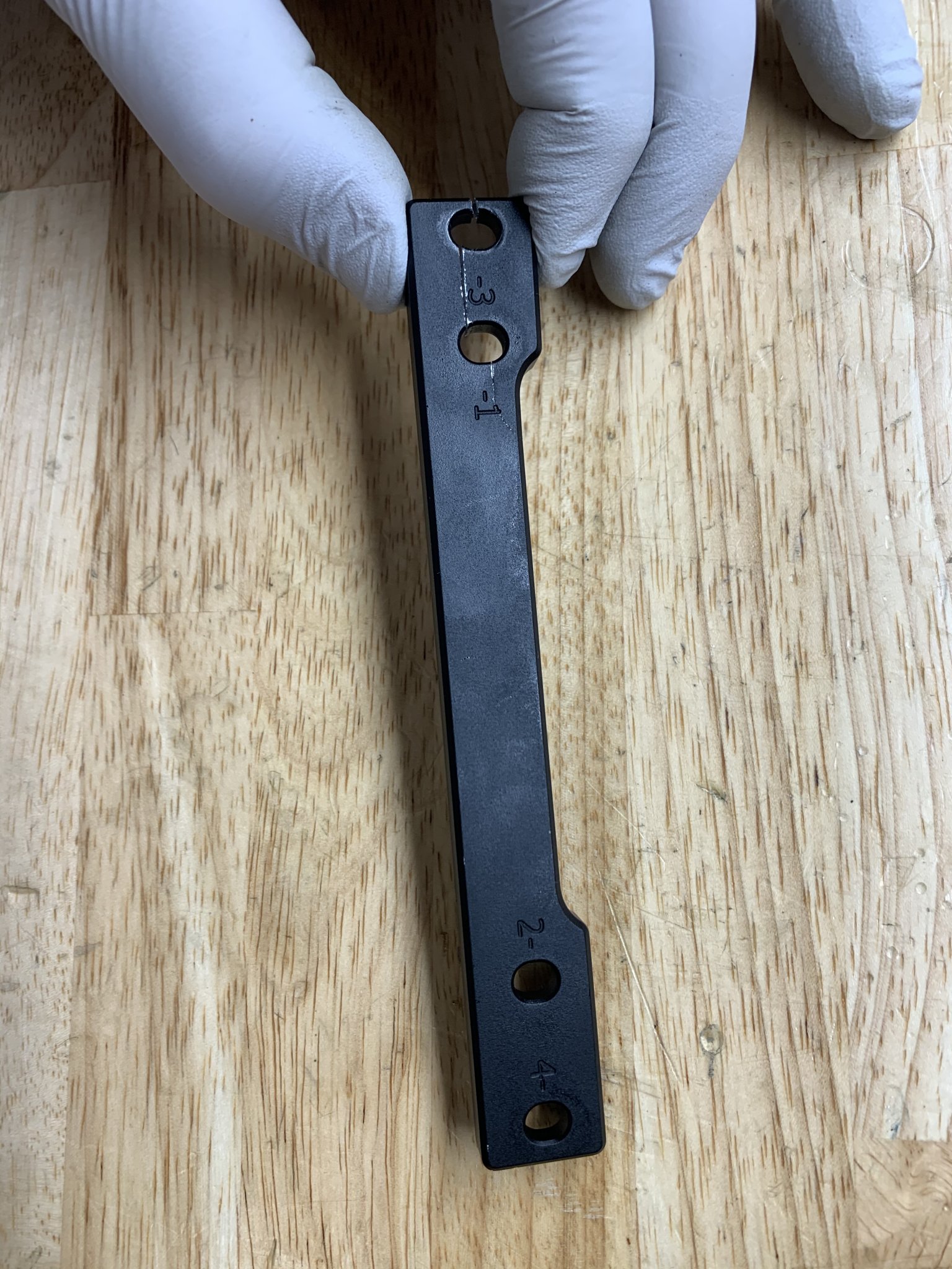

Anyway. To the point in hand, I noticed yesterday than on one of my clamp bars had cracked. Always torqued to 45 inch lbs, so not at fault there. It’s also kindly being replaced. However in checking others I noticed that the underside of one of mounts is different to the others. See pic. Now I wondered if anyone knew if this was a gen 1 / gen 2 thing or if different models have different designs?
They are based on the height of the mount....your low mounts ending in 1 (3001, 4001, 3601, 4011, 4901 etc) will have the exposed clamp screws. The higher mounts (3006, 4006, 4002, 4602 etc ) will have enclosed clamp screws.
Hope this helps

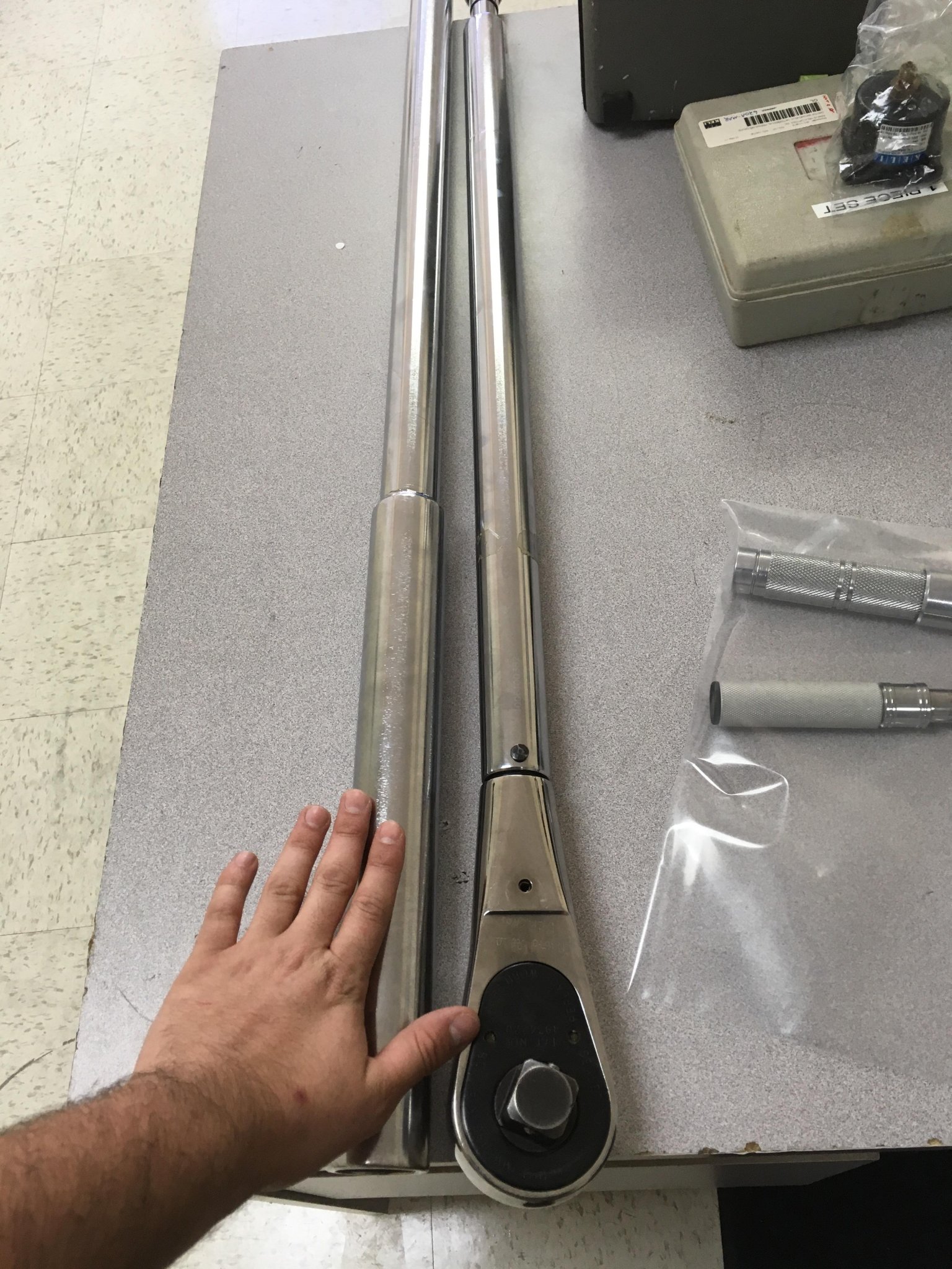

I listened to the podcast covering this. Here are a few thoughts on torque.
1. Follow manufactures torque specs
2. Torque in manufactures tightening sequence. If no sequence provided wot from center of screws out.
3. Once fasteners are torqued check every fastener once for correct torque.
4. Keep the torque wrench in your tool box after this. On click style torque wrenches torque stacking is a very real issue. I work with assemblies that call out torque specs in the thousands of foot pounds. These assemblies are subjected to great forces. Normally there is an initial torque and maybe a retorque after a prescribed amount of time. Then the fasteners are never touched.
Most of the issues with these breakage threads are due the issues outlined in your podcast.
Reactions: Ravenworks
We see it all the time,
Guys go over and over checking "torque" but instead they keep hitting it and hitting it, increasing the issues and causing problems
if you are not sure it's right, put a damn witness mark on it, hitting the screws every time invites problems
Exactly. Torque the fucker the correct way and move on. It would be like retorquing the heads on your engine before you drive your cat every time
