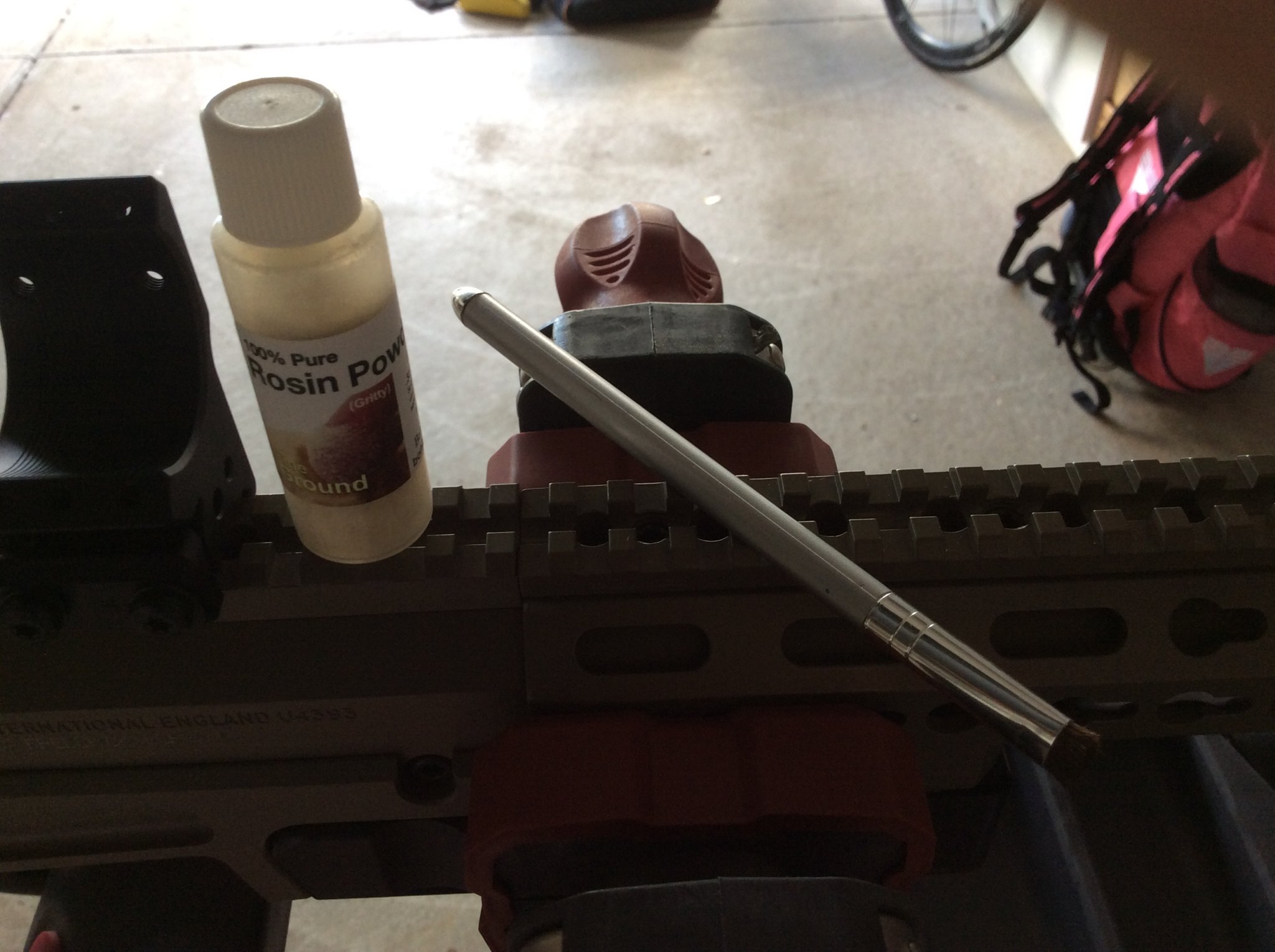

I used my girlfriend’s eye makeup brush... powdered rosin on the bottom rings and then on top of the scope (p,acing the second half of the ring in place... torque to 22 ft lbs. I’ll be testing this weekend (308).
