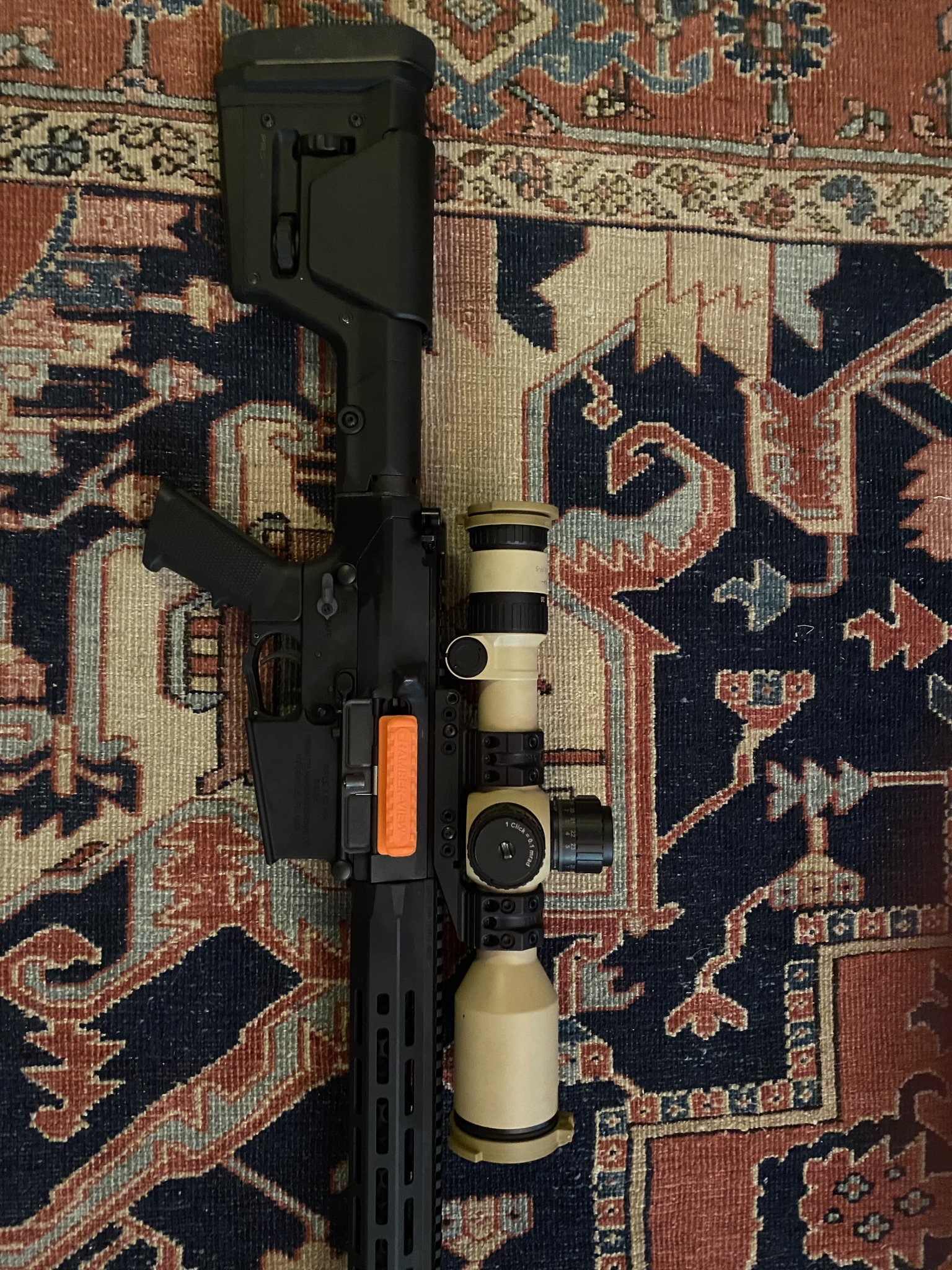

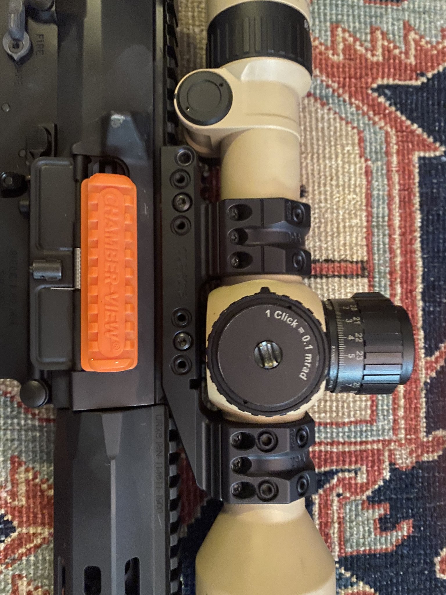

Agree on the inclination but the issue for me has been that spuhr (or anyone else I have found) doesn’t make 36mm with both inclination and cantilever so if you had a 34mm scope you can use the 4616 but with the ZCO you are forced to choose between the tilt and cantilever and I don’t want to cross the join on my sr25 6.5 between the rail on the action and the rail on the handguard? And eye relief not really right if don’t do that. I don’t think the HK has the monolithic rail like and LMT but has a join like the sr25? (I could easily be wrong.). Or maybe you can get sufficient eye relief without the cantilever?
I’ve never had an issue but that’s just me. We are all different and it greatly depends on your stock and LOP.
PRS Gen 3. Actually the LOP is still a tad too long even with that fully collapsed. Look how far over the join it would be without cantilever…. Maybe I have weird eyes.

Here’s the thing, and this is pure opinion. That ZCO is wasted on a 308 and a gas gun. You’d be better served getting a 4-16 atacr or some kind of LVPO and using that beautiful ZCO with all that elevation on a better flatter caliber.
now having said that, the big issue with gas guns and optics is charging handle interferences. That prs stock has a 13.5” minimum LOP, you will have to move that optic back. It will not work with the diopter flush with the charging handle.
I use a spuhr on all my gas guns but I’ve stopped running big optics on them too. I have one left to replace. I’ve gone LPVO or to the small 4-16 range that I suggested. My gas guns are purpose built and while many have the ability to reach a mile, their strength is in the under 1k, realistically it’s more like 800. I’ve also began replacing my prs gen 3 stocks because the LOP is just too long. It’s an awesome stock but they need to revise it in gen 4 for smaller LOP and or a collapsible version for gas guns.
