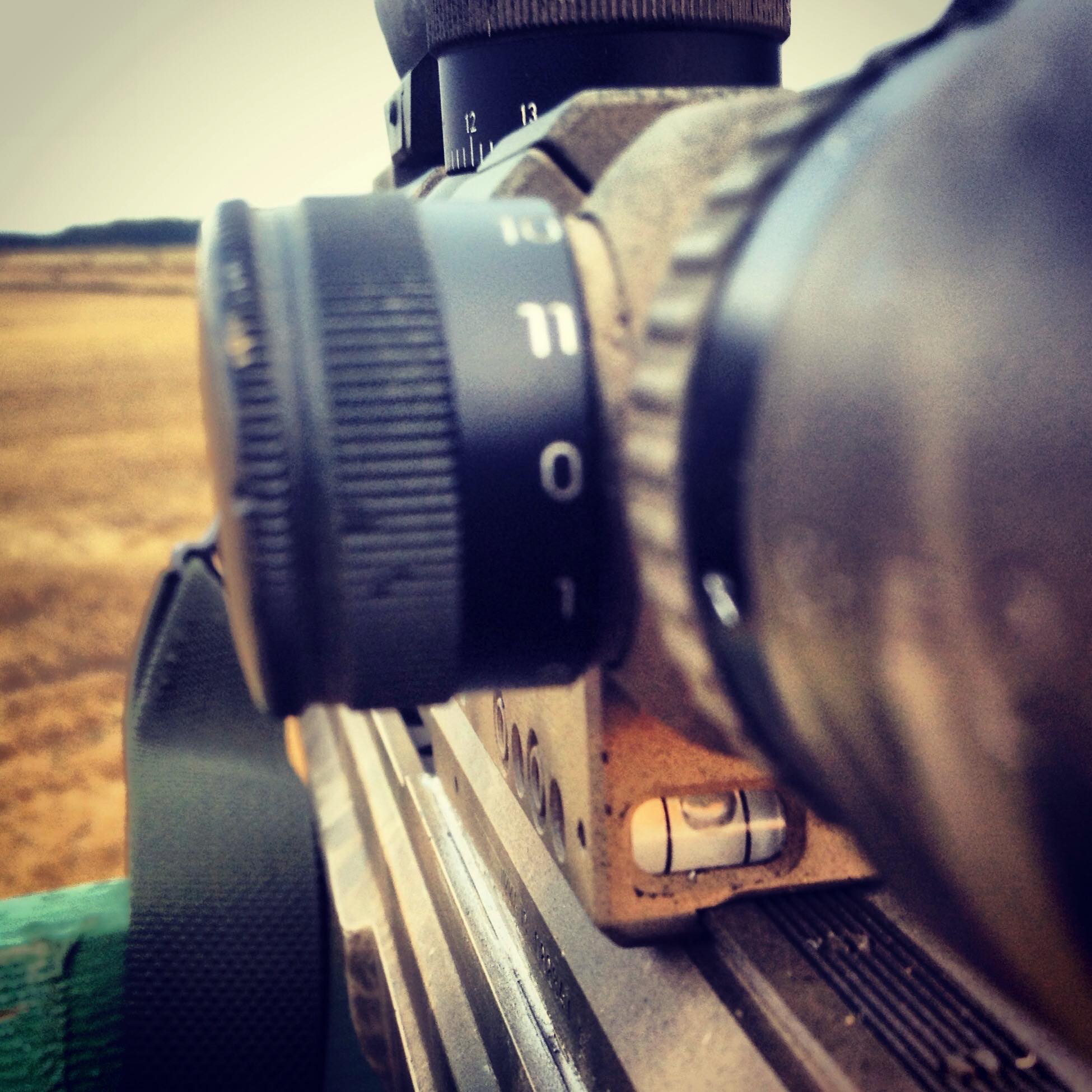

Here is the picture I see when i am aiming throgh the scope.
Level is seen with left eye as right eye looks through the scope.
A separate level is more visiable, obviously.
But this is there always, never lost...

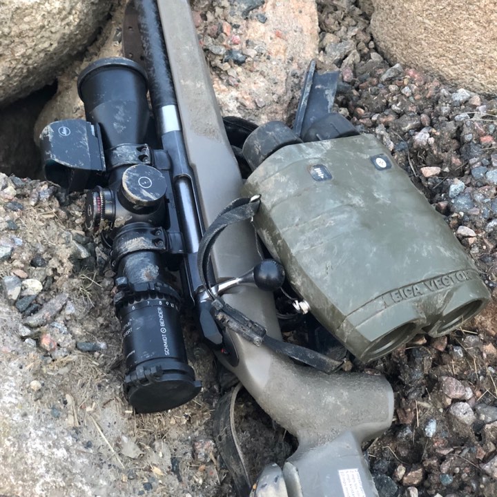

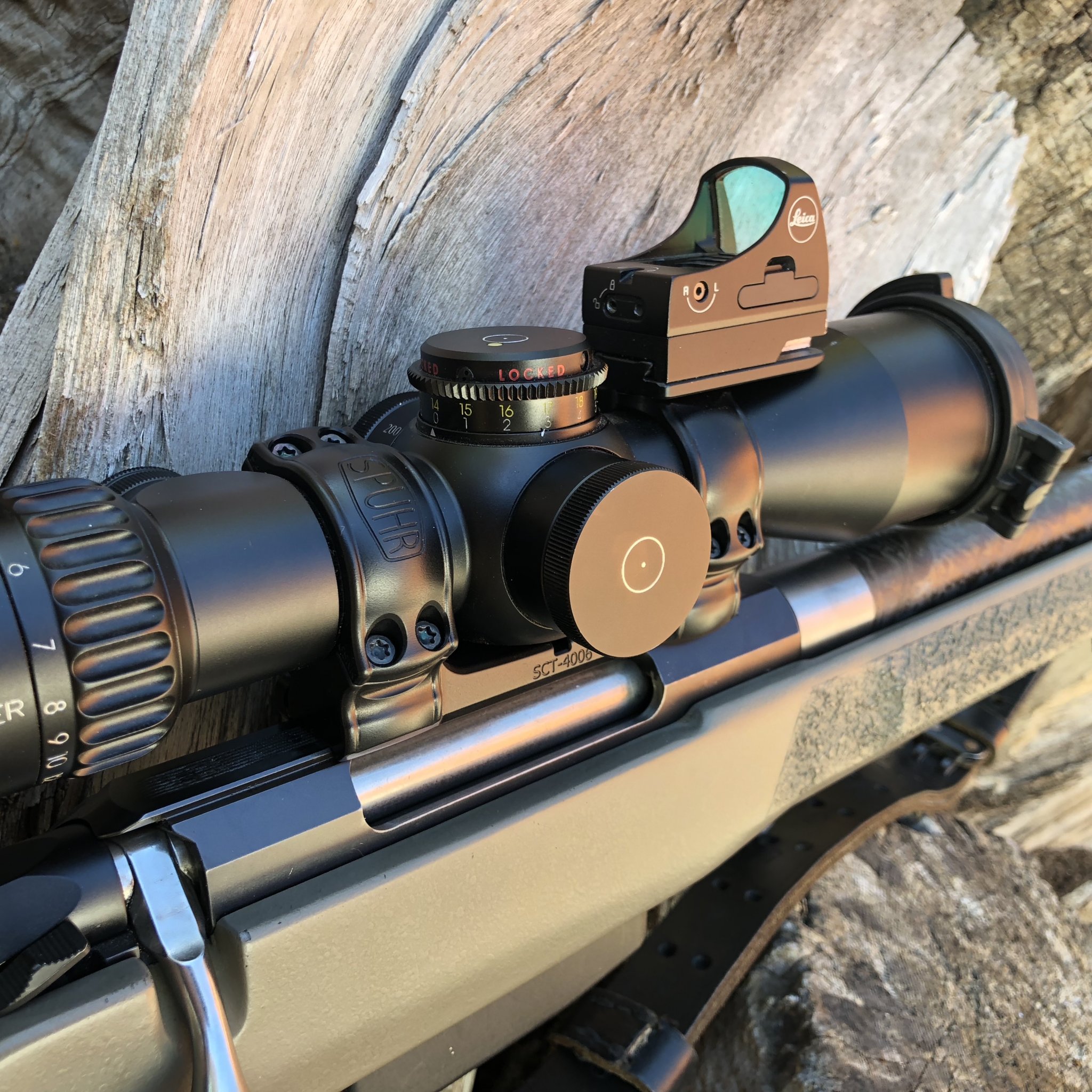

For those who prefer a light mount that is only four screw we also have our hunting series of rings and mounts.
There is no built in level, and there is not as much possibilitys when it comes to attachments, but there is 1-2 for those who needs it.

For me personally I can see the level with my weak side eye. Putting the edge of the bubble on the line is perfectly centered if I were looking at it square. I could see it below the occular with a Bushnell lrhs.
Same here, bubble lines up with the left side line and I look at it with my “off eye”.
Easy for me but I shoot both eyes open.
