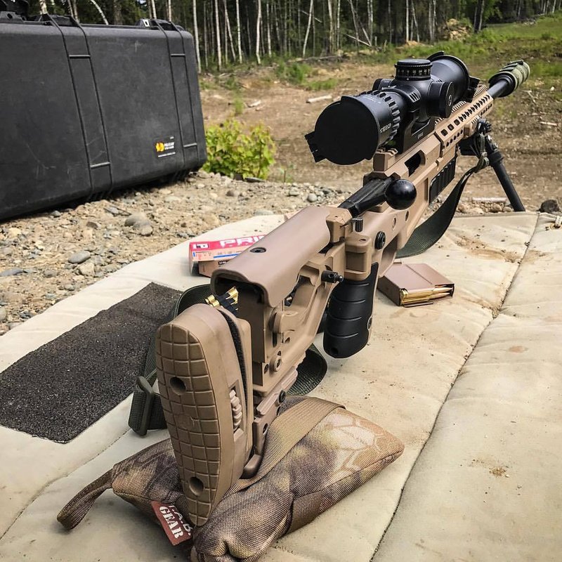

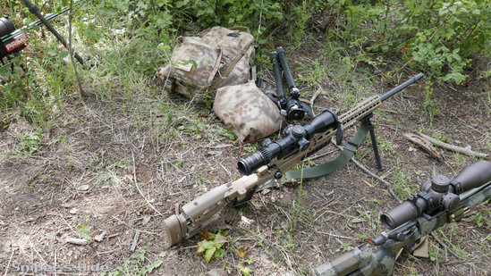

I ran the RRS rings hard this past month.
I attended both the Sniper's Hide Team Challenge with them and took the rifle to Alaska with me.
19420857_10155422973057953_5388019572491608115_n.jpg?oh=457189763c34712d7d17d48bd06c6fb1&oe=59...jpg
19030336_1467191066637745_5234864249339711394_n.jpg?oh=25244acc9fa43472e31cf274da9932dc&oe=59E...jpg
They are definitely a viable option out there. Especially if you don't plan on mounting other devices to the rings. I know more options are on the horizon, but these are very good no nonsense rings.
The small lip in the ring cap helps index it, you get a leveling tool much like the Spuhr but a bit more universal as it's not built into the rings.
Size, weight, and ring spacing are all good.
Seen above with a S&B Ultra Short 3-20x
