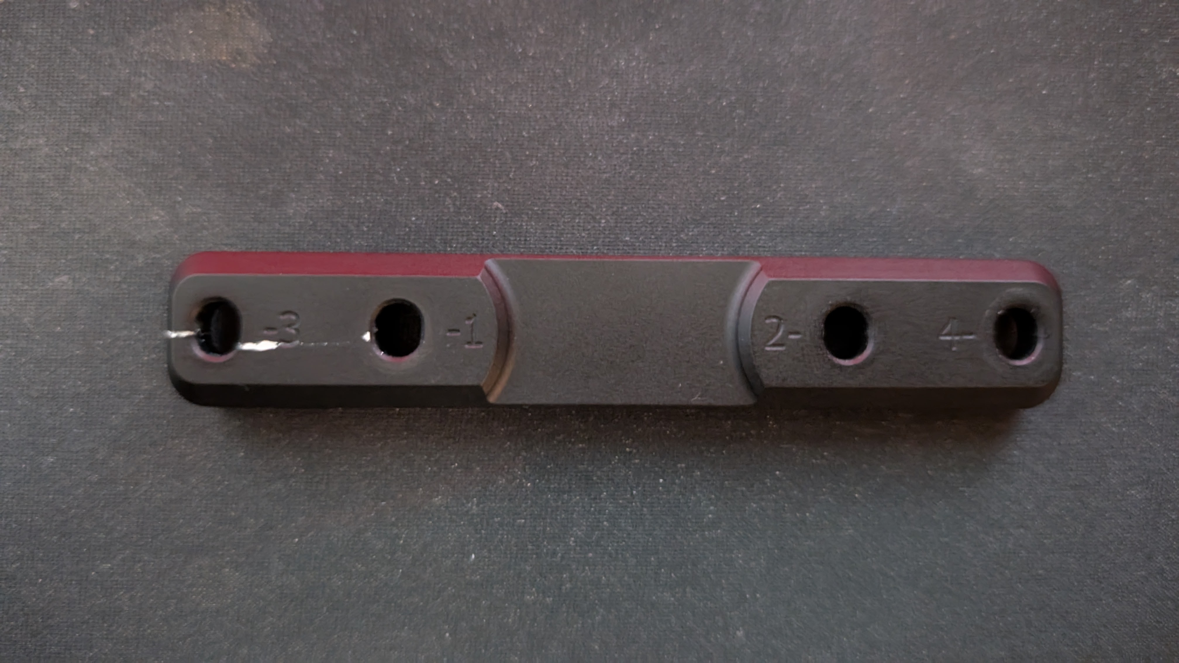

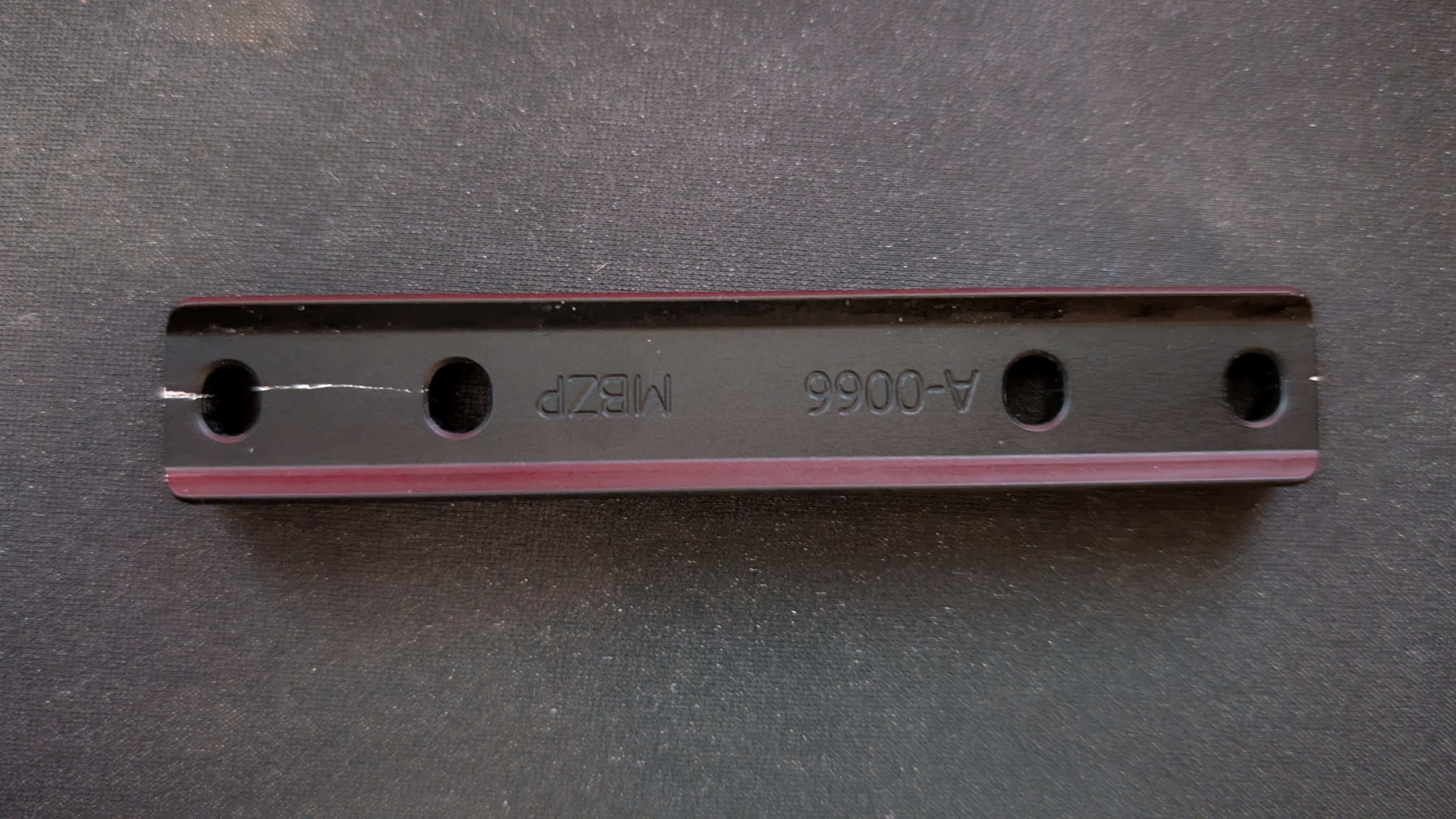

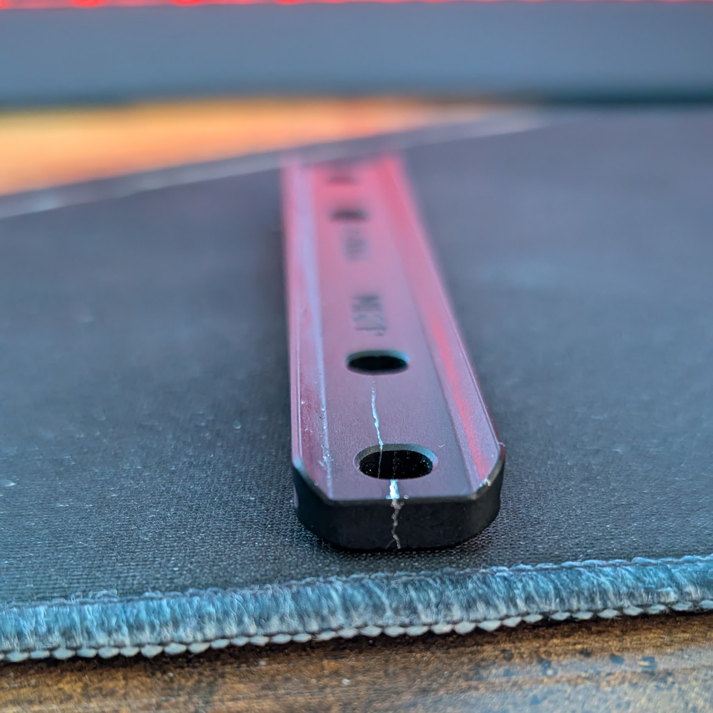

Spuhr Warranty
The crossbar on mine cracked. Mile high provided a new bar and new screws free of charge. I was not original owner and no idea where mount was originally purchased. And they knew this before helping me
Spuhr resigned the crossbar and beefed it up with a thicker crossbar that Mile High (Who is Great) will replace the broken one with. I had to replace and Cerakote the new one to match my FDE version. Also, the new beefier crossbar I don’t think, will have the same malfunction as the older one, if one breaks. They’re pretty thick.
Like this one…?
Oh crap…that’s the beefed up one?…Cracked too?
Disregard all after hello…
My thread
Reactions: cschastain2
Same, Spuhr answered my email within a few hours, and I had the replacement in a week. I had two 36mm mounts, one side plate cracked, one hadn't. Sent out two anyway.
Cheers
Pete
My thread

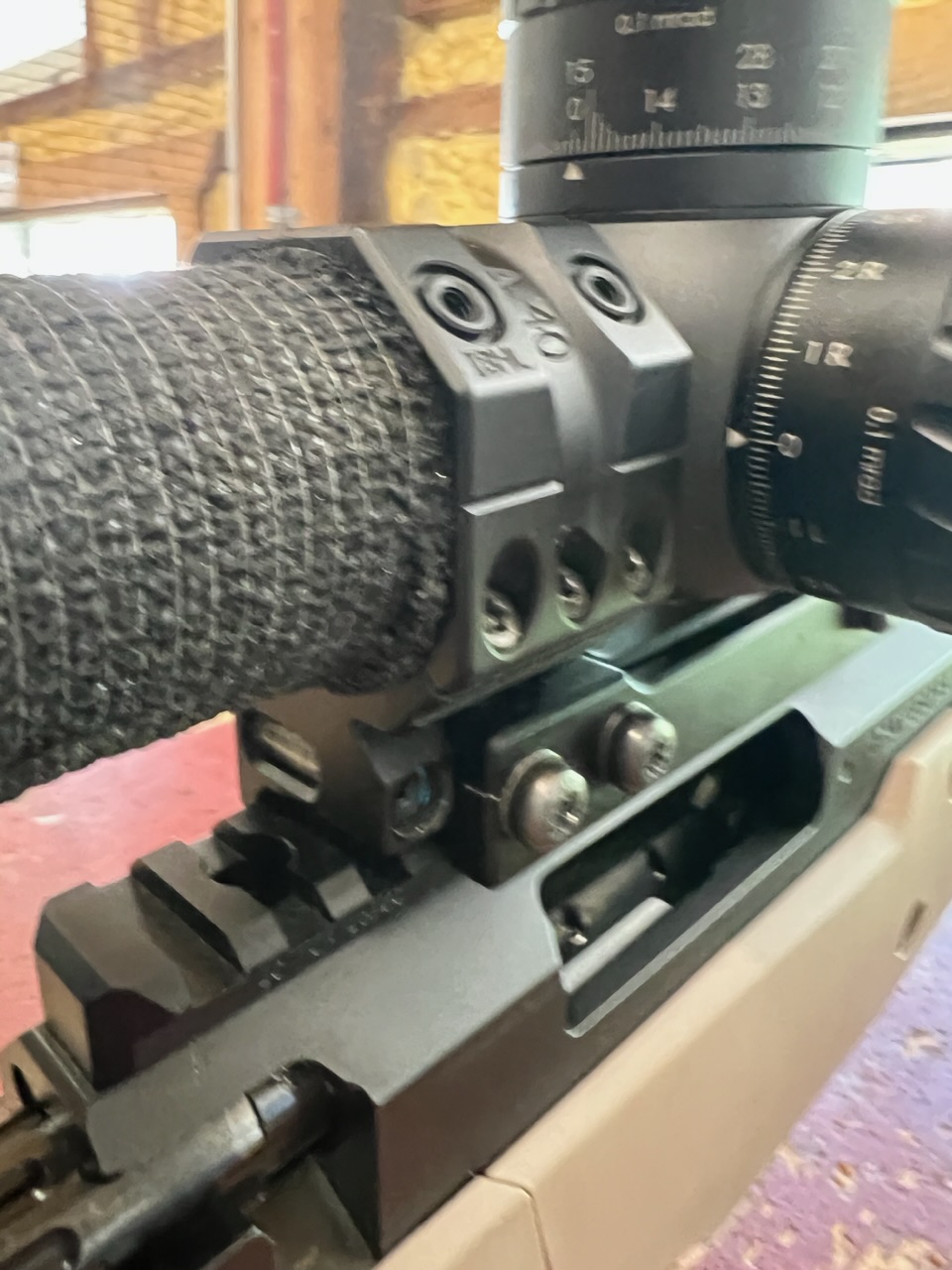

I thought the secret was the use foot lbs instead of inch
Funny enough back when I was a total n00b many years ago I did something like this. Managed to bend steel Badger USMC rings.
Funny thing is the Steiner M5 I was trying to mount turned out just fine, just some ring marks. That scope is still in use today on my wife's rifle.
No nf could have survived that 🤣
I have 3 spuhr mounts and a I break everything down and re torque them a few times a year. Zero issues.
I must be lucky
I must be lucky too. Probably mounted over 100 optics in spurs on rifles and never had an issue.
I go though the pattern and just slightly tighten all the bolts. And gradually torque up to spec. When removing I also don't losen one bolt all the way at a time. Maybe quarter turn ish at first on each one. Half turn second time through, and then all mostly loose to all the way on third pass. This keeps all the tension from building on one bolt or screw. Never broke a cap or clamp doing it this way on install or renoval. Maybe overkill, but it's a process that's worked for me.
Yea I got like 6 currently but have owned probably over a dozen with heaven knows how many scope swaps as I like to play scope of the month 🤣... Fingers crossed I have yet to crack one or have a scope slip

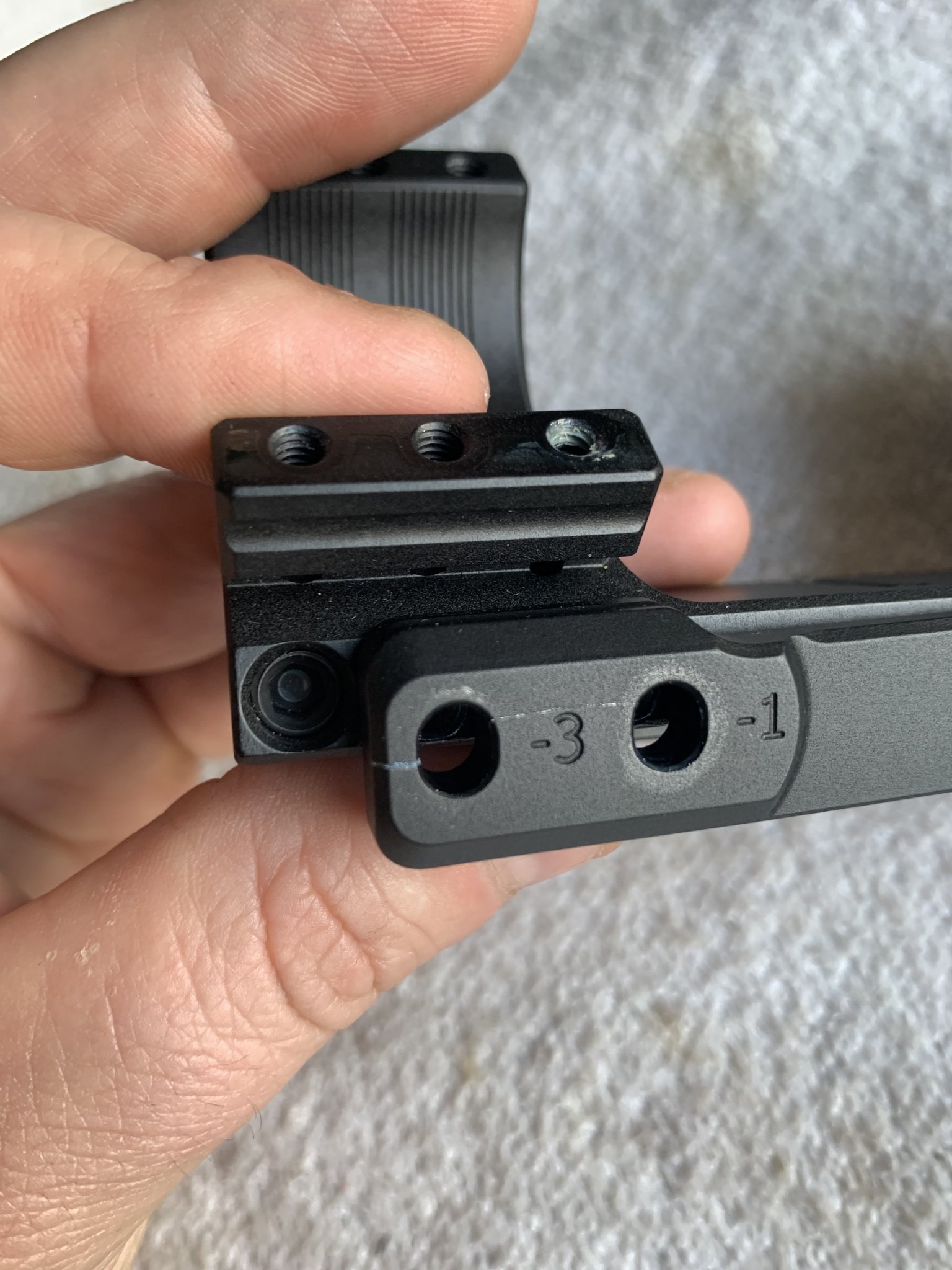

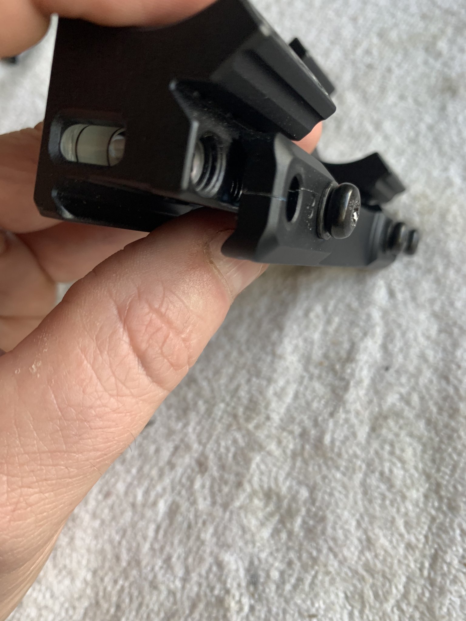

came across this old post when searching similar issue with my Sphur mount.
I had mine a couple of years ago, and I was aware of this cracking issue but I thought I was lucky until today. The side plate of my Sphur just cracked the same way as others have shown here. I did not even touch the screw and the plate just cracked. I guess this will eventually happen when the metal is under stress for a long time?? either way, I'm disappointed and I'm reaching out to Sphur for a replacement. Hopefully this will be resolved properly
Update: Milehigh came back to me quickly. no question asked, and I'm getting a replacement side clamp. I hope this one lasts longer.
  • Sad
Reactions: carbonbased
