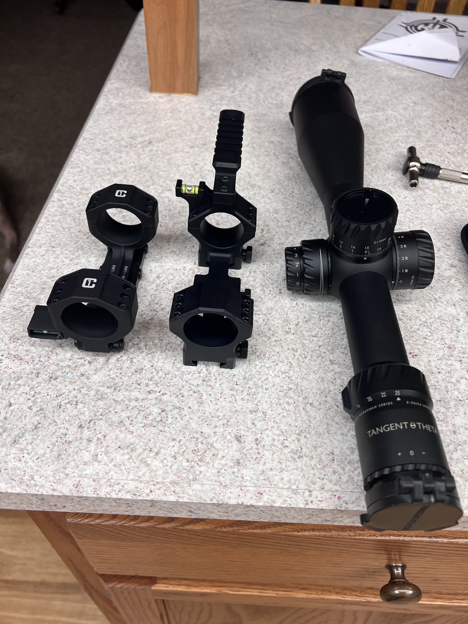

I will say I purchased both the Hawkins mount and the Badger ordnance max, they are both equally great. I’ll be mounting them up soon and see what I like more. The badger is just a hair taller at 1.3 and the Hawkins at 1.28

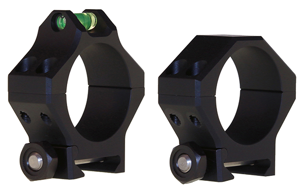

Hawkins rings are what I mainly run now. Well made. Reasonable price in the PX. Never any problems. That being said ZCOs and SB are still in Spuhrs.
I don’t like the Badger level position and their accessory/overall availability situation has been dismal for YEARS.
