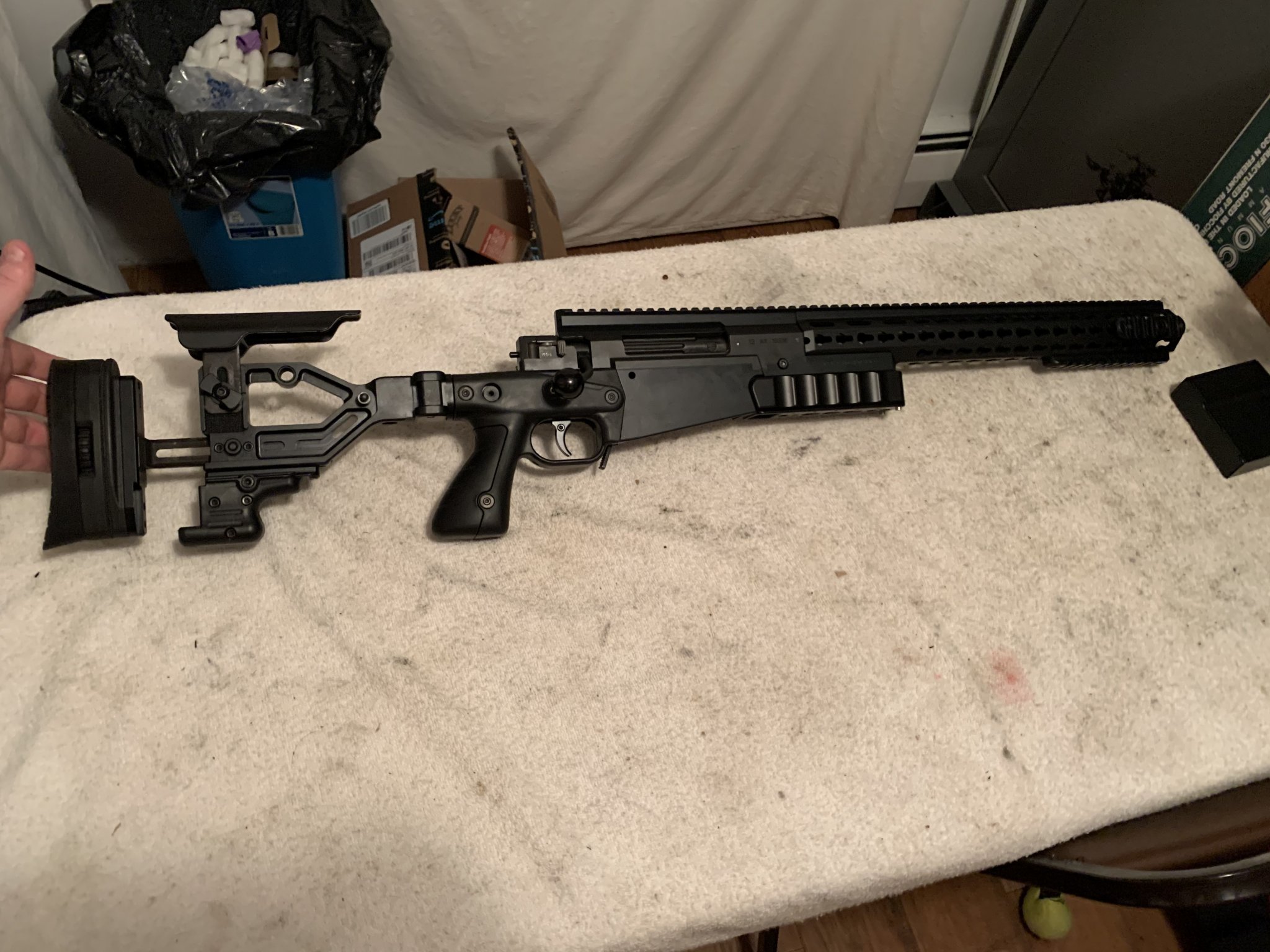

    ATACR 7-35 on AXMC?
    Rifle pic below. Full top rail. Rifle has 30 MOA base so want 0 MOA mount

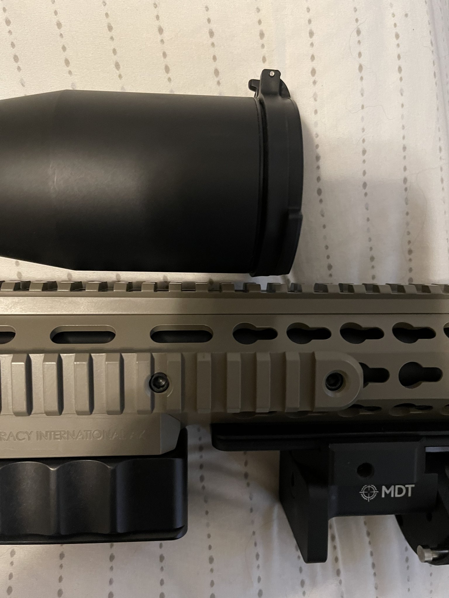

    Showing 1.46” with the tenebraex caps. Thinking I’ll need a bit more than 1.5” 4002 height
    Cutting it really close at 1.46”
    Anyone running this combo with the tenebraex? Pic?

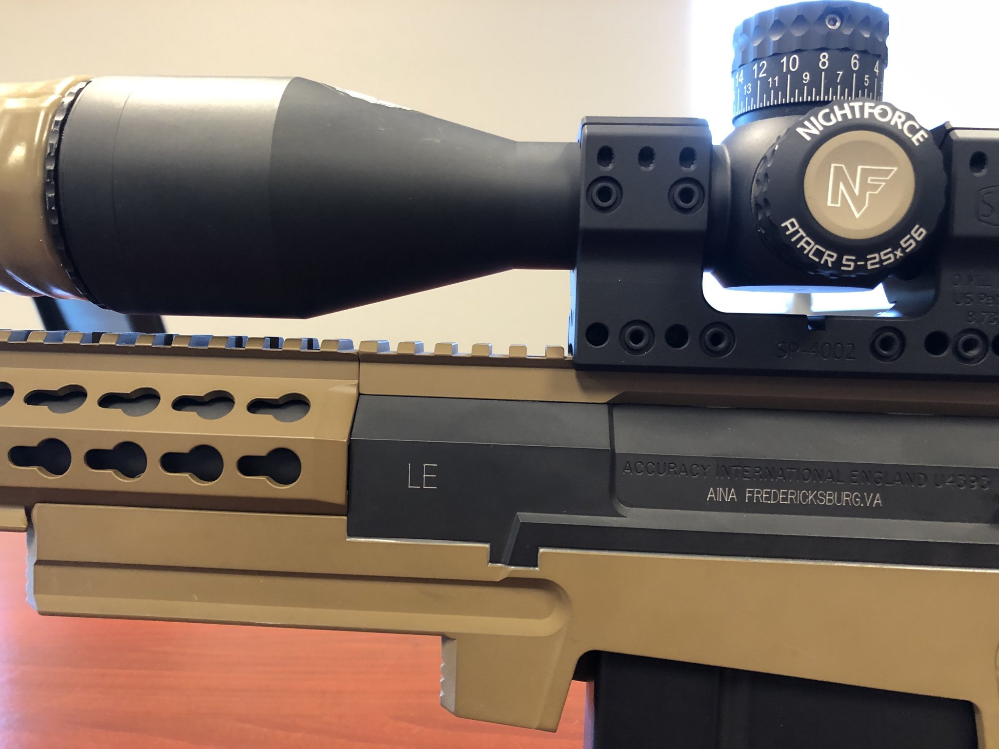

    This is one of my work rifles with a 5-25 ATACR in a SP-4002. Rifle is an AXLE with a 20 MOA rail. The Tenebraex cap is off the ring to facilitate the M2124LR. I’ve mounted dozens of 7-35 ATACRs with Tenebraex caps in SP-4002s on AXMCs. The bottom of the Tenebraex cap is close to the rail but it does clear.
    • Angry
    Reactions: Krob95
    Awesome thank you! I’ll plan to go with the 4002 then. Exactly what I was looking for
