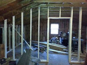

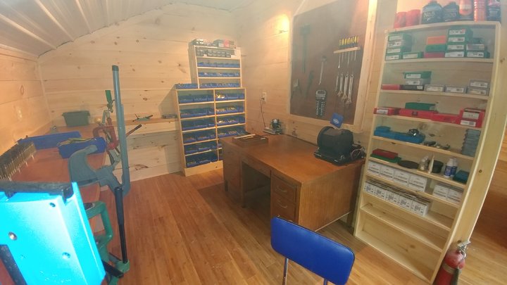

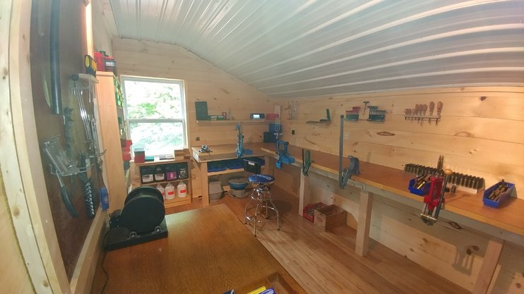

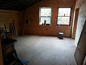

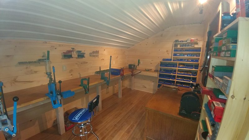

Sure... these aren't great. I meant to take some today. But this was just after I finished it and 'populated' it with brass, boolits and supplies, along with most of the reloading equipment. It's 12 x 16 feet or so. Insulated, heated and air conditioned. Benches are made of solid core doors. Whole place is done in number 2 pine and bamboo floors. Started it in January, moved in Memorial Day-ish. Really only started using it heavily a couple of weeks ago when farm work subsided.
I have a few more gizmos now. Next weekend, I'll take some better pix!
I am also putting these in the reloading room thread. It seems all my older pictures have disappeared. It's in the 'sticky' section. And there are some really inspirational reloading setups there!
Also LOVE the steel pin tumbling setup. Best reloading investment I've made in ages.

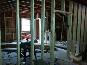

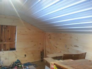

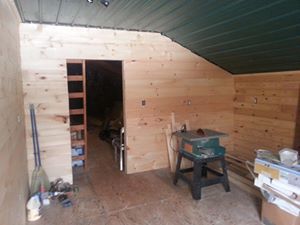

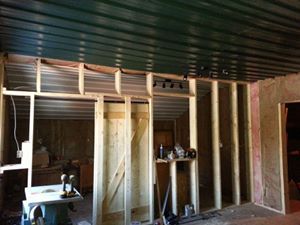

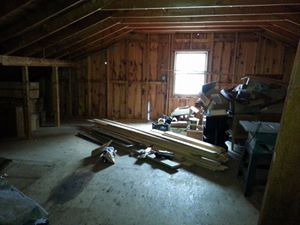

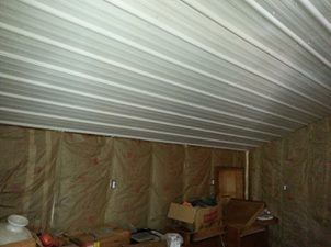

These are the in-progress pictures. I think I started on inauguration weekend... Jan 15 or so. And moved in Memorial Day. Two rooms, actually. One a mini-machine shop/model shop. The other for reloading. Pictures are, I think, backwards in order. But you can see where it started. I'll put them in order in the sticky thread and hopefully, this time they'll stick around. Pardon the pun.
