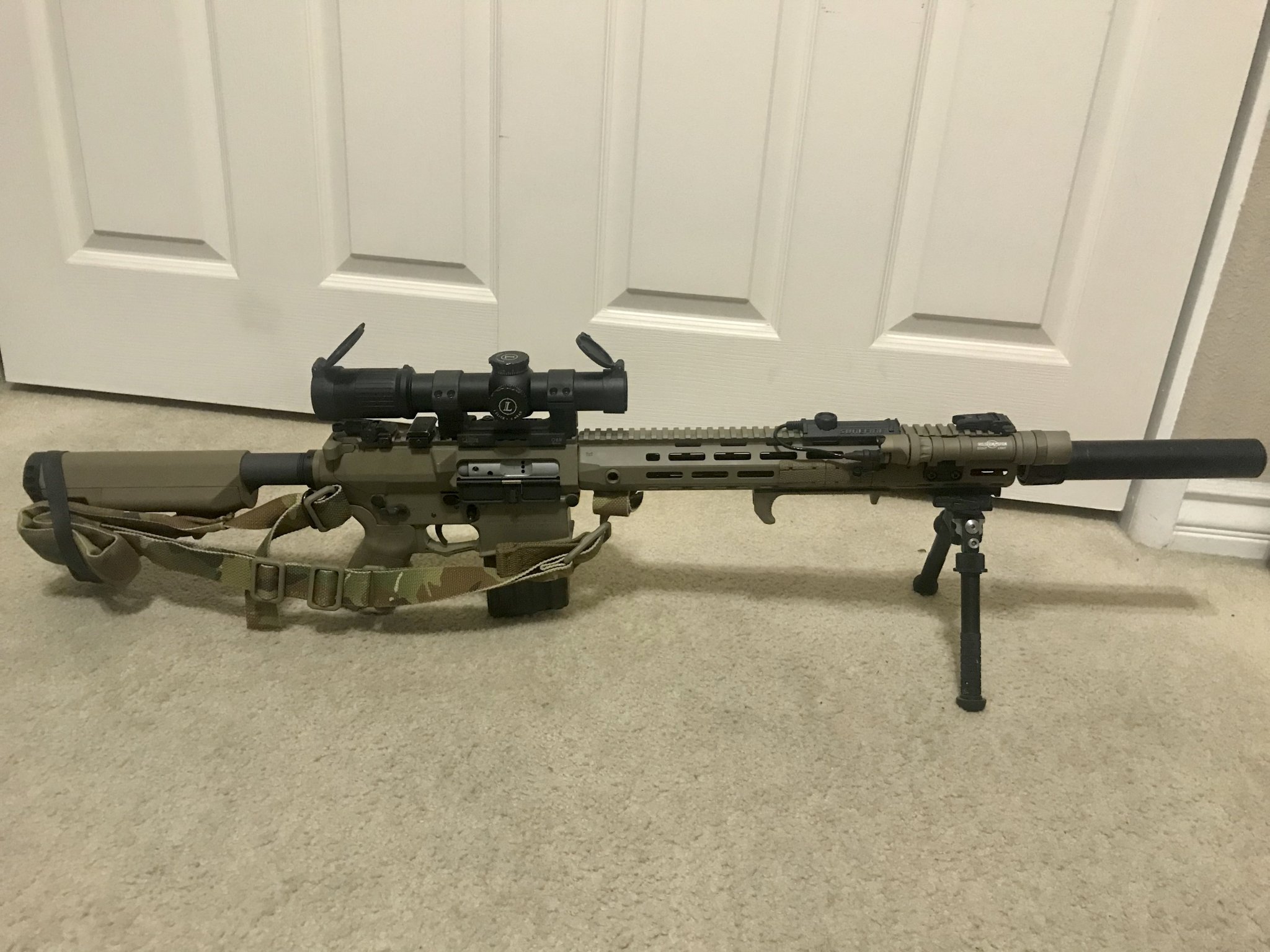

I really like the ACC. It’s one of the shot show 2019 limited edition versions in FDE. Have a Mark 6 1-6x24 CMR-W reticle and it’s spot on insofar as the holds I’m 50 yard increments out to 700 yards. Felt the same way about the URX4 as you do but it’s definitely grown on me since.

I really like the ACC. It’s one of the shot show 2019 limited edition versions in FDE. Have a Mark 6 1-6x24 CMR-W reticle and it’s spot on insofar as the holds I’m 50 yard increments out to 700 yards. Felt the same way about the URX4 as you do but it’s definitely grown on me since. View attachment 7401384
Very nice set up!

Thanks, man. I really like the rifle. Depending upon what you will use yours for, you could go APC as well. The APC has a heavier profile, stainless 5R barrel that is said to hold .25-.375 more precision than the ACC but it’s about 1.5 lbs heavier overall. The ACC’s 5R bbl is chrome lined.
Otherwise they are identical.
