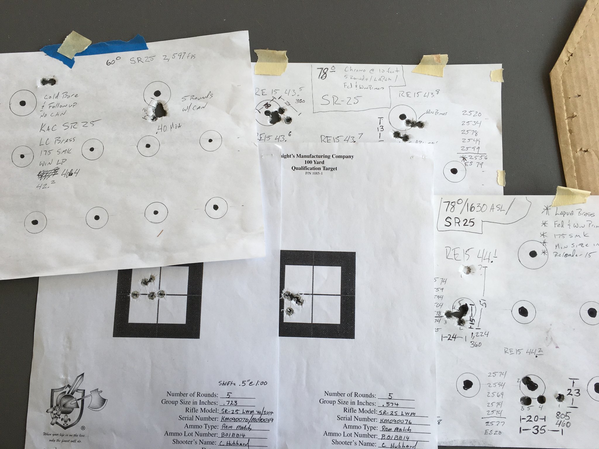

    I had an LWM and now have a PC. I think the PC is @ as accurate but the LWM has a heavier barrel and allows you to hammer away and not have rounds walk due to heat.
    I had an LWM and now have a PC. I think the PC is @ as accurate but the LWM has a heavier barrel and allows you to hammer away and not have rounds walk due to heat.View attachment 7518236
    Mike,
    Can you scooch that right factory target over a little? I want to see your velocity data for that 44.1 Reloder15 load. That was the spec for m118lr back in ‘08. I still like seeing data from that era.
