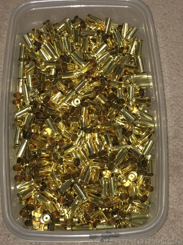

Stainless, I can clean 200 pieces of 260/6.5 creed/6creed size cases in an hour.
Separate the media and lay on a towel.
Clean as new.
A splash of lemon shine and a squirt of dawn dish soap.
