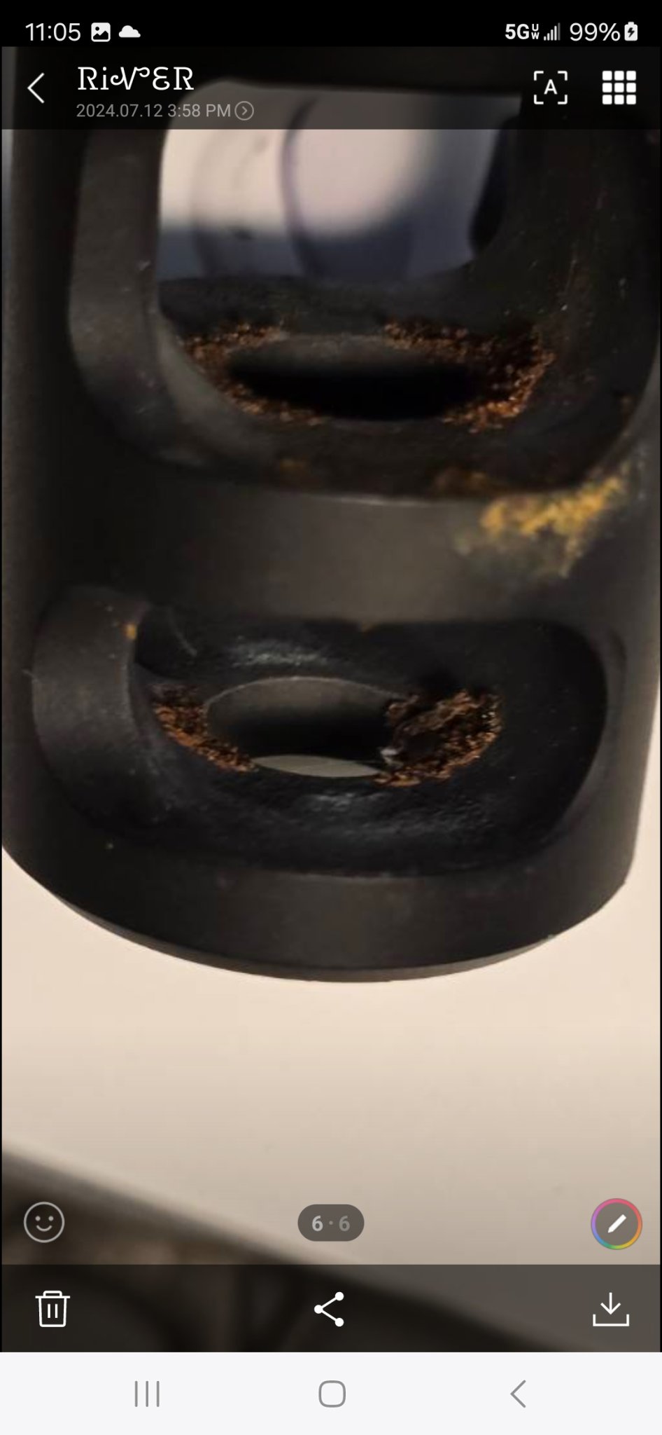

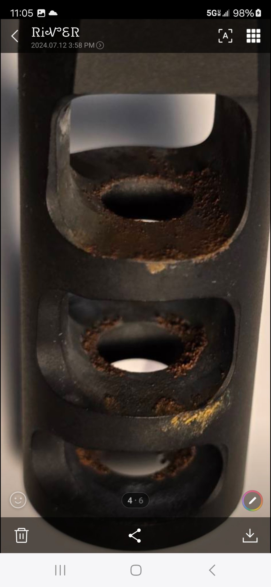

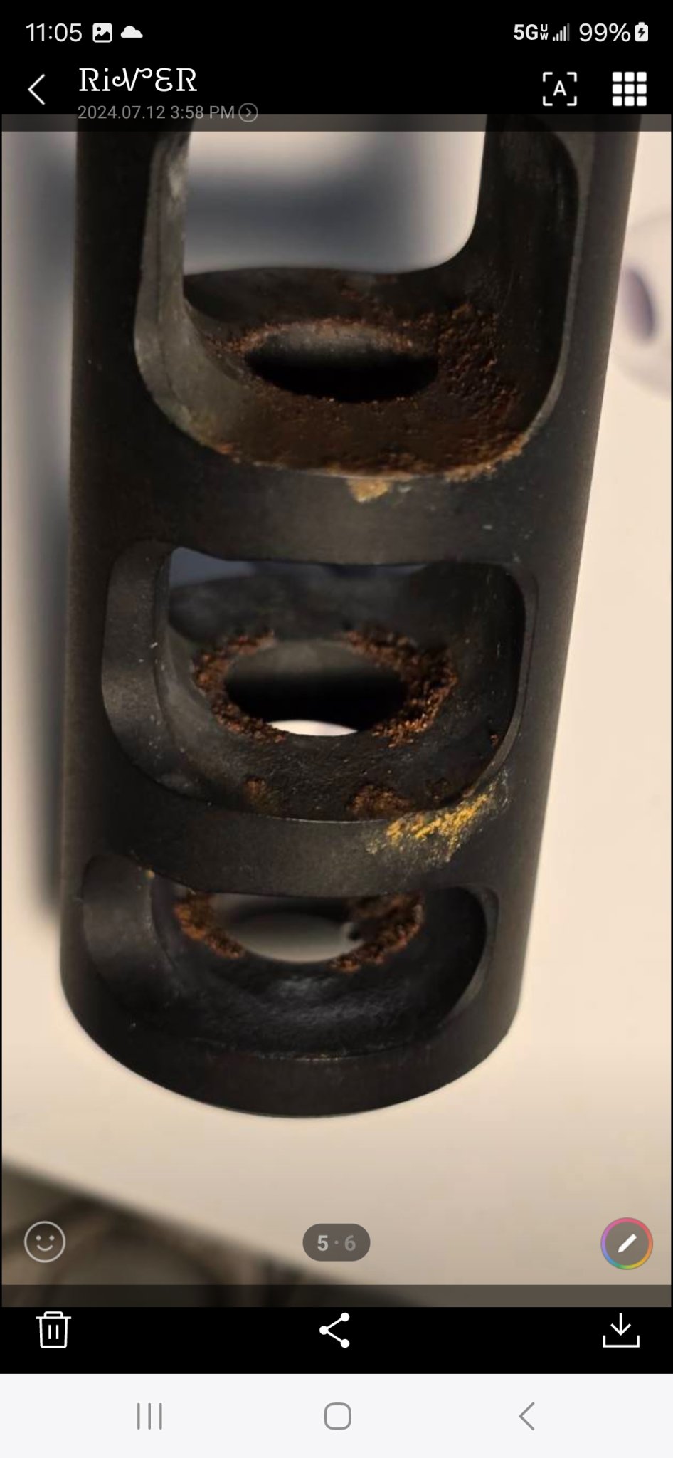

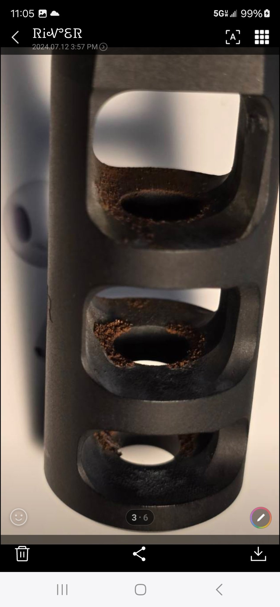

Have any of yall ever seen a SS muzzle break that's been cerakoted start rusting?

It’s cerakoted and SS and the gun is less than a year old. I realize that there are many types of stainLESS and some will rust/stain but my thinking was the cerakote would provide an additional layer of protection and I wouldn’t notice anything for years down the road.
The 3 series varieties of stainless will be the most resilient when it comes to corrosion resistence due to the very low carbon content and higher chromium content.
It also makes them softer and more prone to galling.
A process that I have seen used on Duplex 2205 stainless and 4 series for corrosion resistence is to pickle and passivate for additional corrosion resistence but we still had to use clean latex gloves and clean chromed tools while assembling the parts.
The short answer is yes all SS can rust that I am aware of if not maintained properly.
It looks like it may be some type of chemical reaction.
Chlorides will do that to stainless steel and some cleaning solvents have chlorides in them.
Just a thought.
