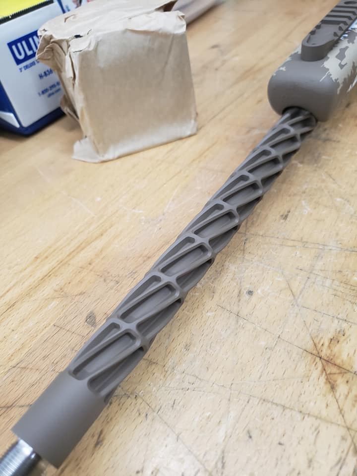

Cool n all, and surely effective in reducing weight, but by the time you buy the blank, have it chambered, threaded etc., and pay the $350 for this fluting alone, have it coated, plus all the shipping fees and time, a carbon fiber option is suddenly the more cost effective and attractive option. I have two SS blanks that I would have already sent if not for the cost. Just can't justify it.
Yeah, because we do this shit to save money! :ROFLMAO: :ROFLMAO:
Seriously, I hear ya.
One barrel in the machine is almost 5 hours of spindle time for "Pattern X". They just take a long time. As the saying goes, "Custom doesn't come in a box." We offer it because we have a demand for it and because it is unique.
Truthfully, I kinda lose my ass on it because we can flute a mess of barrels the conventional way in the time it takes to do one of these.
COOL AINT CHEAP! ;)
Yeah I get it, and I'm glad you have demand. I was just pointing out why I specifically haven't done it, because I have certainly wanted to.
