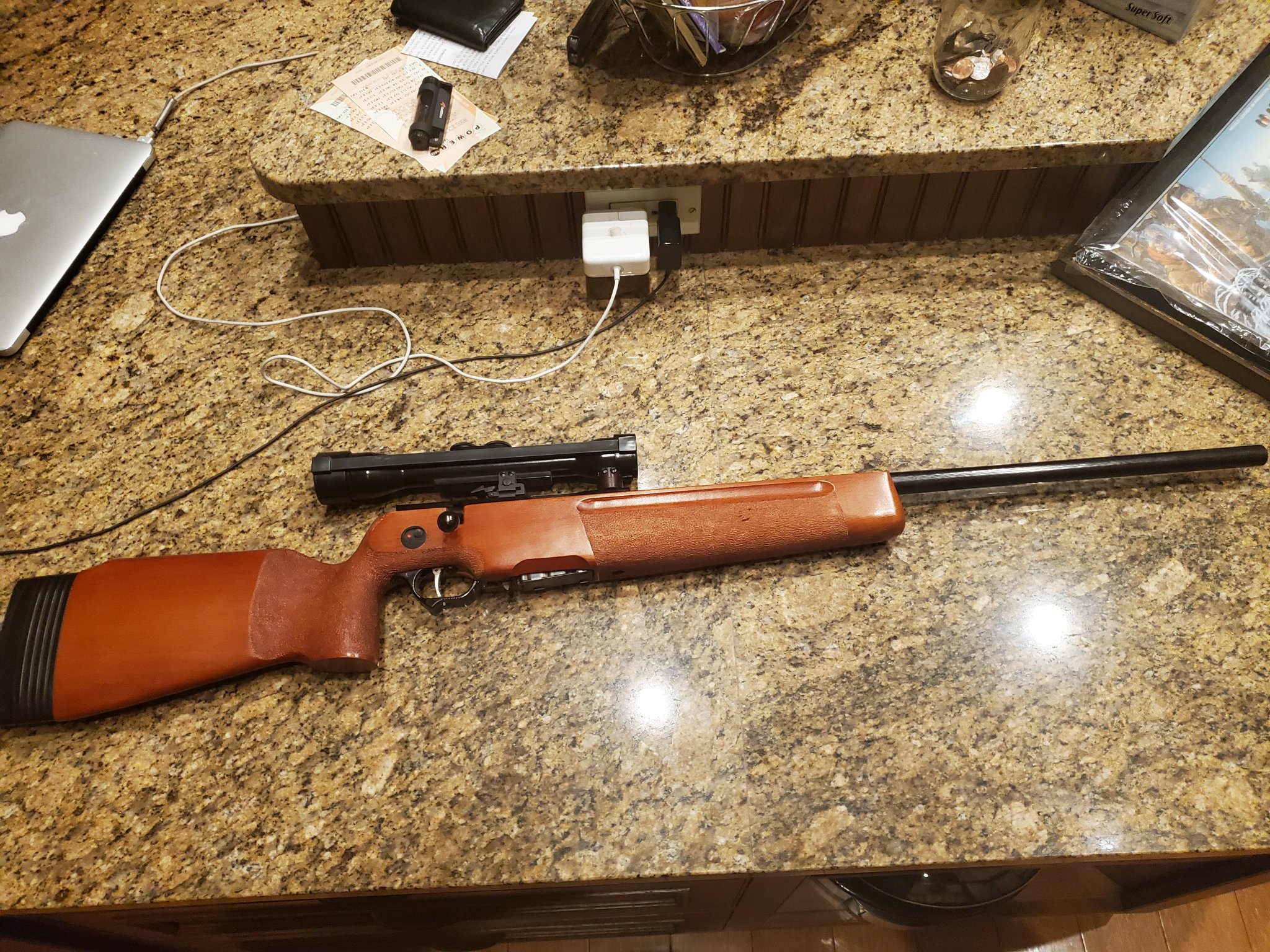

here it is wish I had a better pic
That's a really nice looking rifle. If you do decide to shoot her (I recommend that you do...you will find that they have about the finest trigger you ever laid a finger on) I recommend buying the Suhl 150 round bar trigger that a guy sells on GB as the factory trigger can be on the delicate side as they have been known to break. They tend to be weak where the large screw is and since I haven't seen any original triggers for sale I don't think you would want to break the one you got.
