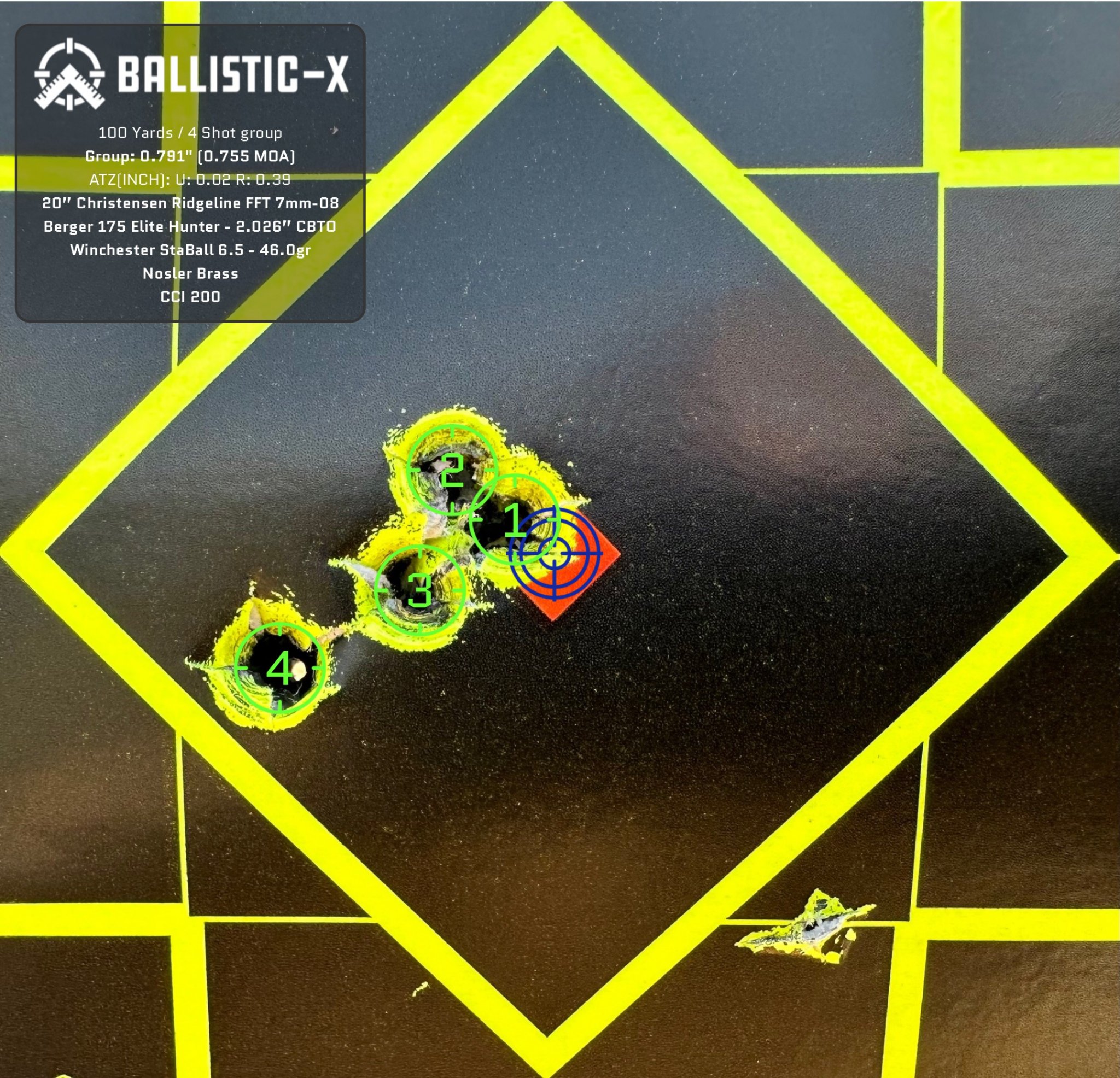

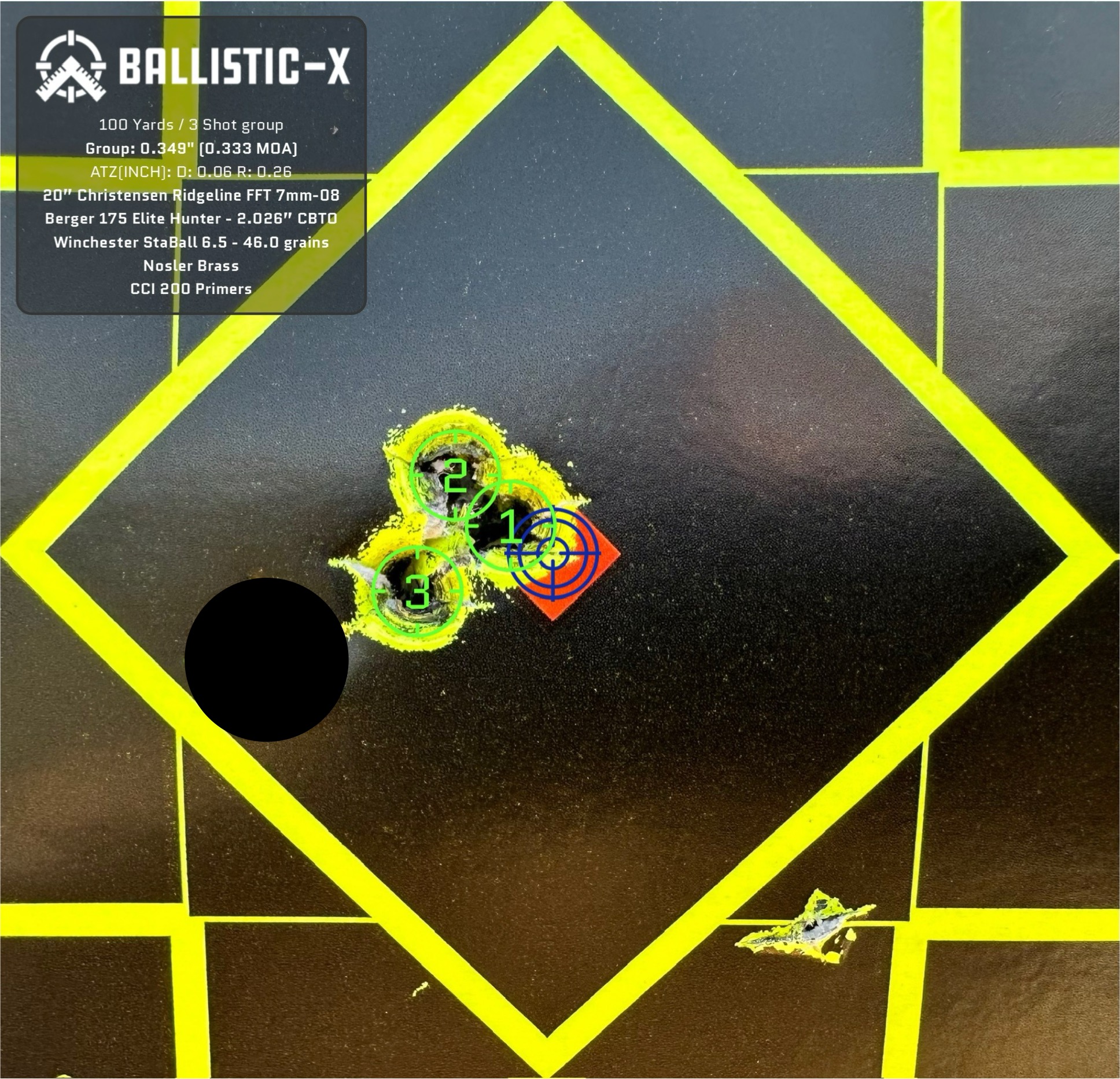

Just finished some load development in my 20" Christensen Ridgeline FFT 7mm-08 and StaBall 6.5 with the Berger 175 Elite Hunters... My best safe load was 46.0 grains and was pushing them 2,614 FPS MV average with a single-digit SD. Pretty happy with it. If it stays stable during the cold weather, I will be using it for hunting season for deer.
Here’s the same group both with, and without, the flier that I pulled…
