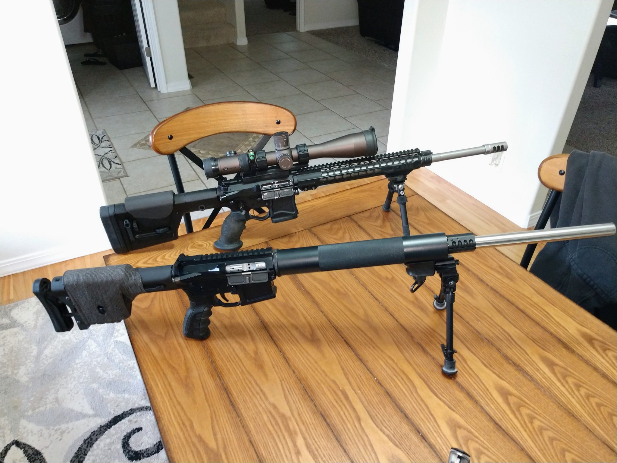

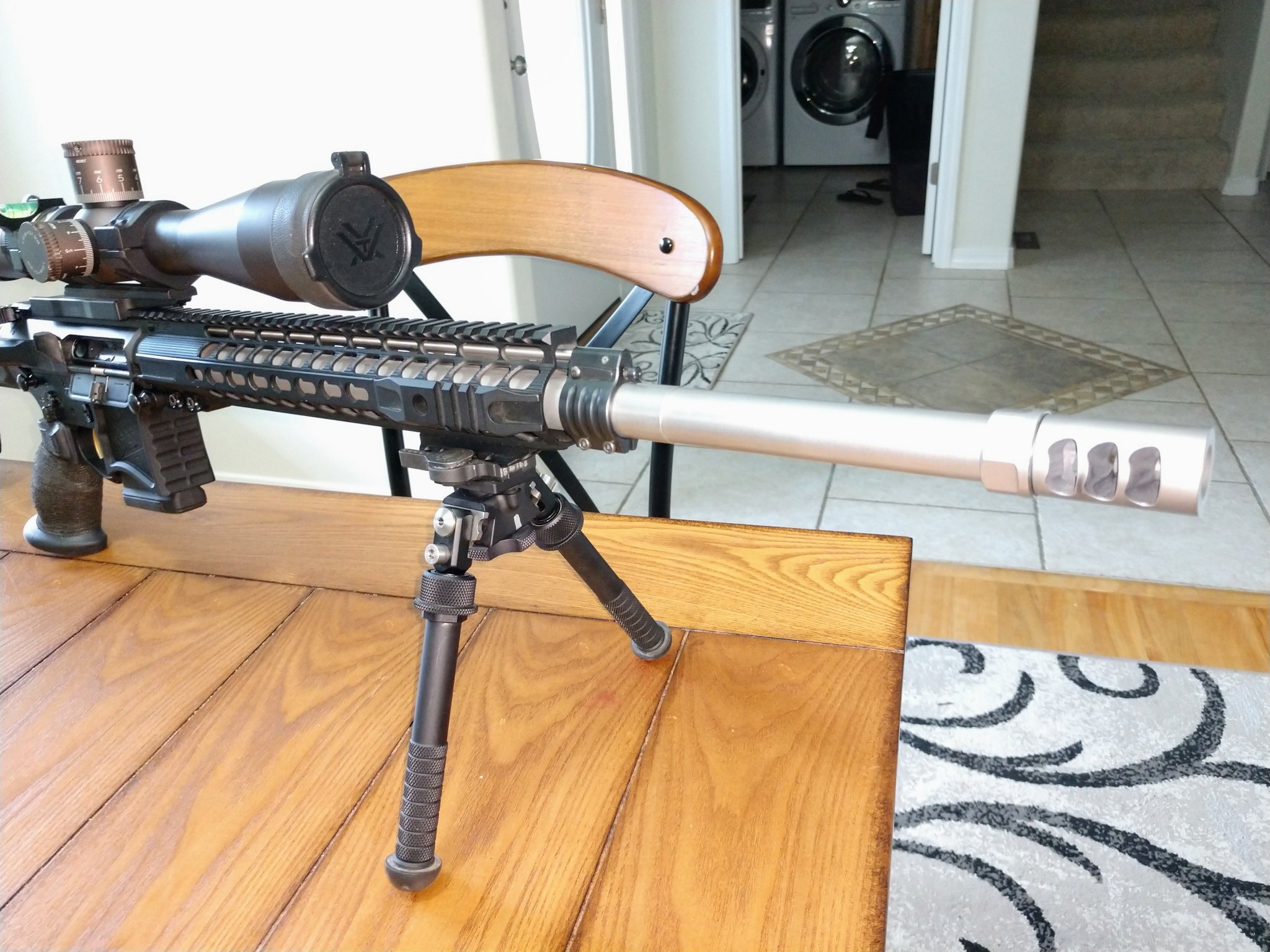

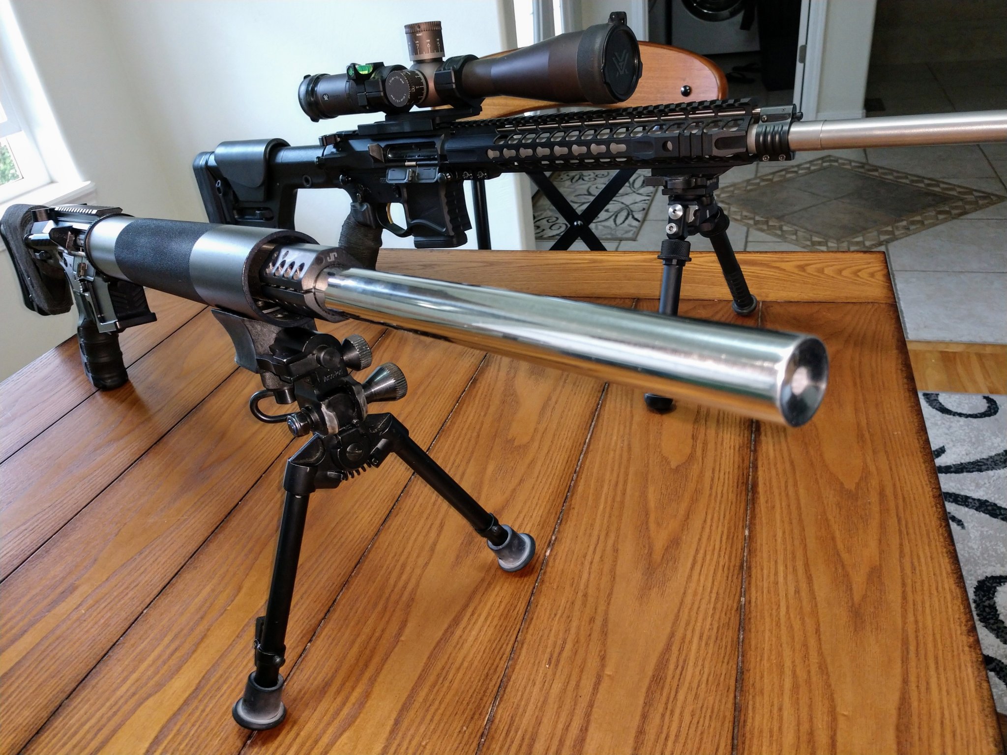

    I had one a few years back, Definitely a good Varmint Rifle. Is this choice dictated because of a tight budget or are you looking for an accurate varmint rifle in general. ??
    I only ask because for a couple hundred more you can go to Compass Lake and get the same style of upper/Rifle but in any length, contour, chamber, twist rate or design you wish.
    And in regards to the weight of the rifle it is a heavy beast just to give you a frame of reference, the scoped rifle you see in the picture is my 20" varmint Rifle with a compass Lake medium varmint profile barrel and even with all of the equipment that's on it, it's still lighter than the 24" Bull Barrel Les Baer 6.5G in front.
