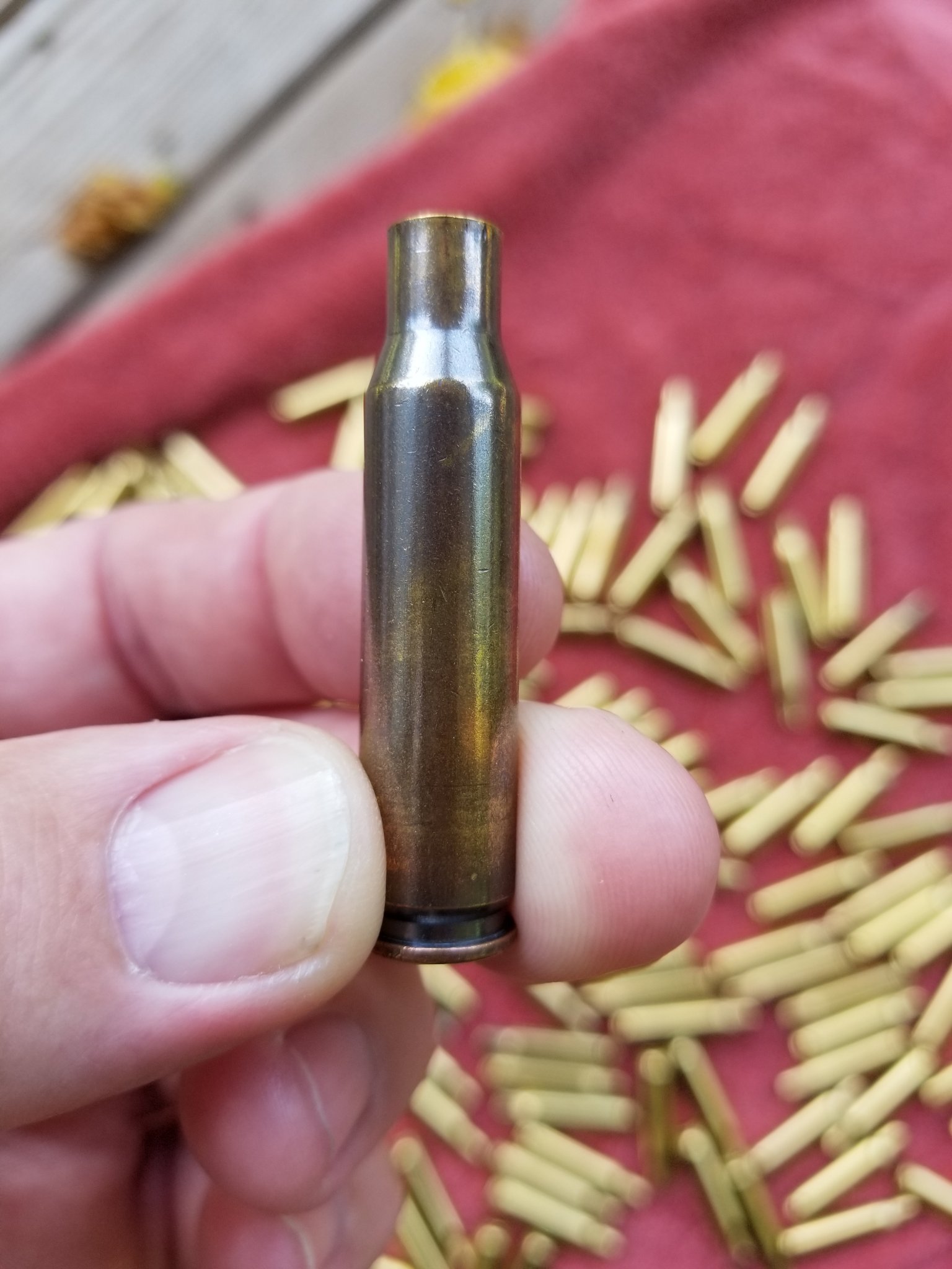

    I use quite a bit of once-fired military brass, and usually have a small number of really dark or discolored cases. They aren't pitted and they look structurally sound, no corrosion. would you use them, or toss them?

    One thing I forgot to mention in the op. The pictured case had been wet tumbled. It came out looking almost like it had been color case hardened. It was very smooth, but stained.

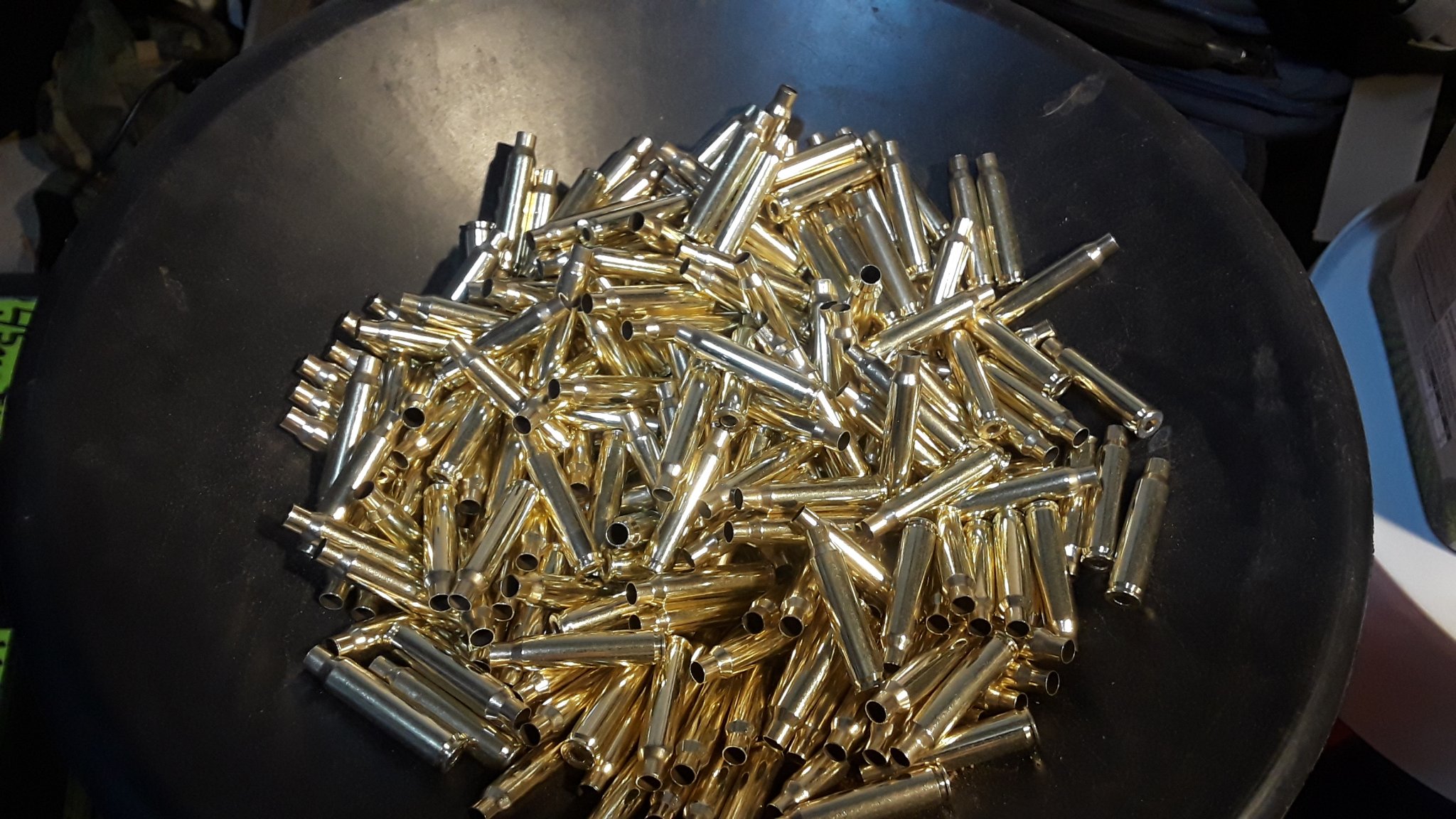

    Fortunately, it's only a few that still look like that after the wet tumble. Most come out looking brand new. Since there are so few like the pictured one, I may just use them for setting up the annealer, then toss them in the junk brass bucket, or test the new cleaning concentrate I found.

    That's very close to what I do, including the use of that hot of water, though I fill my tumbler (only slightly larger capacity than your 15lb'er) pretty full, like to about 4/5ths . With such hot water, it takes me less than 1 hr to really get range brass clean. Since you're only going half full, your concentration of Lemi Shine is quite a bit more than my solution, and I do have very soft water, so that small amount of Dawn goes a long ways. If you don't have soft water, the solution you're putting together seems to me to be a little light . . . even when only filling to half full.
    The only thing I can think of that might be giving you results like this is that those particular cases have a little different alloy mix that's reacting to the Lemi Shine in hot water for such a long cycle period. The hot water tends to shorten the time one needs to tumble as it makes the chemical reaction more intense on the brass. You might try cooler water and/or a shorter tumbling time and see what you get???
    There shouldn't be any good reason you can't use those discolored cases. I'd probably use them to identify a different load from another. Or as mentioned, just use them for setting up the annealer.
