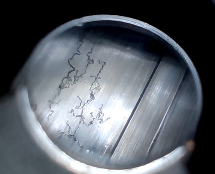

Stainless 308 Barrel from one of the big three makers. Has 279 rounds on it.
Found a bunch of this with the bore scope.
Rust? Pitting? Or something else?
Should I worry or just shoot it?
Cleaning does not much to remove it.

If you have an air compressor, blow some moderately high pressure air down the bore, then scope it. I cannot say for sure, but that could just be fuzz from cleaning patches. When I first received/started using my borescope, I did have that same issue after cleaning/patching. I didn't realize that I was looking at fuzz, thinking there were problems with the barrel, when indeed there were not.
I bought the Teslong scope that plugs into my MacBook. While I don't necessarily regret it, I am now in the camp of those that think borescopes can cause more problems than they are worth, due to people not correctly interpreting what they are seeing (in the beginning, myself included). I'm going to keep the scope, but it's not going to see a bunch of use.
It's probably pretty hard to buy a bad barrel from any name brand manufacturer these days. Doesn't mean that every once in a while someone might not receive a turd, but pretty damned unlikely. Stick with a name brand manufacturer, shoot it/work up/refine your loads, don't go off into the weeds with the borescope and you should be just fine.
There are a lot of guys that either say "just shoot it", or "how does it shoot ?". They're not wrong.
IMO
Barrel is made to shoot.
Do that.
If barrel does not shoot well, replace it.
When you clean, do not leave solvent any longer than is needed to remove what ever you think you needed to remove.
Get the solvent out, neutralize it, finish with an oiled patch and dry patches.
Some like to finish with a lightly oiled patch, and have done this (still do it) with CrMo barrels in wet/humid shit.
Oil/grease seems to attract crud.
If you never go shoot, you won't need to worry about that anyway.
Suggest selling borescope to someone that thinks they need it.

I’ve had that on a few of my shilens.
I’ve read it’s corrosion from leaving a barrel dirty with carbon for extended period in moderately humid conditions.
Both barrels shot excellent with normal round count lives.

I've seen that before. A friend's barrel had a few patches of that and we're not really sure what happened to cause it but our leading suspicion is that we shot in a really humid place, he put the rifle in the case, and left it there for like 5 weeks before taking it out. Nothing else got rusty but he had bore scoped it when it was fairly new and it didn't have the termite marks before. His rifle still shot well.
Reactions: barnaby
It does look like solvent residue/ stain.

Reubenski, am not a "hater" and have logged plenty of time using borescopes.
When the user discovers that his barrel has a case of clap, there's no cure, the damage is done.
Choices are to either shoot until it actually needs replacing, or replace the "damaged" barrel and shoot until it needs replacing.
Prior to buying, if you can check a barrel great, do it.
At a minimum, checking with a good borelight (as others have pointed out) is a good idea.
Sidenote. Consider all the responses from the borescope haters to be ignorant misinformation. Since they don't use a borescope and have never seen the inside of a barrel.
Or some of us look at hundreds of barrels a year with a bore scope and understand what may look a bit sketchy under high magnification, and a potentially distorted view, very well could be completely insignificant on target.

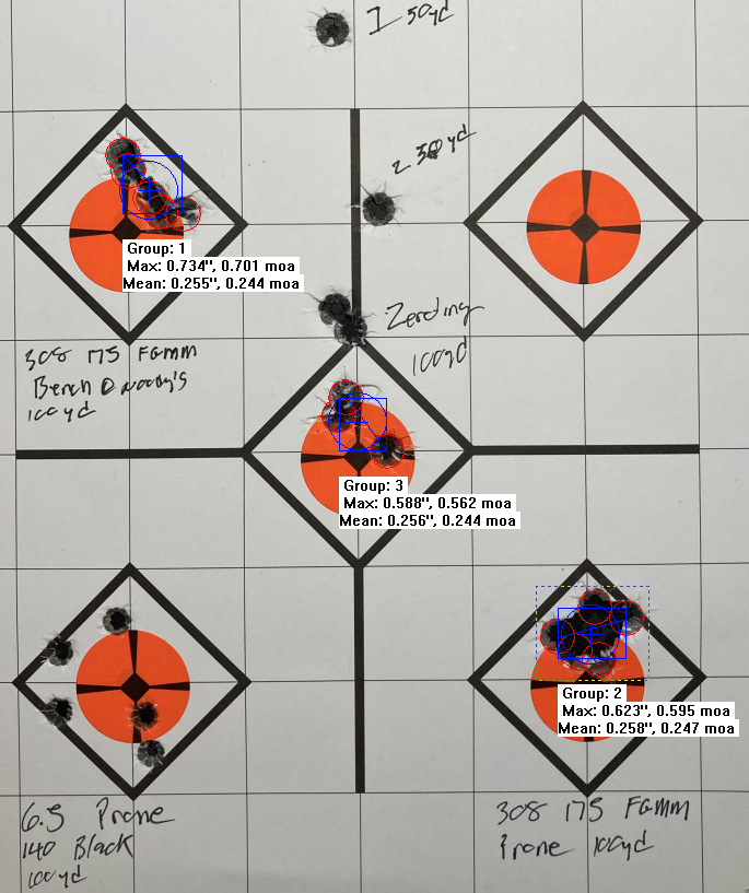

Shoots better than I can from the first 17rd of 175 FGMM since I had the rifle bedded to it's new stock.
Had about a 10 to 15 MPH Gusty headwind as well.
