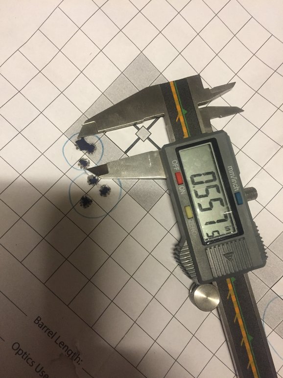

photo72412.jpg Is there a standard procedure for measuring your groups? Just throw some calipers on the widest point and call it good?
That's sweet that you get to subtract the bullet diameter. I've been trying to shoot sub 1/2 moa for a while now, all along I have been and didn't know it. The group above would be .333 moa then.
Thanks
There ya go, hang around the "hide" and you'll learn all kinds of stuff lol!
Measure the widest point of the group, then subtract the bullet diameter, i.e. .224 for a 22 cal.
Slight clarification to this approach.... rather than just subtracting bullet diameter, measure the diameter of a hole left by a single bullet passing through your target and subtract that amount. You may find that the mark is not the same size as the bullet diameter, depending on the type of target used. Measure both the single hole and the edge of your group in the same way and you'll have a more accurate result.

Slight clarification to this approach.... rather than just subtracting bullet diameter, measure the diameter of a hole left by a single bullet passing through your target and subtract that amount. You may find that the mark is not the same size as the bullet diameter, depending on the type of target used. Measure both the single hole and the edge of your group in the same way and you'll have a more accurate result.[/I]
I believe this is how the benchrest folks do it, and it works well.
For me, I've come to realize that at most I care about the tenths of inches. 1.0XX inches vs .7XX inches vs .4XX inches and so on, so I don't worry about it much and just eyeball the calipers to the center of the outside bullet holes. If I'm recording data, it'll just say "6's for 10", "3's for 5" or similar.
Yeah, me too. It's not that hard to put the point of the caliper in the center of the two outside holes. Only time I use the subtract bullet hole diameter approach is when trying to get an exact number.
Agree with Sheldon, if youre gonna be precise, the hole in the paper is the way. Any consistent point you can measure off of works. I zero my caliper on a single hole, and then measure outside to outside of the group. Caliper reading will be the center to center measurement.
If it's a one hole group I measure outside to outside and subtract the bullet diameter.
At distance, when holes are usually spaced apart, meansure the inside edge to outside edge of the two farthest holes. No need for math that way.
