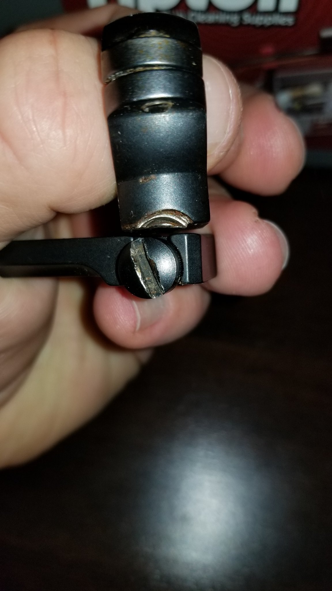

Testing some loads out today,groups were large ,check things and my scope wiggled like jello . Standard Leupold rings ,seams the bases are solid,but where the front ring cams into the base is where there was significant movement. . So I have some Burris Tactical rings,but they need picatinny rail . So what is the fix ? This is a WBY Accumark . What mounts and rings are guys mounting scopes 338 Lupua mag rifles ?
The Leupold "windage adjustable" couldn't handle my .300 Wby Mag either. First 20 or so shots were good, they things groups started opening up. It was torqued to specs to. The dovetail on the front gave just enough under recoil to cause metal fatigue and bending on the back. Switched to Warne steel Weaver style. Thinking they'll be better.
The Leupold "windage adjustable" couldn't handle my .300 Wby Mag either. First 20 or so shots were good, they things groups started opening up. It was torqued to specs to. The dovetail on the front gave just enough under recoil to cause metal fatigue and bending on the back. Switched to Warne steel Weaver style. Thinking they'll be better.View attachment 7011540View attachment 7011538View attachment 7011540
Those are the worst scope rings ever made IMO I can't believe they still make those POS rings. If I had a rifle to where the front and rear holes were so misaligned I needed adjustable rings to compensate for it well I would either get the rifle fixed, make a custom picatinny rail for it or get rid of the rifle.
