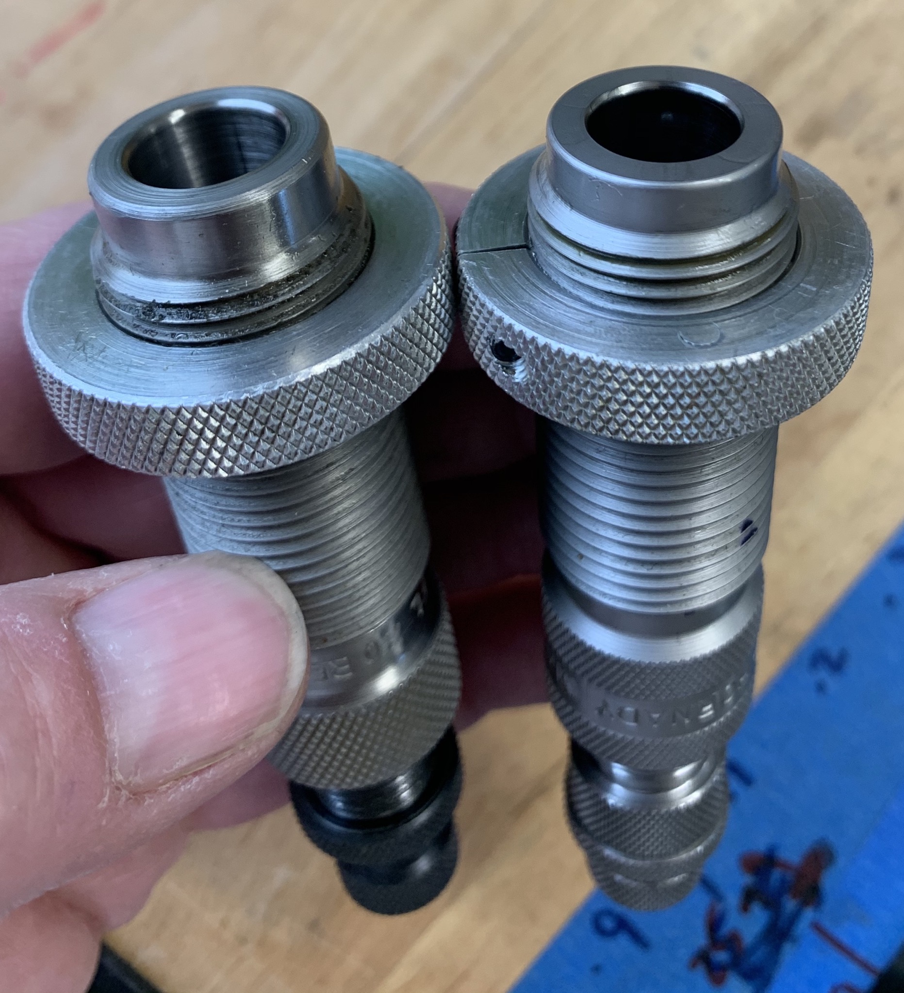

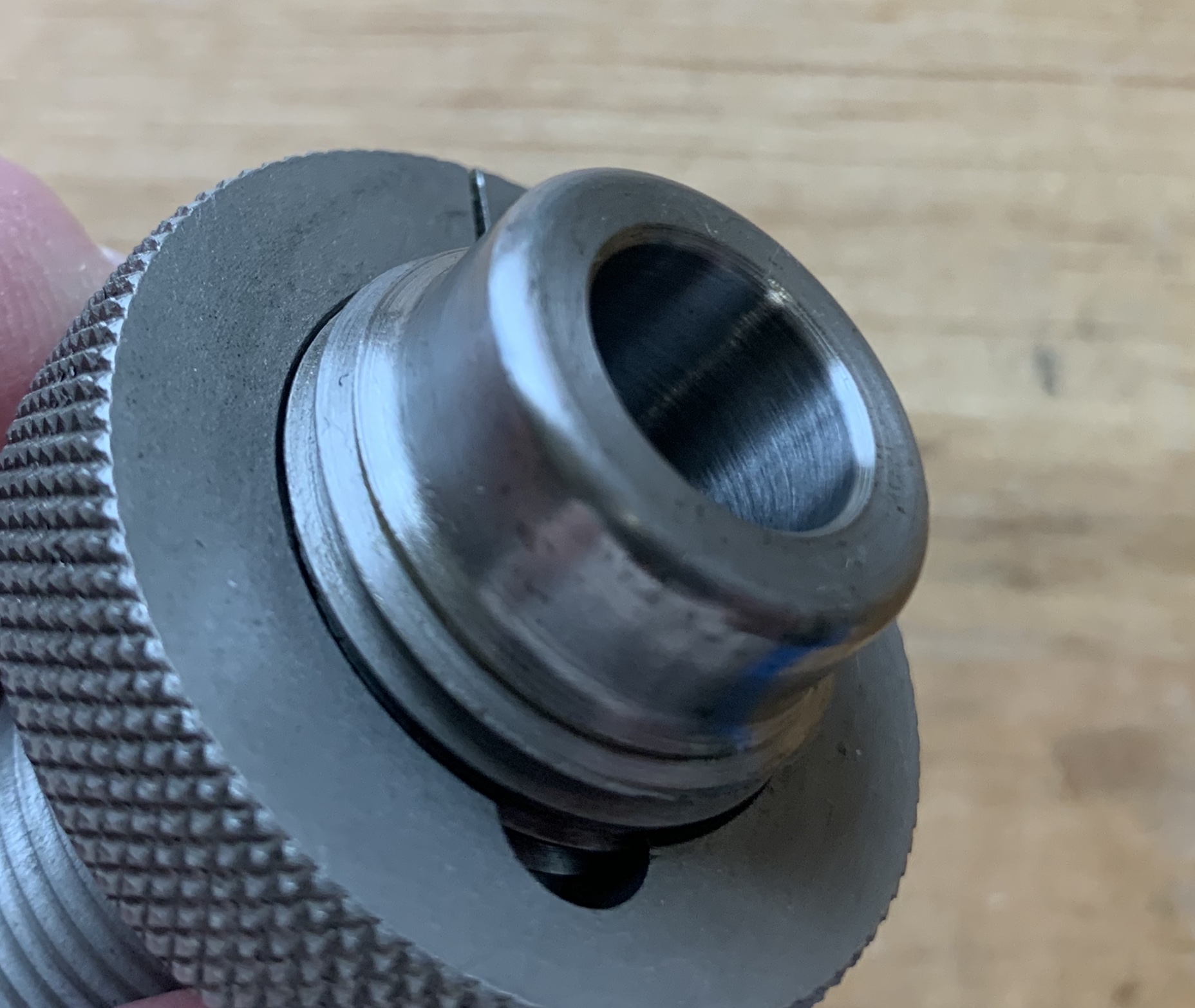

Regular old hornady match die. Just about half the price of the Redding, and better quality. Way way better internal finish, much lower effort to fl size, and not picky about lube. Takes standard Redding/Wilson bushings. I prefer the Wilson. Excellent expander design too.
Notice how the light doesn’t reflect out of the hornady die. It’s because the finish is so fine. Unlike the Redding. Ive taken castings of both of these 6.5 cm dies. They’re dimensioned identically. I can FL size and shoulder bump a fired 6.5cm case with one finger using the hornady. Not even close with the Redding.
Every single element of the Redding is shittier than the hornady. Look at the surface finish of the end of the die. The Redding also has a garbage decap/expander rod design.

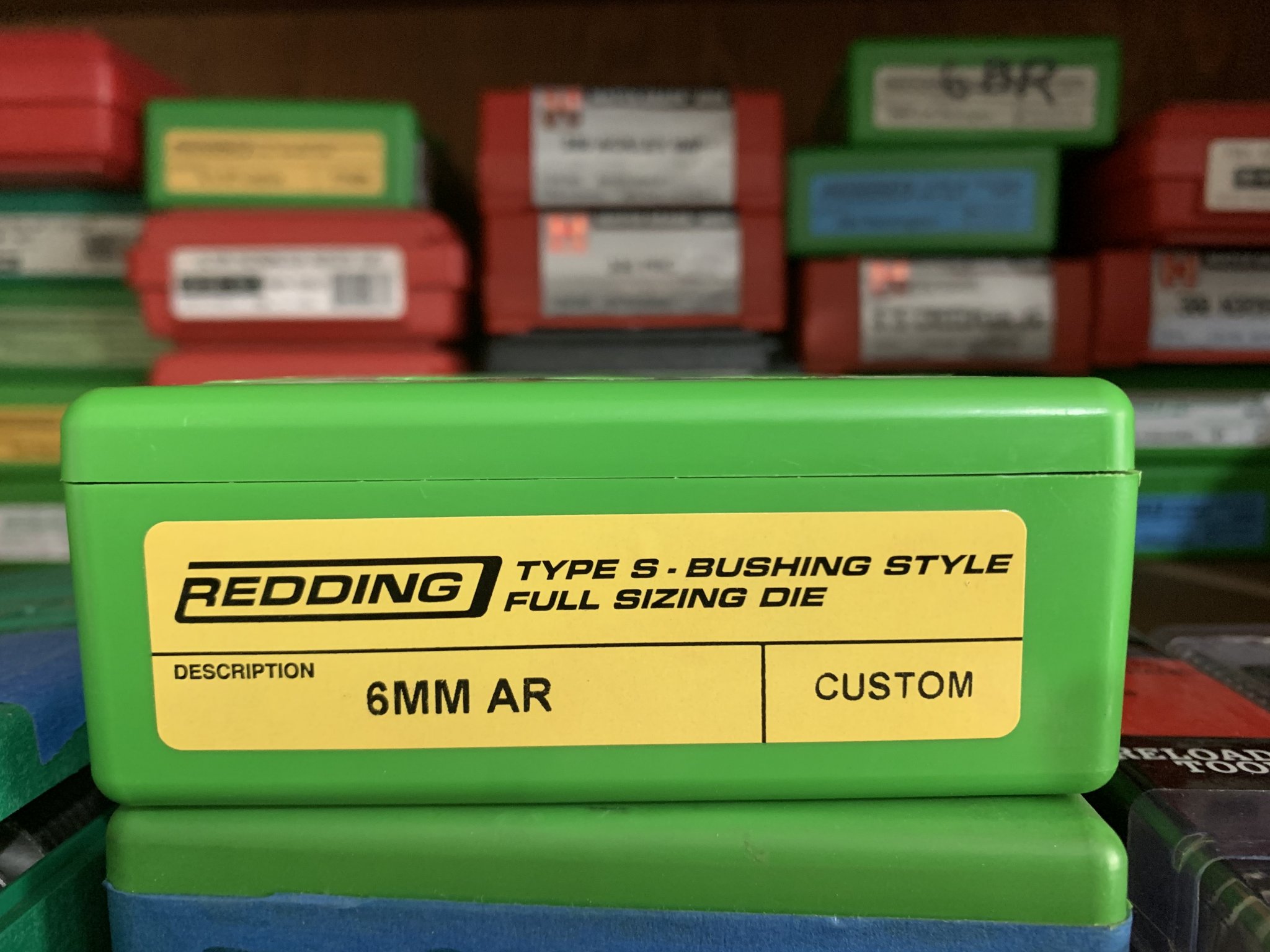

Here’s a $210 6mmAR custom die.
Same garbage finish inside. They all look like this.
