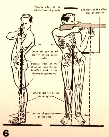

    Standing offhand stance depends upon weather or not you can use a sling for support as they differ in how the rifle is held by the front arm. I'm over 6' and on the thinner side as well so this may apply to you.
    1) NO SLING ALLOWED: NRA silhouette and CMP rules for standing rimfire and highpower do not allow the use of a sling, and in at least silhouette you cannot use the magazine for support either as illustrated in Hlee's excellent previous post #4. I shoot rimfire and highpower silhouette and my pose is pretty much a copy of that picture except I have my elbow higher on the hip and use spread fingertips across the stock in front of the magwell and a thumb on trigger guard to hold the front of the rifle. Center of gravity for my rifles is pretty close to the front of the magwell. Fingers do get tired if held for 15+ seconds, and for me that happens about every 5th shot or so. I just go back to rest and then start over to rebuild my stance otherwise wobble becomes too much from finger fatigue. I dont think NRL cares if you use the mag for support or not. The guys that cannot use the hip as support (differing body mechanics) pull their front arm towards their front side basically resting it on their chest pectoral muscles. This uses more muscle as opposed to joint locking but we have guys shooting AAA and master using this technique so it can work too. You have to find out which one works for you.
    Notice in that pic that elbow is up high at 90 degrees as that sets up a pocket in your shoulder socket for the rifle butt to fit into, varies from person to person but it is there. Also notice how high up the stock is, just the bottom of the butt is in the shoulder pocket. This definitely differs from bench or prone on how much surface area the stock has touching your body. You'd think that you'd get a pretty good bruise from that little area being the only contact point for recoil, but truth is I get very little bruising in standing position, I get a lot more from the bench position or shooting shotguns. 2 big tips that helped me a lot in silhouette was getting a stock or stock pad with a proper cheek weld, that sets up the 2nd tip of only moving your head forward and down when sighting down the scope as opposed to cocking it over the side of the stock---you cock your head sideways over the stock and it screws with your center of balance and stability suffers. Took me almost 3 years to put that into effective practice even though lots of experienced ppl told me about it.
    Footwork: you change windage of your stance by planting your front foot and pivoting on it by moving rear foot left and right to change natural point of aim. Elevation changes by bring feet closer together to lower NPOA or spreading further apart to raise NPOA. I start by having my feet shoulder width apart and body bladed 80-90 degrees to target and adjust to suit.
