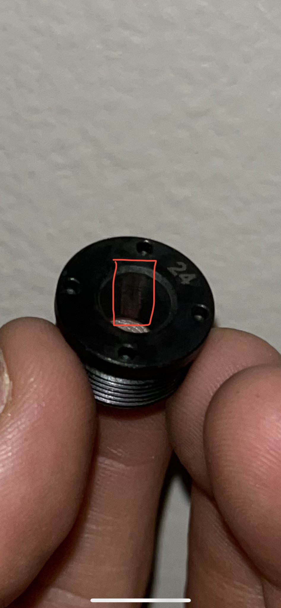

+1 to the recommendation to check for strikes. Here’s a photo of what my root cause was when I was observing the same problem:
