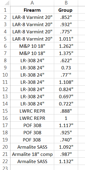

I was able to review my data I have collected from previous customers rifles(I am the shooter in all of these) and from my own personal collection. I am only including AR10's in 308 that are in a factory configuration. I generally shoot 2 5 shot groups for function testing when possible and average the groups. These were all shot with a NXS optic and factory federal GMM 175. Again these were all mostly stock rifles. No new barrels or triggers were installed on any of these ones before the groups were fired take it for what its worth.
Nice shooting!!! It's nice to see The M&P 10 hanging right in there with other brands. When Nutnfancy tested his with Hornady 168's he had some small groups. I'll be testing mine with both 168 Hornady Zmax and GMM. I'm going down the 185 Juggernaut rabbit hole so to speak here soon? We'll see what happens. I'll report back my results soon.
With 168gr A-Max, my factory M&P10 stays 0.5"-1.15" at 100yds with me shooting.
