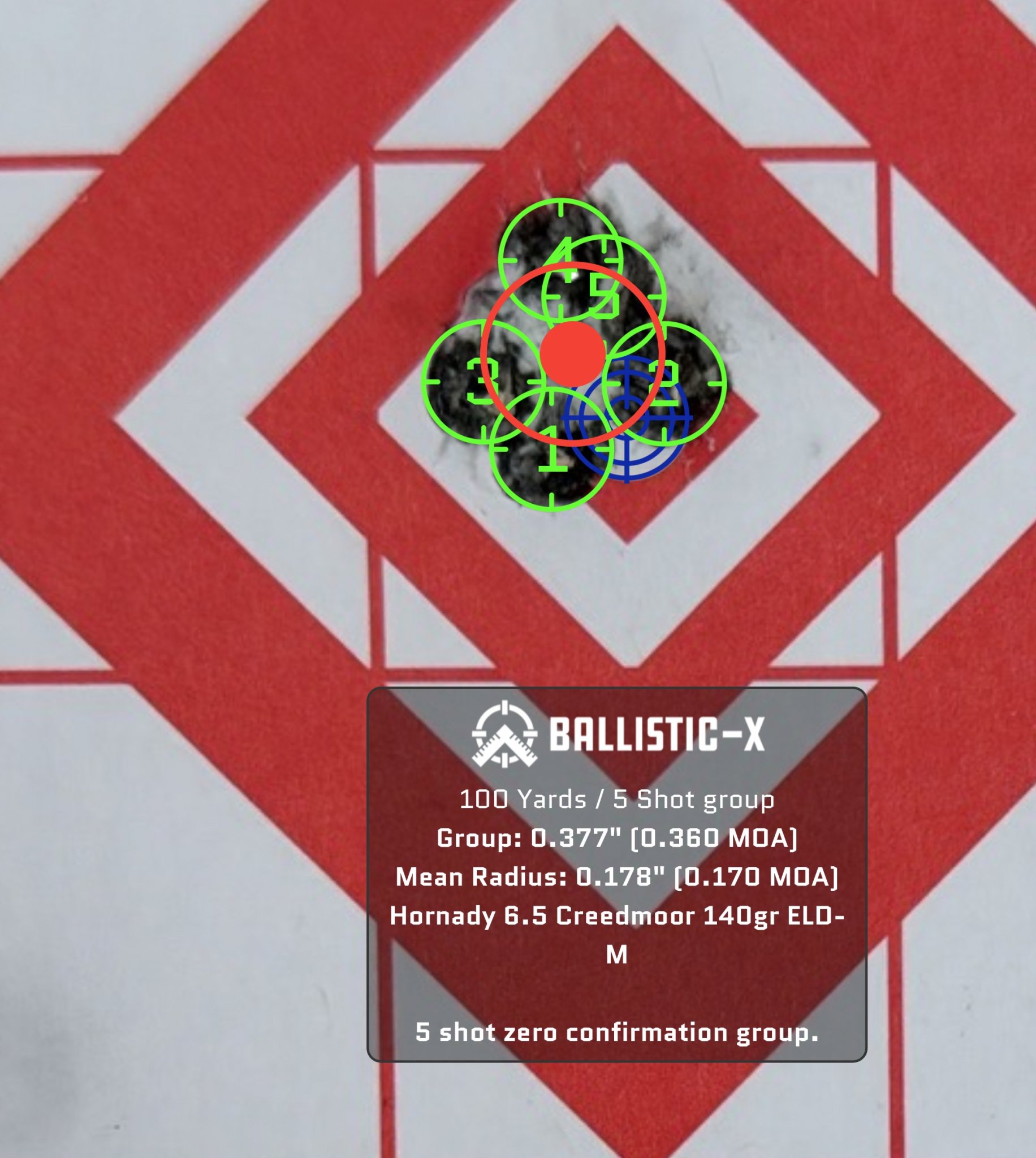

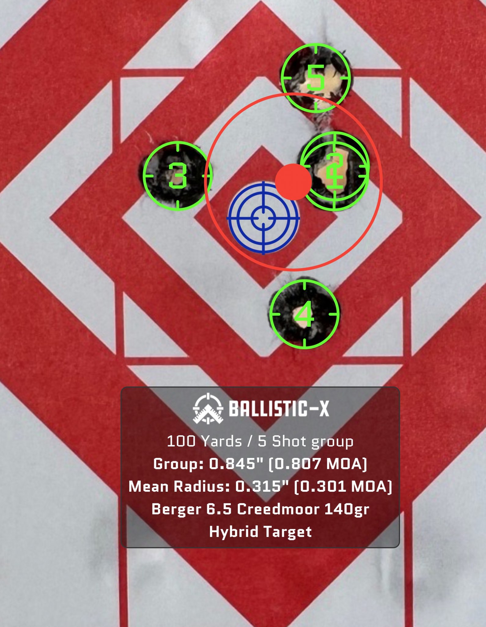

Do you think there is any utility in testing different bullets in factory ammo?
Here's what I mean: I've decided the bullet I have been working up a load with just isn't cutting it, so I am going to move on to testing other projectiles. Should I buy a box of bullets like I have before, do a ladder, record velocity and group sizes etc, etc. Or, should I go out and buy a couple different boxes of match ammo (think Hornady match, Federal GM) in a few different weights, then shoot those and pick the best performer to start working up a load with?
I can see good reasoning on both sides, but I was wondering if anyone else does something like this? It would definitely save time, components, and would keep me from having a bunch of bullets I'm not going to use laying around. But it costs money and potentially an extra range trip!

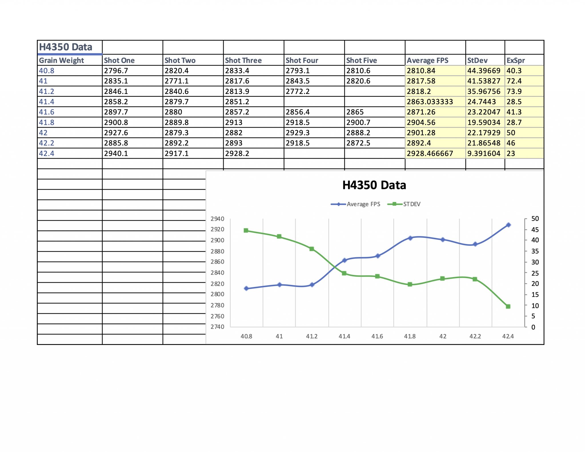

You can't have single digit SD and ES considerably below 20 unless you have an SD of 3.33 or better. So, your sample size is too low to see your actual real ES.

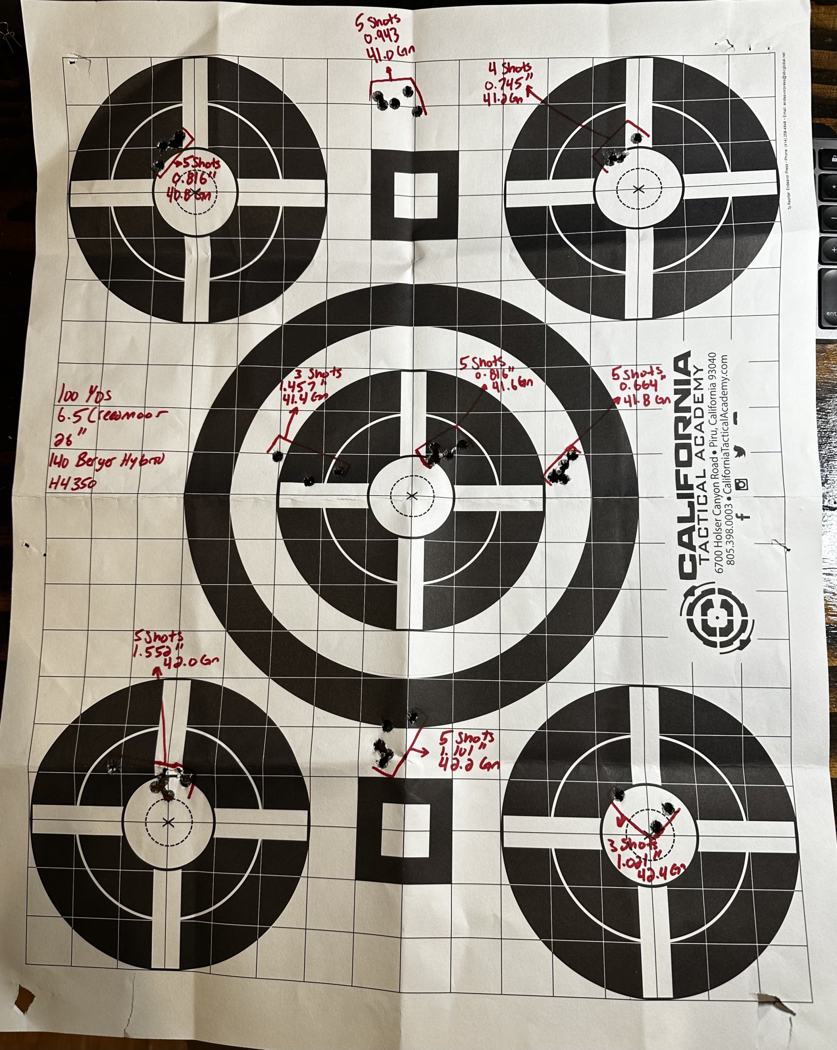

How much seating depth variation have you tried?

Academically I would agree, however I’m just talking about the 3-5 shots per group I shot. I’m sure the actual ES is higher. I’m also comparing numbers from different groups.
I’ve done some seating depth variation, not extensively. I can pull out my notes and see. I just finished shooting a second powder charge ladder at the best seating depth.
Here’s where I am though (and my school of thought might be wrong). I was hoping to have a bullet that shot reasonably well to begin with and then we fine tune. With this particular load I feel like I’m trying to find the needle in the haystack. Most of my ladder groups are up near an inch which I’m just not super stoked on. It’s not so much that I can’t find a good load as much as I see the loads in general being lackluster. With other combinations in other rifles I’ve seen more consistency.

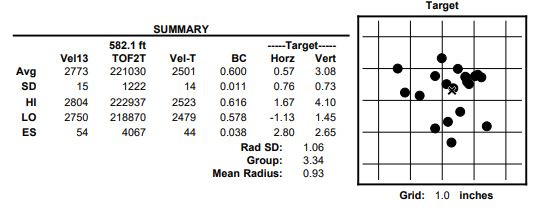

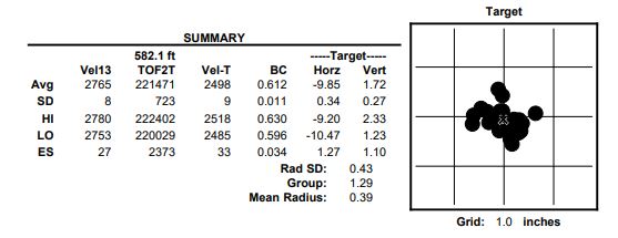

Here's a very crude illustration. Let's say the upper left is 1.5moa and that's how the rifle shoots. For whatever reason, doesn't matter.
All those 3 and 5 shot groups you see to the right were just copy/pasted out of the big group. And they are all groups you may see when you shoot 3 or 5 shots. As they are all included in the dispersion.
So, it may sound counterintuitive that a rifle shooting 1.5moa may quite often, or at least not rarely, produce good groups.

Well here is the data from the range now that I had a chance to get out and shoot the Bergers.
So here's the thing. I used the Eric Cortina "jam method" to find the oal, then I backed off 20 thou from there, and that didn't really work out. Somehow I ended up with some bullets that were off the lands and quite a few that were jammed. So I'm not sure if I was just right on the edge and some were hitting and some weren't. Another possibility is that the tips of the Bergers are hitting the inside of the seating stem on my seating die. So I need to look into that more.
Some of the flyers I was able to predict as soon as I closed the bolt and knew I was smashing the bullet into the lands when none of the others in that group were touching. I think the higher SD and ES than I was running with the last bullet might also be related to that issue. I'm pretty damn confident I didn't pull the flyer in the 42 group. Certainly not that far out.
In any case, I see some promising areas to investigate, and I think it will only get better with the OAL worked out. I'll probably just run with powder at 41.7 and go mess with OAL.
Any thoughts on what I'm seeing here?

For example this is pretty representative of what the Berger 140gr or 144gr will typically do:
Ballistic-X-Export-2024-02-06 16:17:41.272553.jpg
While Hornady 140gr ELD-M produce results like this:
Ballistic-X-Export-2024-02-06 16:28:33.111934.jpg
