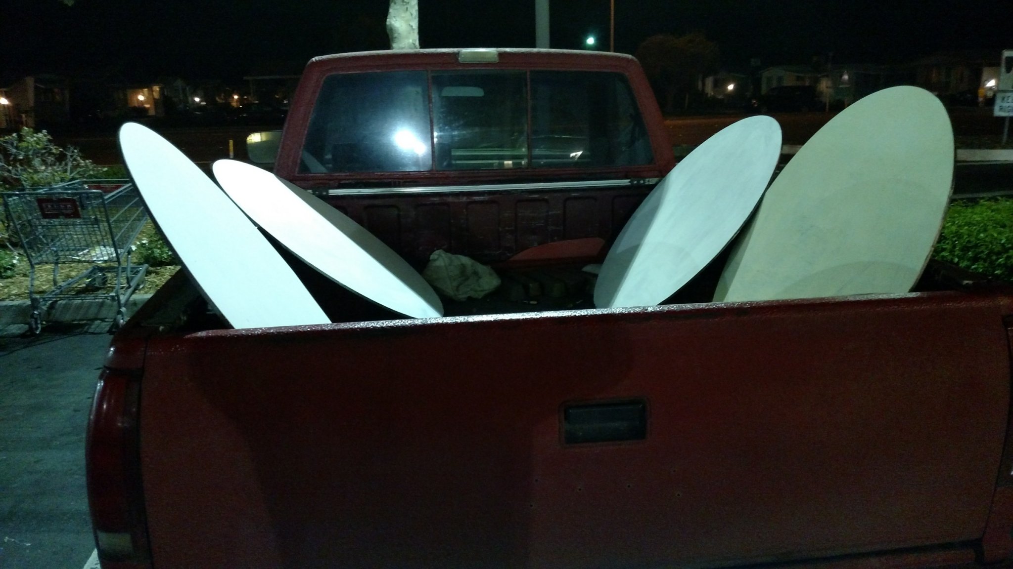

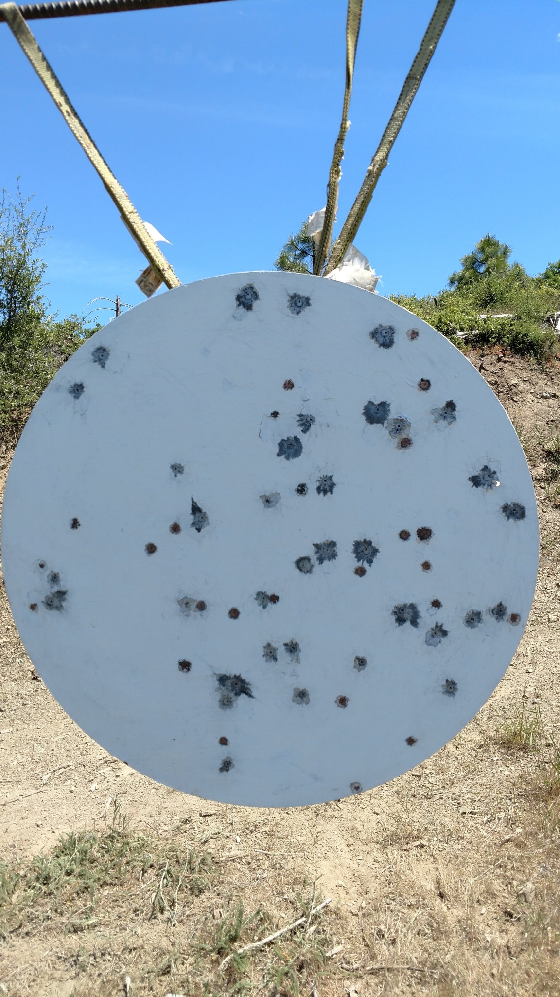

We are using AR500 gongs for our 2000 yard matches about 3/8 inch thick
With over 1000 hits from 6 Dasher to 50BMG we have zero dents or cratering.
The gongs weigh right at 118 pounds each
