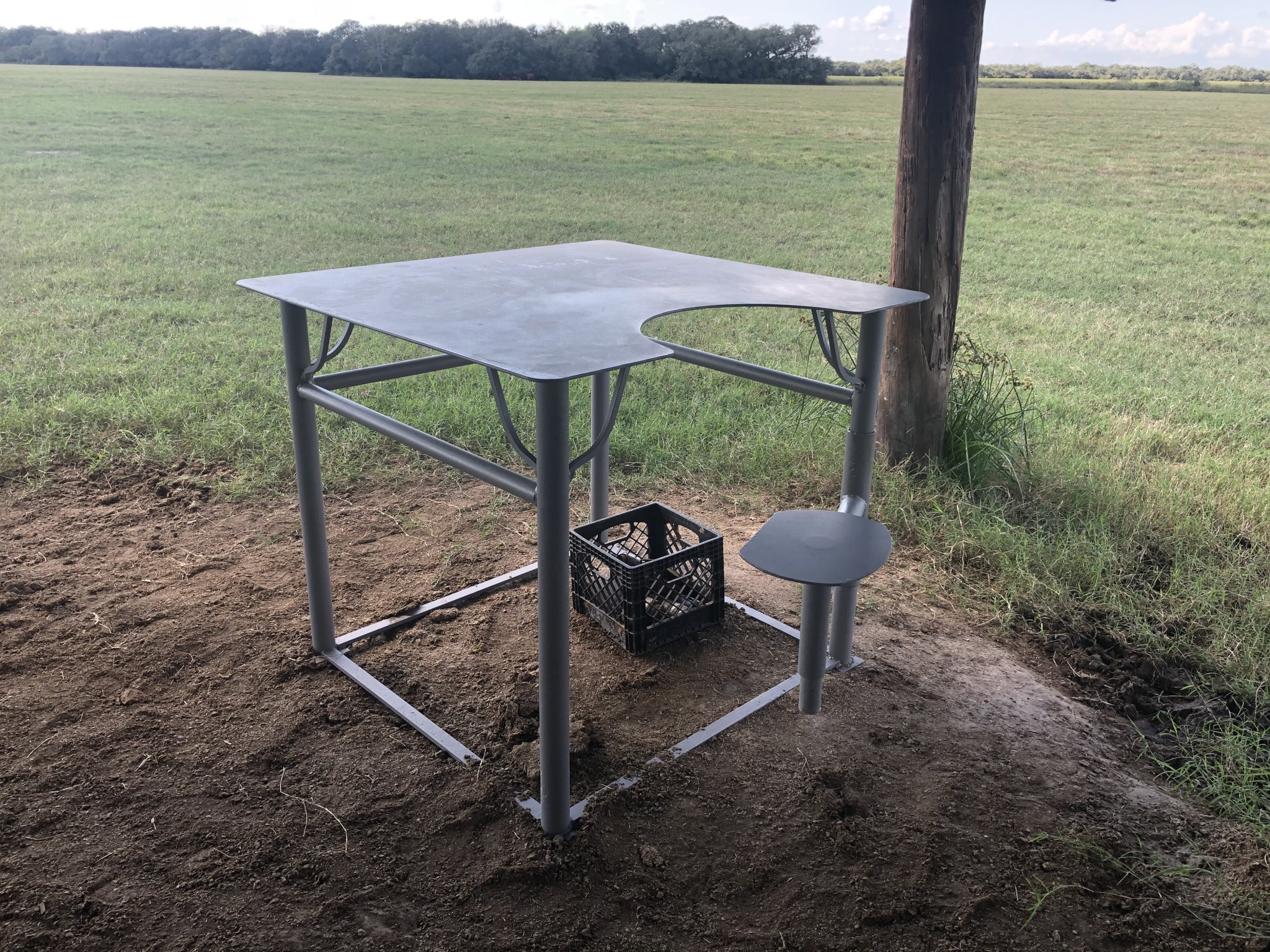

Here is photo of mine that stays put of course. The seat swivels and is pin adjustable for height.
I’m just picking at you anyhow.
That’s pretty neat and nicely made!
I like that style vs the L-shaped ones. Being in the frozen north, I’d make it out of wood or cover it with wood or one would find me dead at -18°F, iced over at the cold-ass life-sucking steel bench haha!
