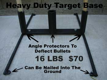

that sniper set up at mrtarget looks great but the base needs more imho
