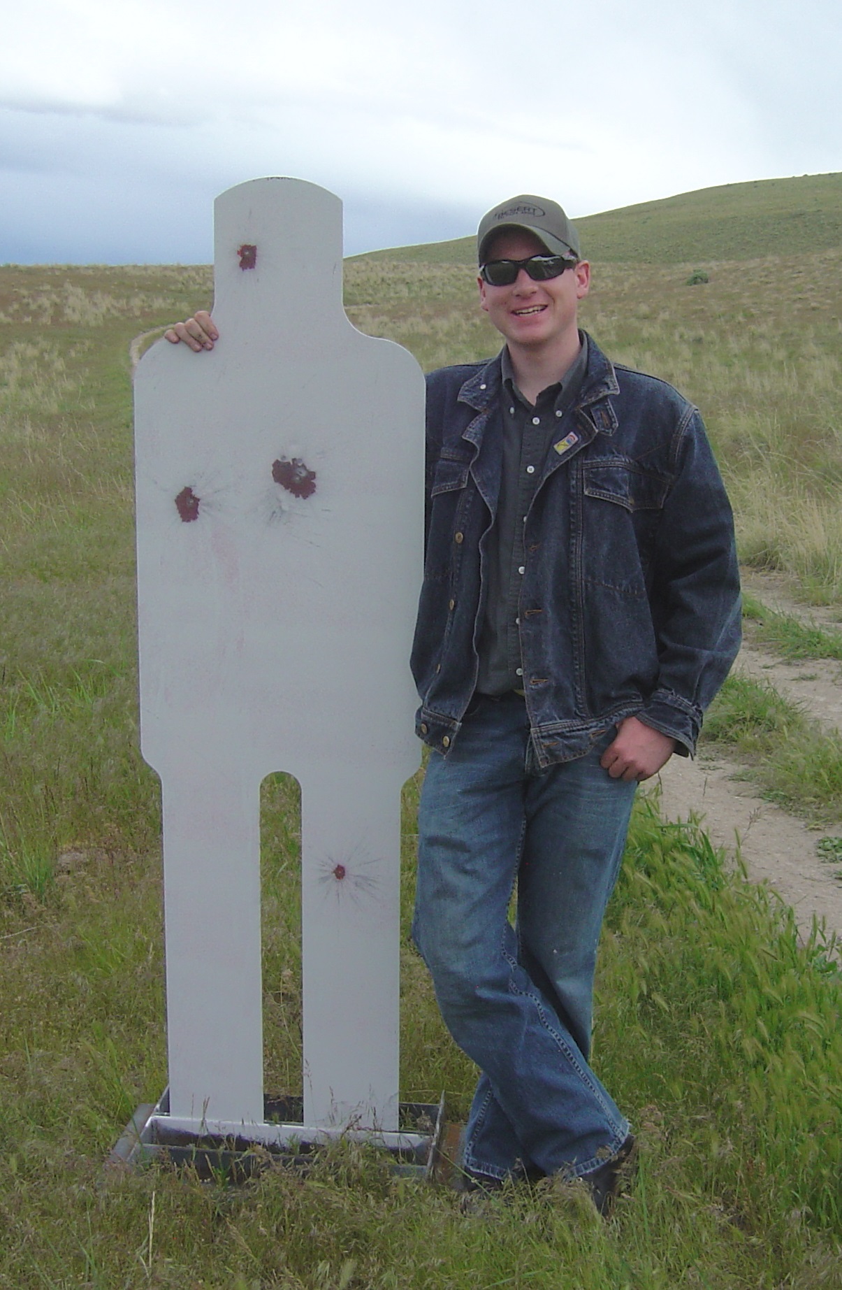

With something like a 338, you're going to punch right through 1/2" mild at 500 yards. Thicker stuff is going to get hammered and have massive craters if it doesn't go all the way through. When stuff gets pockmarked like that it gets dangerous with all kinds of ricochets coming off of it.
Hell, 223 will punch right through 1/4" mild steel at over 100 yards.
