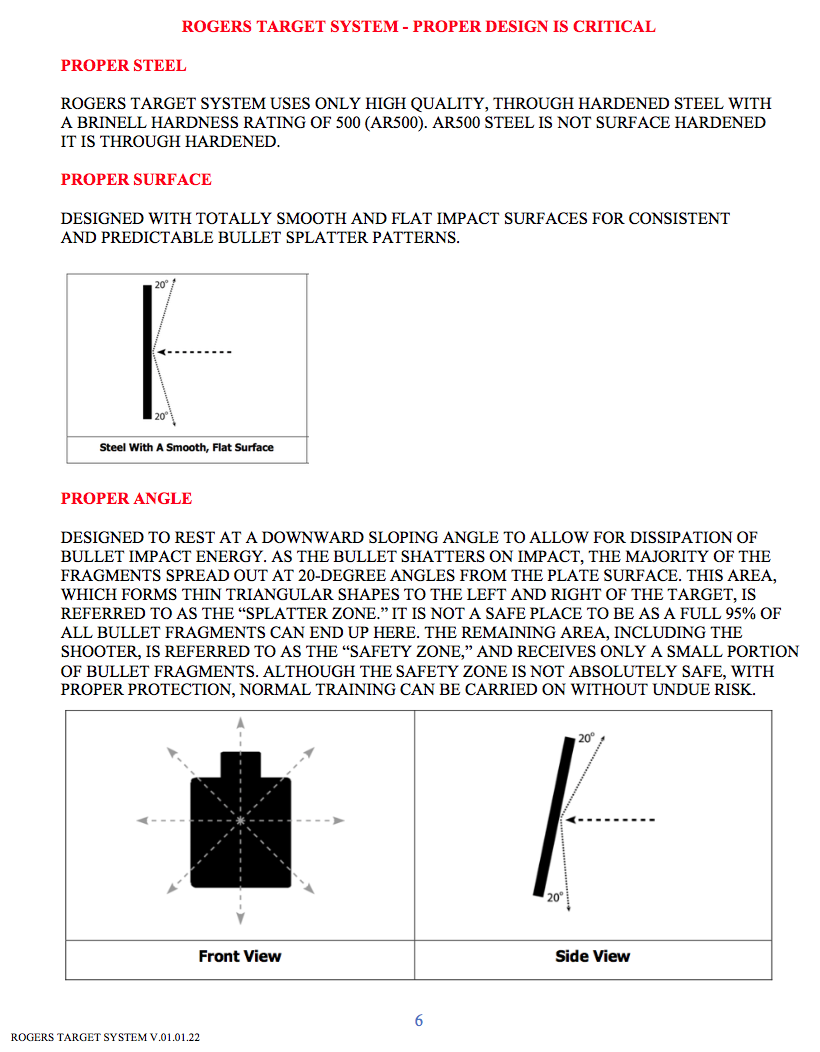

Personally I wouldn’t go less than 7 yds. Helps if the plate hangs down with the bottom slightly tilted to the rear, but the main issue is going to be if somebody hits the hanger itself -ricochets can happen then.

Use thru-hardened AR500 steel, not less expensive / durable surface hardened steel.

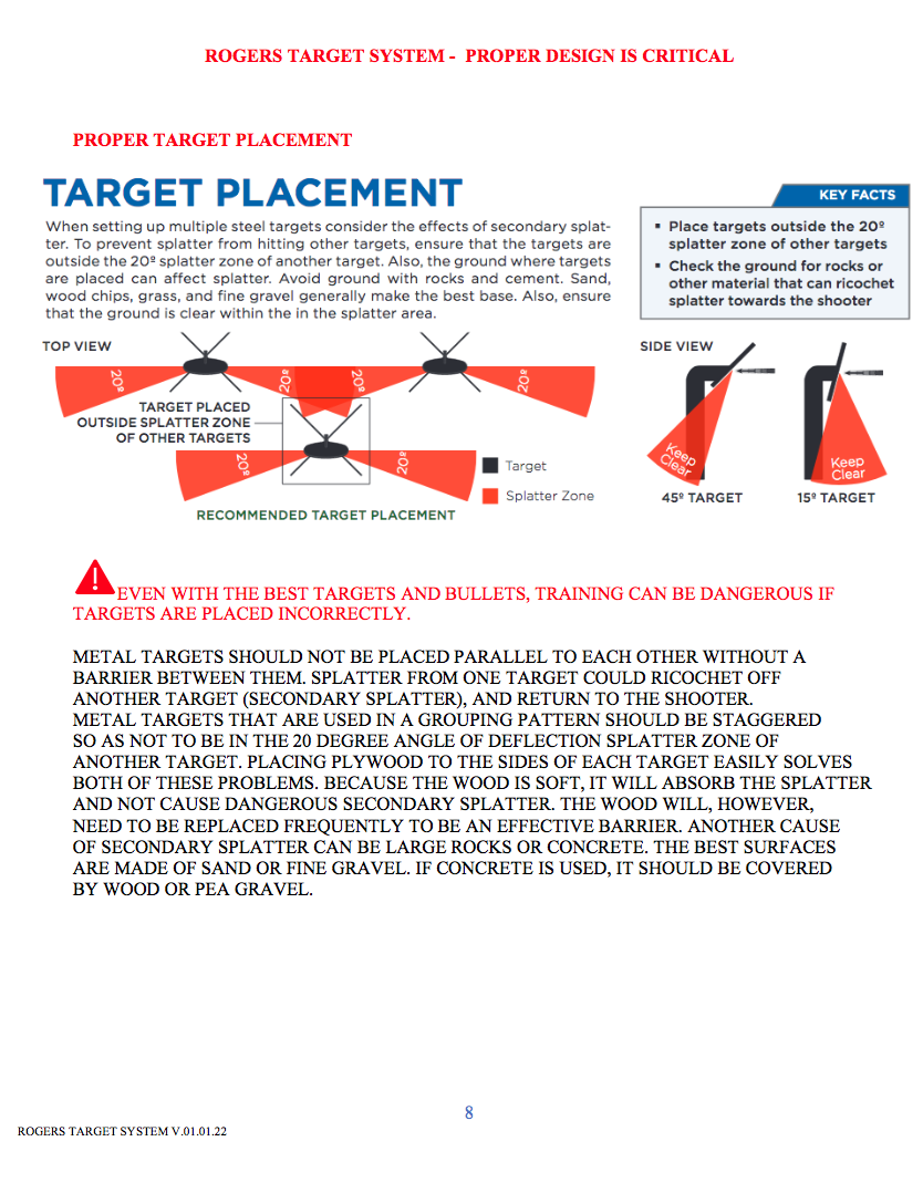

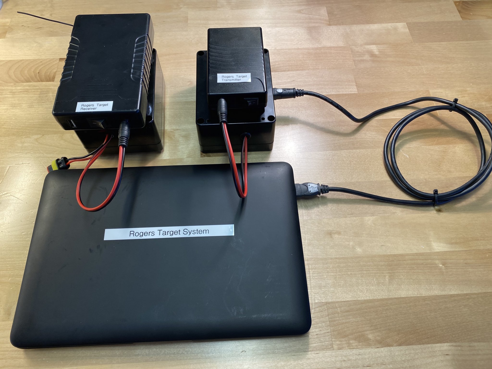

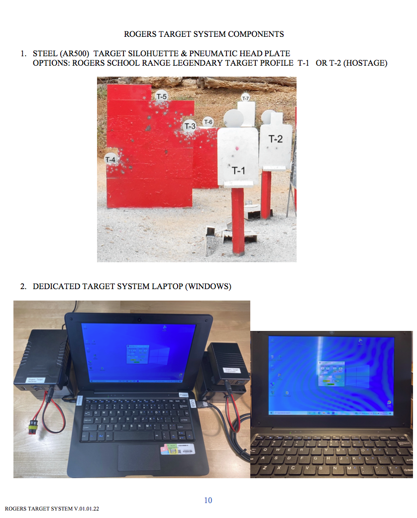

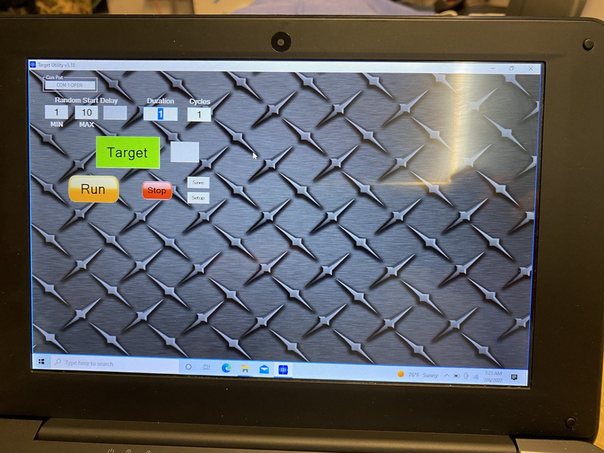

Invest in a Rogers pneumatic laptop computer portable target system. You can set the head plate target exposure time from 0.5 sec to whatever longer.
Using polymer based ammunition you can safely train at contact distances to replicate perhaps real-world encounters. See target notes for distance and ammunition type / muzzle velocities when NOT using frangible ammunition.

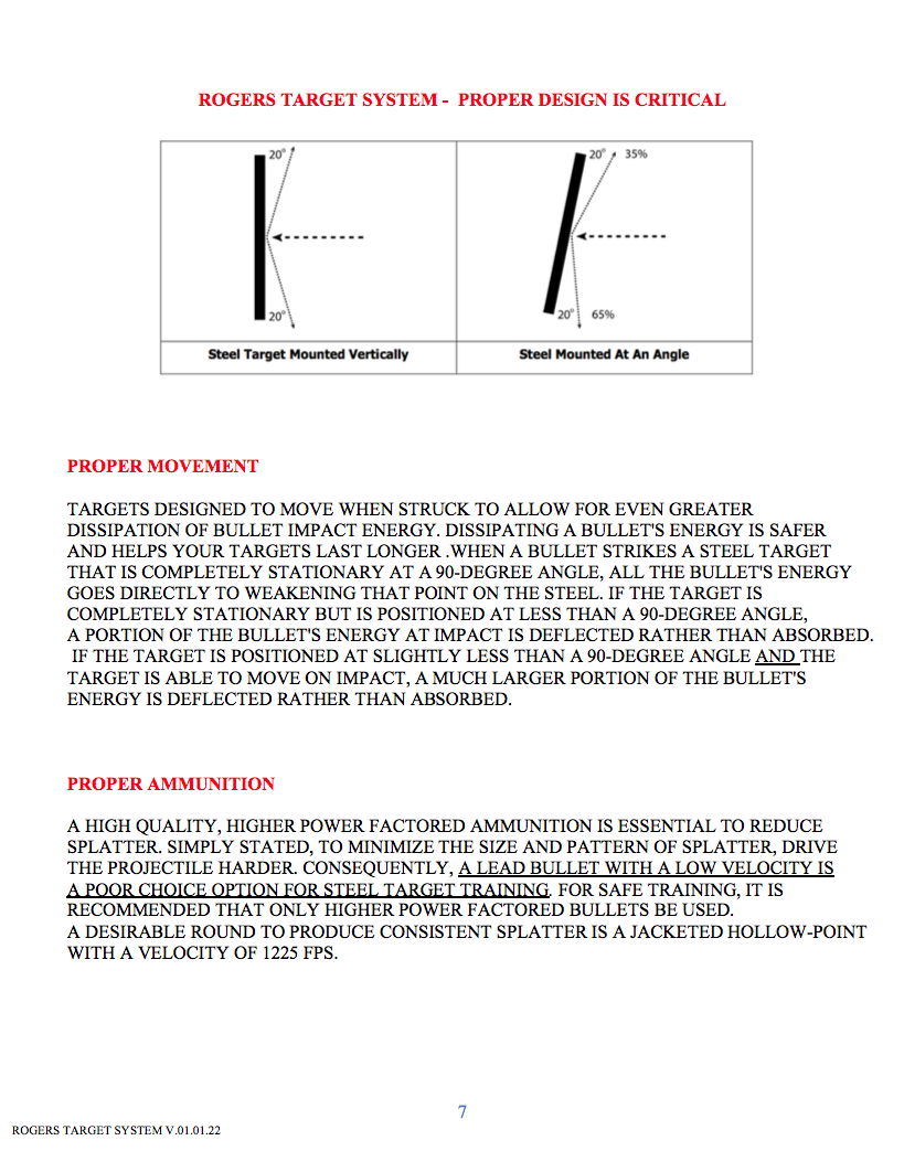

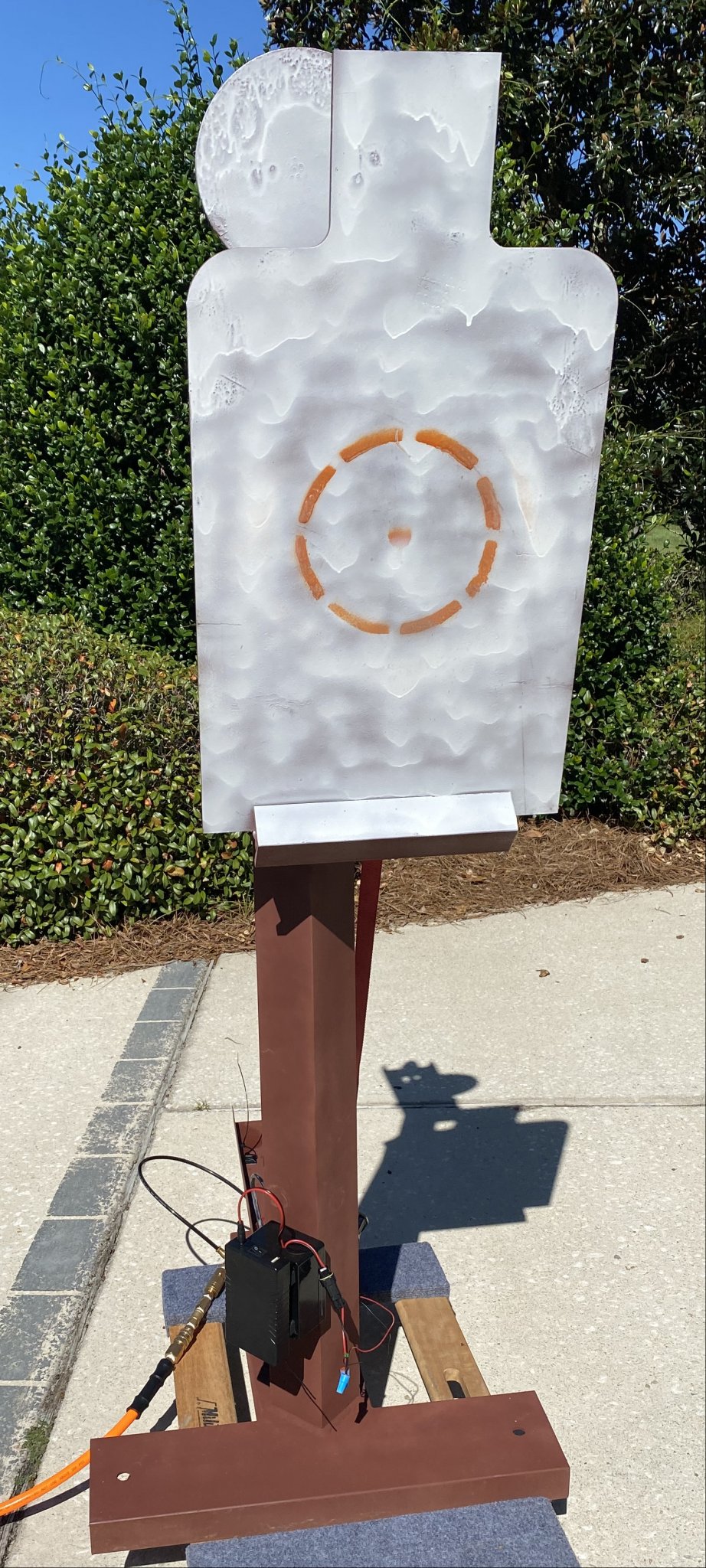

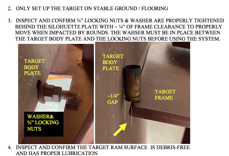

I authored the Manual for the Rogers target system, below a few out takes of recommended AR500 steel body-head plate setups.
You can get the head plate to be full value centered on the body or as a hostage partial head plate exposure setup (shown).
Lighter head plates are available for use with .22LR and .380 ammo.

Definitely angled down.. If you're teaching a brand new shooter, I prefer to just use a clean USPSA target at 3 yds. Once they figure out grip and understand the recoil a little better, move them to 7-10yds on steel.
