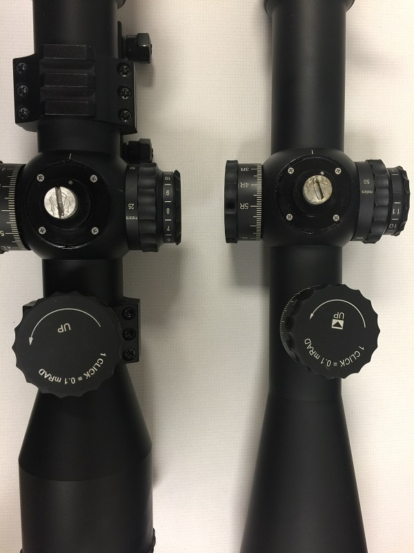

I have it on good authority that the picture below is the best way to ID the new turrets (new on the right)

I bought a T5xi in the 5-25x56 with the new turrets with the triangle, but the slot under the cap is the single slot and not the cross slot as in the pics above. The cross slot was described as the new one and I just got it and have not checked the tracking on it. Should I consider sending it back in for the cross slot or run it and see if it tracks properly?

It's not somewhere, it's everywhere. You're serious that when they go from 5 mil turrets to 10 mil turrets the clicks no longer move in 0.1 mil increments? Then why would anyone want 10 mil turrets? I don't see how a loss of accuracy would be worth not having to twist your finger as much.
Here's 89 clicks.
http://i.imgur.com/sguaqVK.jpg
Here's 90 clicks.
http://i.imgur.com/eHlnzVr.jpg
They're 0.15 mil apart, and you can't dial to 9.0. If I was behind the rifle and not using a camera an inch from the turret, I'd assume that was one click going from 8.9 to 9.1. That's normal with 10 mil turrets?!
I tolerate such misalignment on a cheap scope, even though it's disconcerting, but wouldn't on one costing what this scope does.
Had a NF F1, 2 March and a Bushnell LRHS with 10 mil turrets. The first three scopes mentioned all had line marks lining up as perfectly as can be expected. The LRHS is sometimes slightly off, meaning it's still very close, on the line just not centered .
Customers of Steiner sending their scopes back for repair and receiving unsatisfactory results repeatedly.... Supercd, this is the kind of post I have referred to in the past which continues.
I purchased a GEN I when they came out, noticed 0.2 Mil of ghost clicks. Sent back to Steiner and they repaired in 1 week. Tracking tests on new "engraved" turrets proves perfect alignment. No issues, would not hesitate to recommend. I would agree with others, nobody should be paying $2000 for this item.
If its everywhere, then line it up at zero and it will line up 9.
How do you figure?
Ok, now that we have either established a fix, or established that its not everywhere.

If your clicks were moving .15 per click, 9 clicks would be 13.5.
If.

If? You said it. All I did was multiply the two numbers you gave me.
You misunderstood or I communicated it badly. All clicks are seemingly random increments. The only time the marks line up closely is from 0 to 1 mil. From there until it bottoms out they're all over the place.
