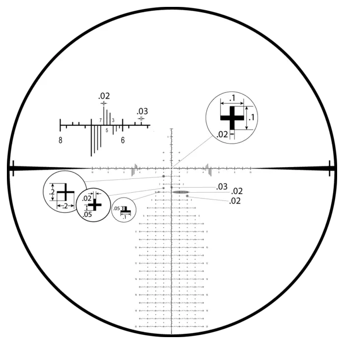

This one?
Thanks. Yeah, I saw that last night. He really doesn’t like the 2-12 with this reticle! C_does definitely knows what he he’s talking about and he is very opinionated but I am not sure I have the same taste in reticles he does.
Just eyeballing it, looks like a .03 mil center dot, 0.1 mil hair thickness, 0.2 mil marks that are .1 mil tall/thick, mil marks that are .2 mils tall, little plus signs are .2x.2 mils, floating dots in the tree look like .1 mil, and line dots look like .05 mil.

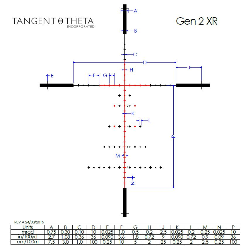

If the lines on the cross on the STR MIL are .1 vs the Gen 2 XR at .025 it should show up fine. Either way I have an H6Xi 3-18 coming today or tomorrow so I will be able to see it first hand. I would still like a drawing. I reached out to Steiner. I’ll post it if they are able to send it to me.
