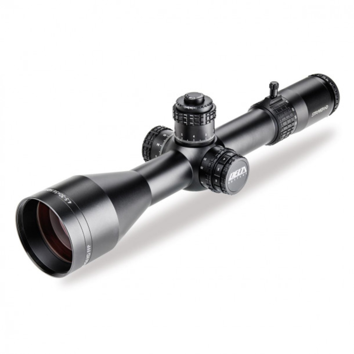

New- Delta Stryker HD 4.5-30
I have not yet personally handled or looked though it so take this with a grain of salt but I have yet to read a disparaging review anywhere. My recommendation of this scope is only from the research I’ve done watching/reading all the reviews I could find and speaking to one gentleman who owns one. From my gatherings, the Delta has been placed on the heels of if not equal to the image quality of the Gen 2 Razor.
