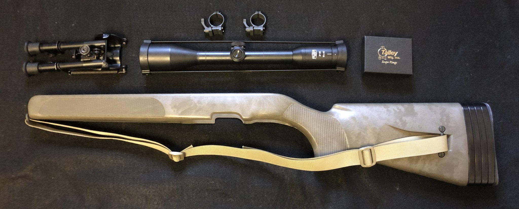

This is my rifle with a M1A magazine mocked up .
