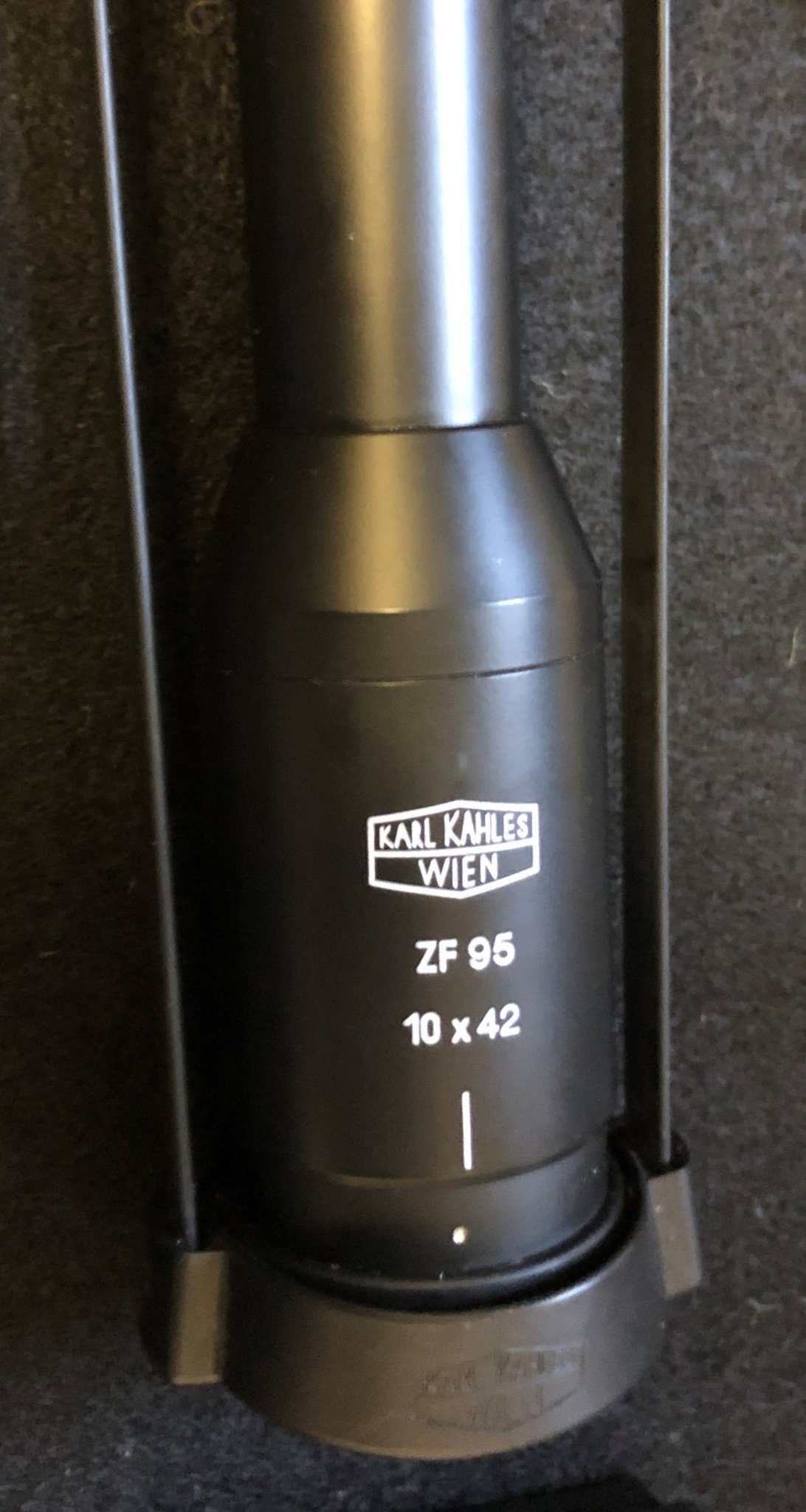

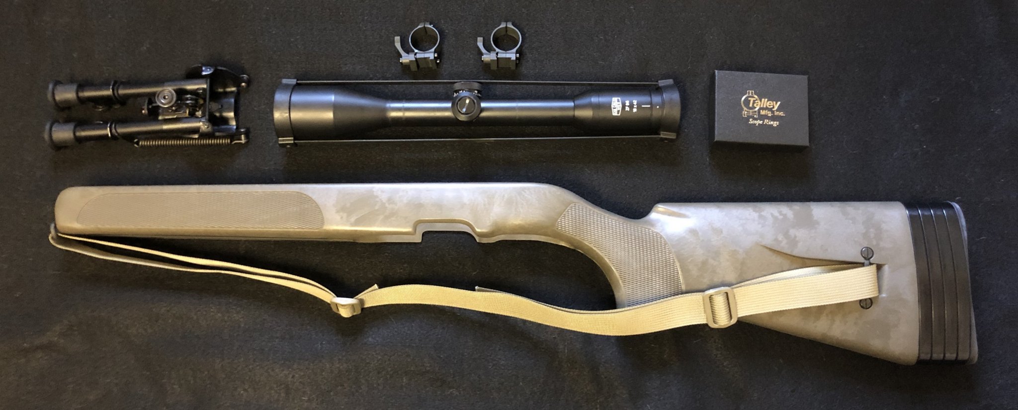

I have wanted a SSG-69 PII for a few years now, and recently acquired a proper European 10x scope (see pics 1&2)....but I still don't have a rifle.
