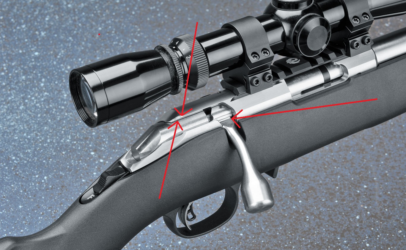

If I were in front of you, I could show you very easily where it is happening. So the question now remains, where is the binding occurring?
Look at the photo below. I've used a stainless RAR for clarity.
The two red arrows point to the angled upper portion of the raceway where the bolt handle contacts the inside of the receiver when pushing forward when upward pressure is applied.
Look at the single arrow on the right side of the photo. The upper forward corner of the bolt handle is "digging" into the upper inside of the raceway (two arrows) when the bolt is moved forward and upward pressure applied.
Trust me, the binding potential is still there but the ergonomics of the extended bolt handle really mitigates that to the point you will think it had never been a problem. Just remember to leave the rifle shouldered and move the bolt.
