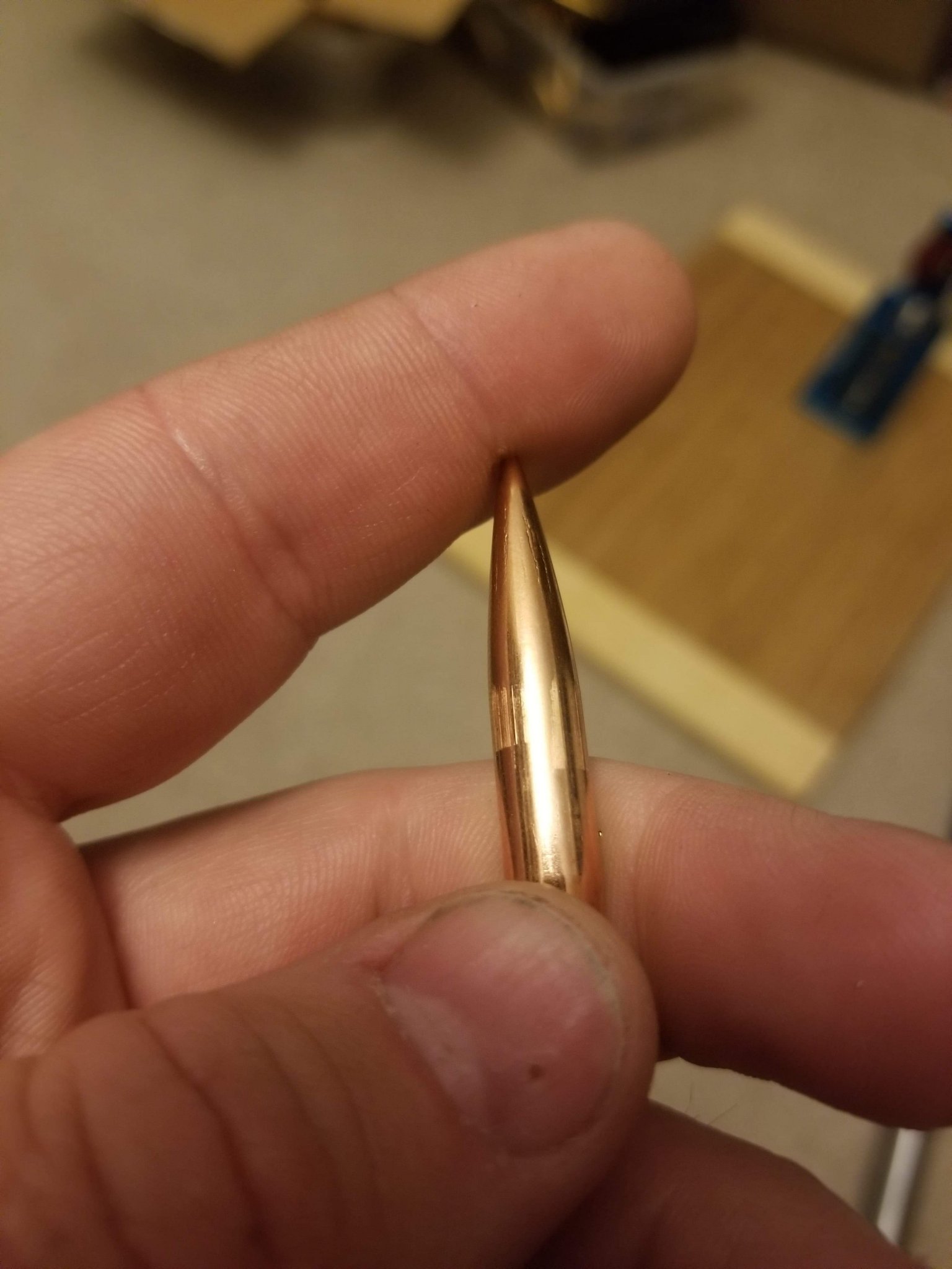

I have a brand new barrel that has this issue. I'm assuming it was a worn reamer, you can see rub marks on the bullets.
