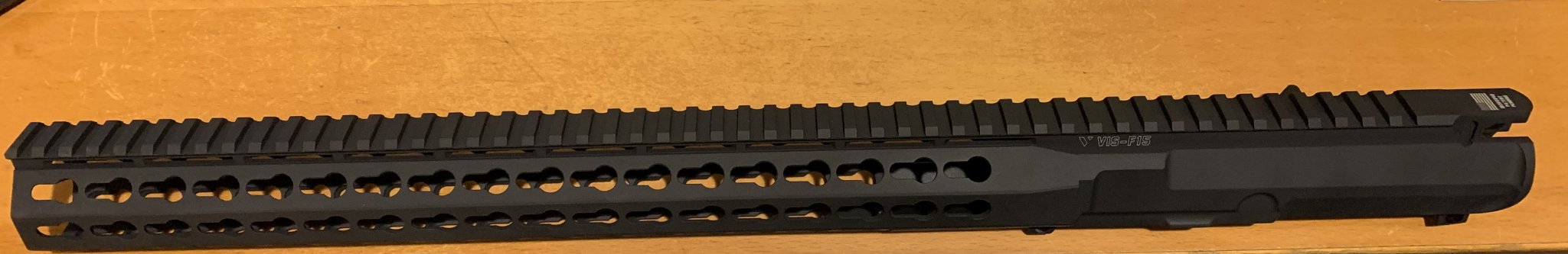

Depends on how far and how much weight is away from the barrel extension. I had a 224V with a heavy 24” and a 6” suppressor on a standard forged wilson upper. When the rifle was supported by the bipod, it wasn’t an issue. Once the weight was no longer supported, I was seeing a consistent 0.6mil drop in elevation on my dope across all ranges.
I put the upper in a vice and applied little pressure to the end of the muzzle and you can see the receiver extension flex. It’s simple, just like a crane, the further the weight is away from the base, the more it takes to maintain that load as it extends.

Conceptually I like the idea of increasing upper stiffness. But, the Noveske and BCM receivers are thickened in ways that shouldn't really matter.
To me, it appears the least stiff area is the threaded extension. The area behind that is considerable taller/wider and should be much more stuff. So, I would look for receivers and handguards that use non-standard attachments with increased thickness in the classically threaded area. Examples of this would be the Larue and Aero Enhanced models.

The VLTOR Fusion is a good example that tries to isolate the hand guard from the barrel connection.
At the end of the day your still hanging a heavy piece of steel from an aluminum receiver. It has limits.

Another claimed advantage is that there is less stress on bolt lugs due to the barrel extension remaining better aligned with the bolt during cycling. It would be interesting to see an actual test for bolt durability with a normal M4 upper, a Colt Le6944 and something like a BCM Mk2 with all other variables held equal.
Something like the monolithic Colt or LMT MRP is probably going to be much more rigid as they redesigned the barrel nut as well, rather than just stiffening the upper around the ejection port.

Not sure if that's the selling point of these one piece units, But as 357 Max says there is only one point of contact for the barrel and the upper. And like "bolt guns" you would loose the "free floating barrel" if there was any support built in or added to the hand guard
I had a JP handguard on an Aero M5 standard upper with a .308 JP barrel. It was not forgiving in regards to loading the bipod at varying amounts. Was getting misses on small targets at 500+ yards depending on my preload weight.
Switched over to a Aero M5 enhanced with same barrel, found it much more forgiving. I can load as much or little now and don't notice a difference down range.
Out of curiosity I jammed my finger between the handguard and barrel while preloading the bipod. Old setup would pinch my fingers with slight pressure, the M5 enhanced setup did not give the same hard pinch.
