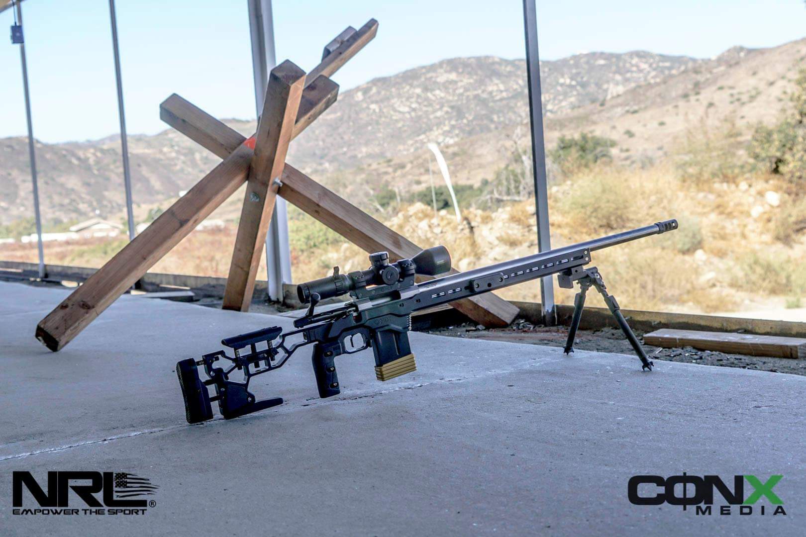

Sorry it took me a while to respond I have been busy with work. I have one of the new Stiller Wraith Actions. In fact one of the first ones off the production line SN 001. The action itself is octagonal and still has a drop in 700 footprint. It has a 20 MOA integral rail and recoil lug. The bolt release has been beefed up from previous actions so it no longer has the stiller curse of busting roll pins upon hard running of the bolt. This is something that has been fixed on the tac30's as well. The bolt has a DLC finish I'm not entirely sure which actual brand name coating it is, however it is very slick and does not bind inside the action. I had the opportunity to run it in a NRL match this month and was very pleased with the performance of the action. If you have any specific questions about the action I would be happy to answer those for you. Attached is a photo of my wraith used in the match.
Reactions: 6brshooter

Somewhat older thread but I'm not finding much else on the Wraith. Anyone else get one? What are your thoughts? I know almost nothing about Stillers, but it seems the TAC series require a scope mount and recoil lug to be added, where the Wraith not only includes them but they are one piece with the action. Are tennon threads and headspacing all the same? From the website it looks like Stiller's are probably more of a push round feed with spring type ejector (R700 style)?
I have the very first Stiller Wraith and I still absolutely love the action. I have used it in 10 - 120 degree weather and in some pretty dirty environments as well. The bolt to body fit is very solid however its not so tight that if I get sand or grit in it that it binds up on me. The bolt itself is coated in a DLC like coating and is very slick.
