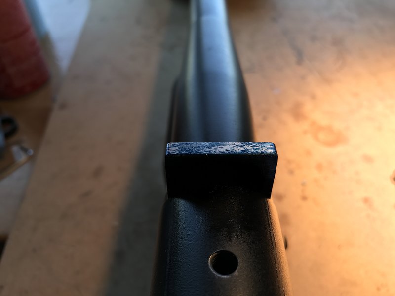

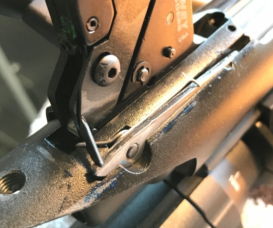

I'm building a gun for a friend and he sent me the exact same stock. I don't like how the recoil lug allows the action to rotate in the stock so I was planning on bedding the lug area to stop rotation. Anyone else do that with these mini-chassis?
It corrected your problem described. Now I can use a wide range of torque combinations to find the sweet spot without putting undue stress on the action / chassis. Still have contact in the critical locations with a pad to pull the tang onto.

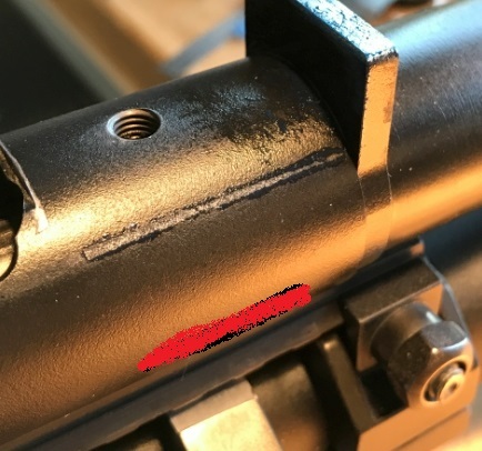

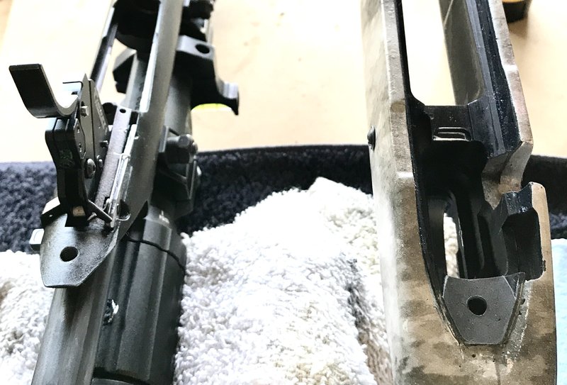

That's all I bed was the tang. Before the bedding - Rifle was zeroed Friday and shot consistent, went back out on Sunday and shot with repeatable results. When bedding I changed the OEM trigger with a Timney, nothing else was altered or adjusted. After bedding and trigger change I went and shot at 200 yards on paper with a shift .9 mils to the right. That's a lot. Adjusted and shot steel out to 1000 yards without any changes in elevation or windage. I'll be heading back out tomorrow to verify if the rifle is still on target. I'm wondering if the stress on the action was that influential?
The recoil lug was addressed by the GS by machining the chassis to match. It was a little off so I fit it with jewelers files to have even contact and eliminate contact on the bottom by about .003".

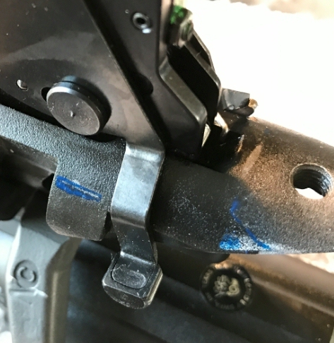

Parshal, my mini chassis never lived up to billing until I bedded the lug and tang area, it tightened up the groups by taking out the inconsistent shot. I should have don't it first thing.

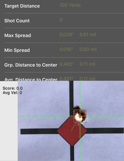

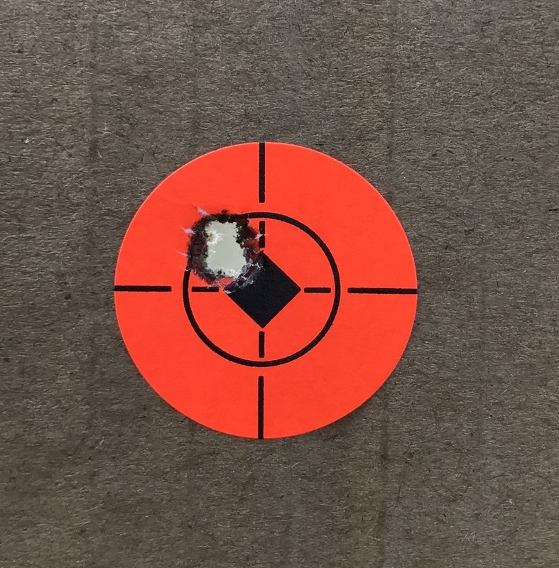

Just finished shooting some seating depth groups with the bedded tang. Very happy with the results and I now have my load data. Groups at 100 yards.
