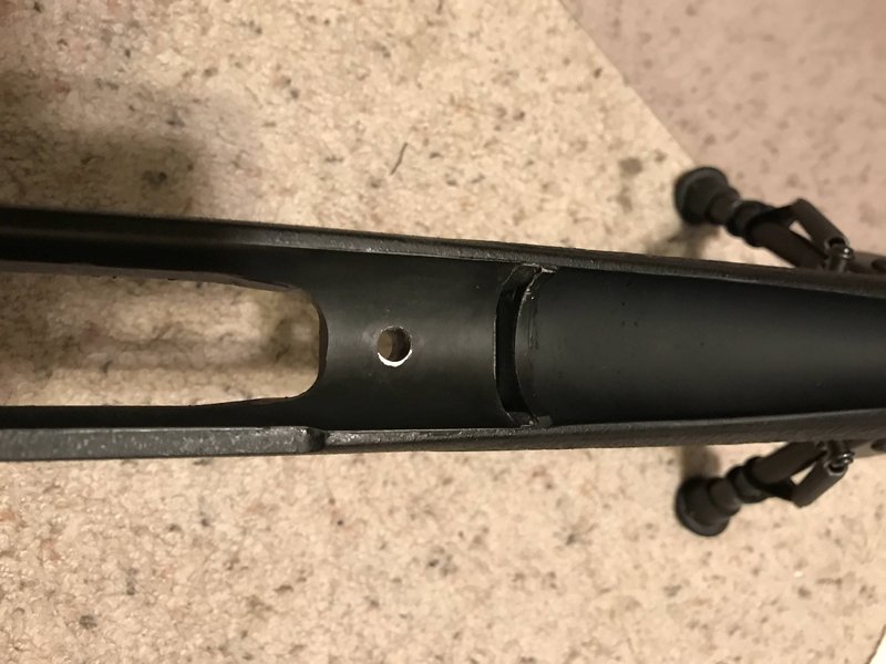

Quick question: when you filed the surface to rough it up, you didn't relieve any material on the pillar correct? From my understanding, that dimension is left alone since my (and your) pillars are already installed.
Correct, only roughed up the fiberglass.

I do have another question with regard to relieving material for the mud. Did you leave a "shelf" at the rear of the tang as seen here: http://www.accurateshooter.com/technical-articles/stress-free-pillar-bedding/
Given that we already had pillars installed, I should relieve material all the way to the end of the tang since the pillars will be what my action rests on correct? Contact points would then be the 2 pillars as well as the tape on the end of the barrel to align it in the barrel channel vs shelf left on tang and tape on barrel (as in the article)?Just making sure I have a proper understanding and hopefully that made sense.
My main reason for roughing-up the fiberglass was to give the Marine Tex an little more surface area to adhere to - I wasn't concerned with a minimum thickness of bedding material. You could probably just use coarse sandpaper then wipe it down with acetone before applying the mud. Marine Tex is made to adhere to fiberglass.
I ended up with a thin layer of epoxy between the top of the pillars and the receiver.
Yes, those damned last shots that spoil good groups! :-(

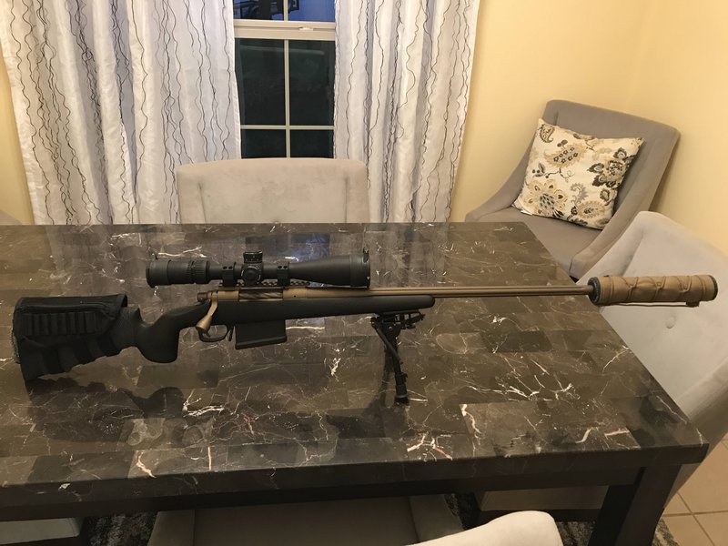

I just wanted to follow up on this thread. Everything came out better than expected so I'll head to the range hopefully this weekend to test.
