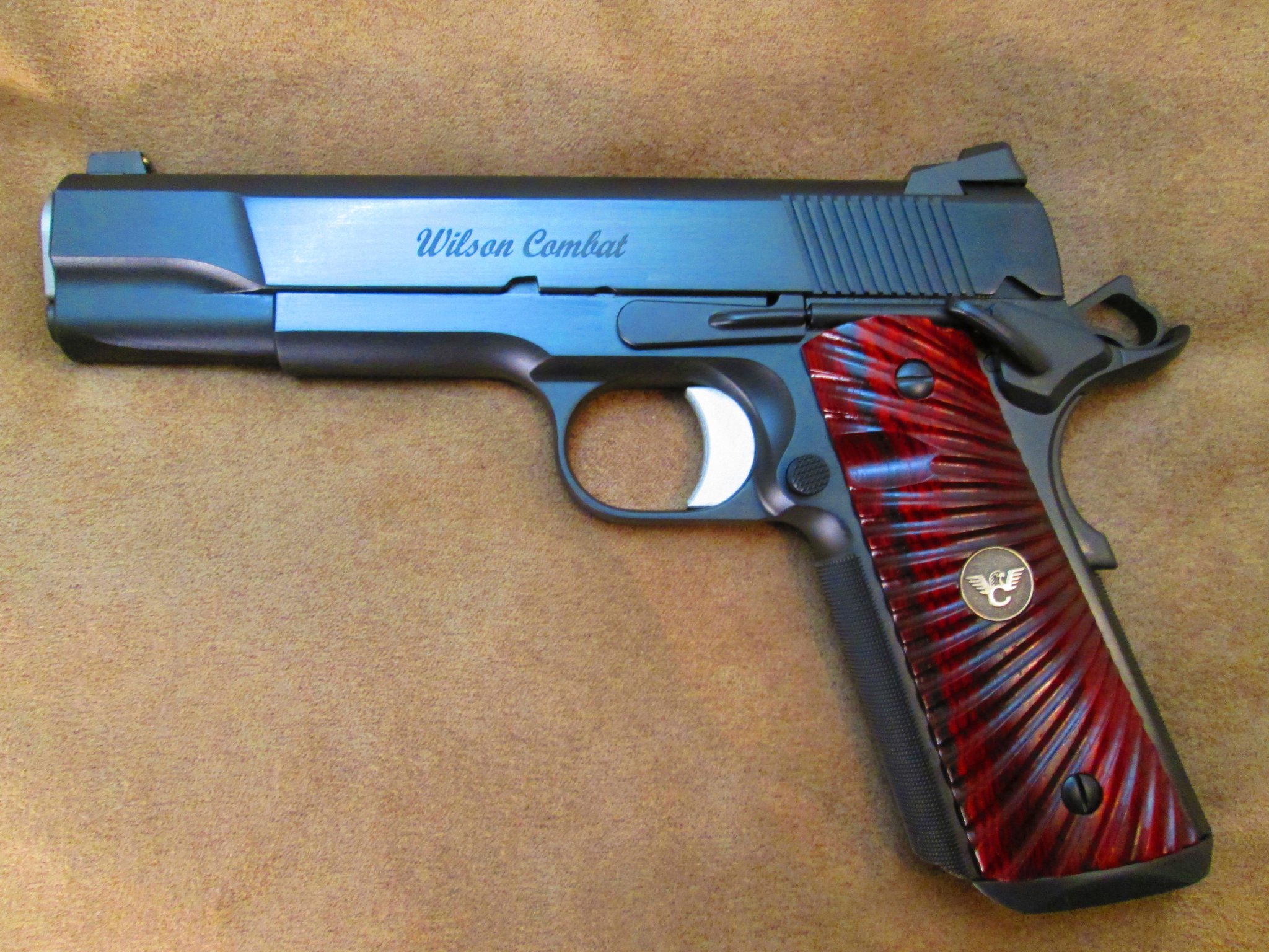

Virtually all handguns position the firing hand fingers an inch or less behind the trigger. . .

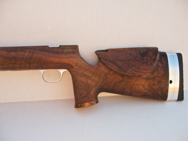

like my .45 here.

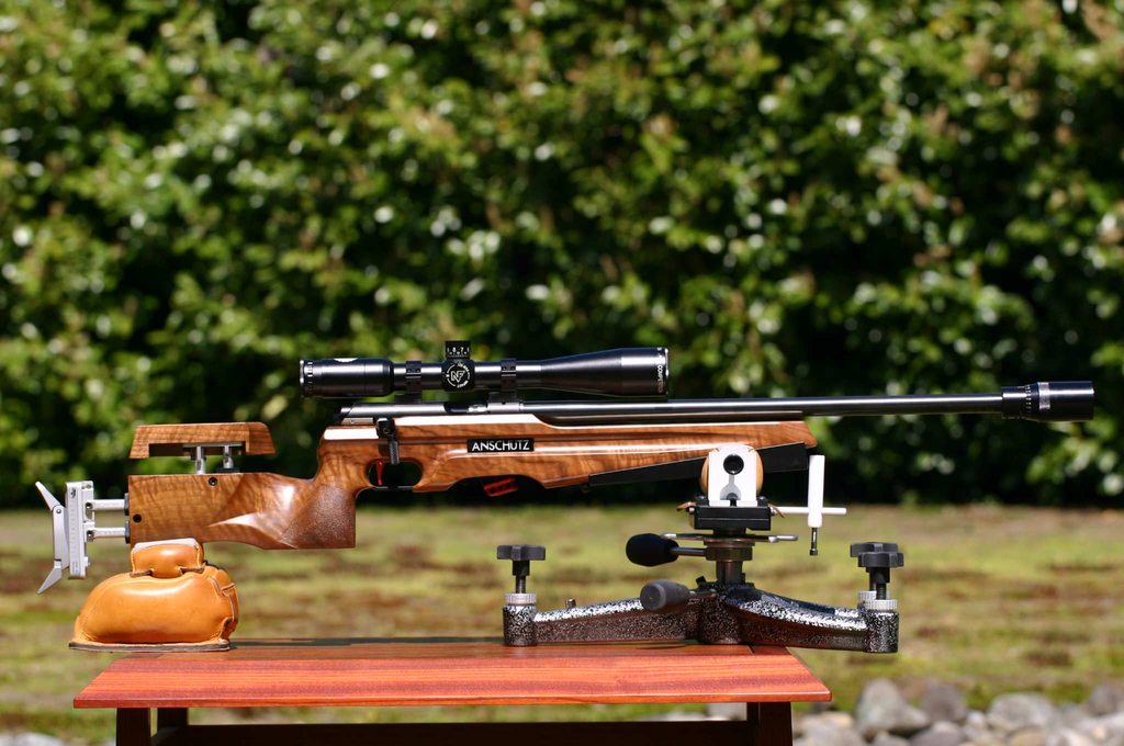

Many precision rifle stocks also position the fingers of the firing hand very close to the trigger to facilitate a short, straight, and un-strained trigger pull. . .
like this drop dead gorgeous Anschutz 1927 CISM
or this Doan Trevor Palma stock

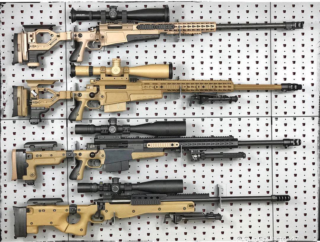

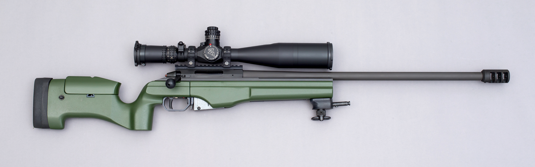

Some of the most widely respected sniper rifles have adopted these ergonomics. . .

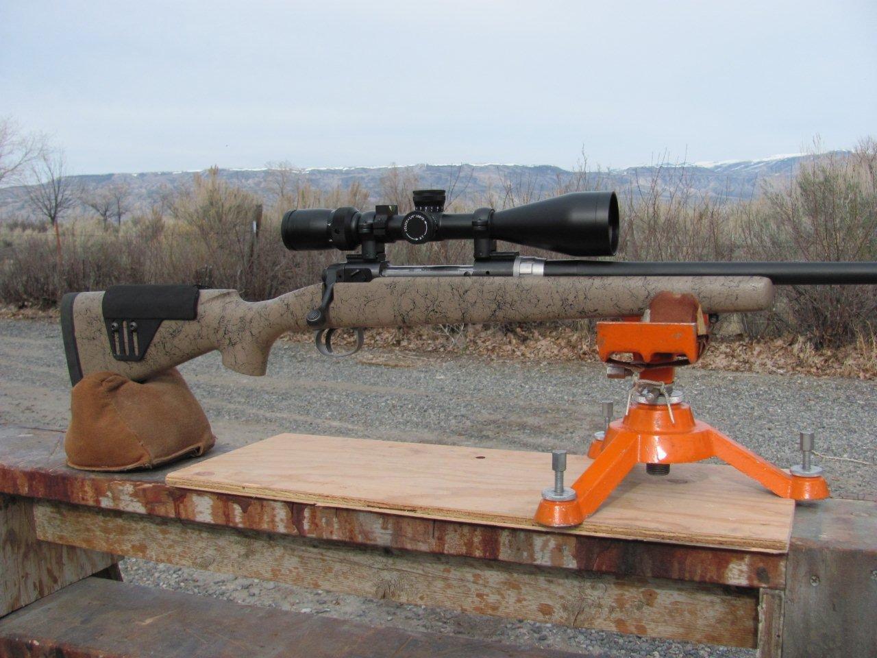

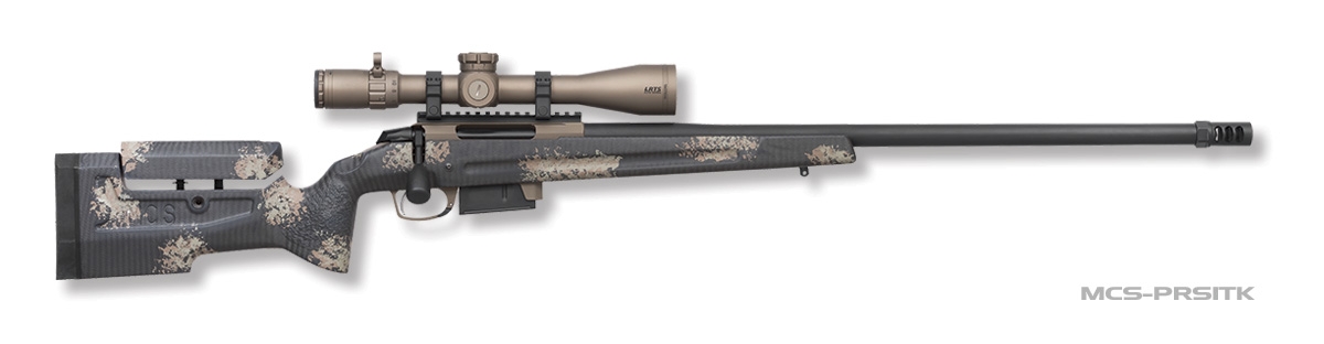

My question is this: Why do Manners, McMillan, HS Precision, Bell & Carlson, etc. make their precision rifle stocks with the grip so far behind the trigger?
like this Manners PRS-1 as an example
Is it just something that got carried over from making sporter stocks for hunting rifles? Is it designed for a different type of shooting? I mean look at the grip on this sporter. It's a country mile behind the trigger. That can't be good for consistent shot placement because your hand has to float, right?

As far as I can tell, the modified hand position is because you can’t put your palm behind the vertical grip on stocks, so they set it up so your palm rests against the side of the grip instead of your fingers resting against the side of the grip and your palm hanging off in space.
Reactions: Odysseus1911
Might have to do with the bottom metals...they’d have to cut a channel for the rear bottom metal pad
I dislike it tho...the most comfortable grips to me are vertical chassis and ARs that sit right against the trigger guard like my AI...it just fills your hand and doesn’t leave any dead space in your hand
my AI fits like a glove, my manners and foundations I can shoot fine, but don’t feel near as locked in/connected no matter how I grip them
AG Composites also has a very long reach. I think part of the reason is rear action screw access.
I ended up trying a Magpul 700 pro for the adjustable hand grip location on my last build and it's working out nicely. The KRG Bravo I have also puts your hand in a good position close to the trigger guard.
Notice that on the foundations they’ve been moving the grip closer and closer every new model, it’s almost there
genesis > exodus > revelation
revelation is right up against the bottom metal pad pretty much
It's amazing to me that this isn't figured out and standardized by now. Human bodies are different but finger lengths aren't really that different. Whoever consulted their grip design in the beginning should probably be acknowledged as "not on it".
Lol the funny thing is that original grip was checked out by a really well known and good shooter/smith and he said it was perfect how he liked it
wasn’t an accident, just a really different preference apparently
A couple of those OG foundation runners do have some pretty big bear paws for hands though. If John Kyle would just add more palm swell like the manners have I'd be running them over the rest.
The "traditional" rifle stocks also let you grip higher, with the middle finger behind the trigger guard....
I've been grappling with this same question. Look at the Kimber Montana and Hunter stocks. They have a swept back grip which I can't stand. I believe traditional stocks have a drop at the comb and flatter grip angle due to history/tradition. Think of a model 94 lever action. Traditional hunting stocks (I believe but may be wrong) were designed to be shouldered while leaning into it and standing or sitting with the body bladed 45 to 90 degrees from the target... certainly not square to the target in the prone.
Now why has it taken this long for stock companies to produce more vertical grip angles with the trigger closer to the grip??? My guess (and only a guess) is trends and sales. Up until recently, the PRS/Tactical world was a small segment of rifle stocks. People are slow to change. Some people on this site changed 30 years ago, others more recently. But a company won't produce something unless they believe it will sustain enough sales to be profitable.
I got my first chassis in the Black Friday sale from MDT and it's an eye opener. The LSS chassis with an ERGO Delux pistol grip put my hand and trigger finger in the most comfortable spot. If I can wait that long... I will be replacing more of my traditional stocks when sales come around.
This is all just my guess and I may be wrong. I'm just thinking out loud to hopefully contribute to the thread and encourage more participation.

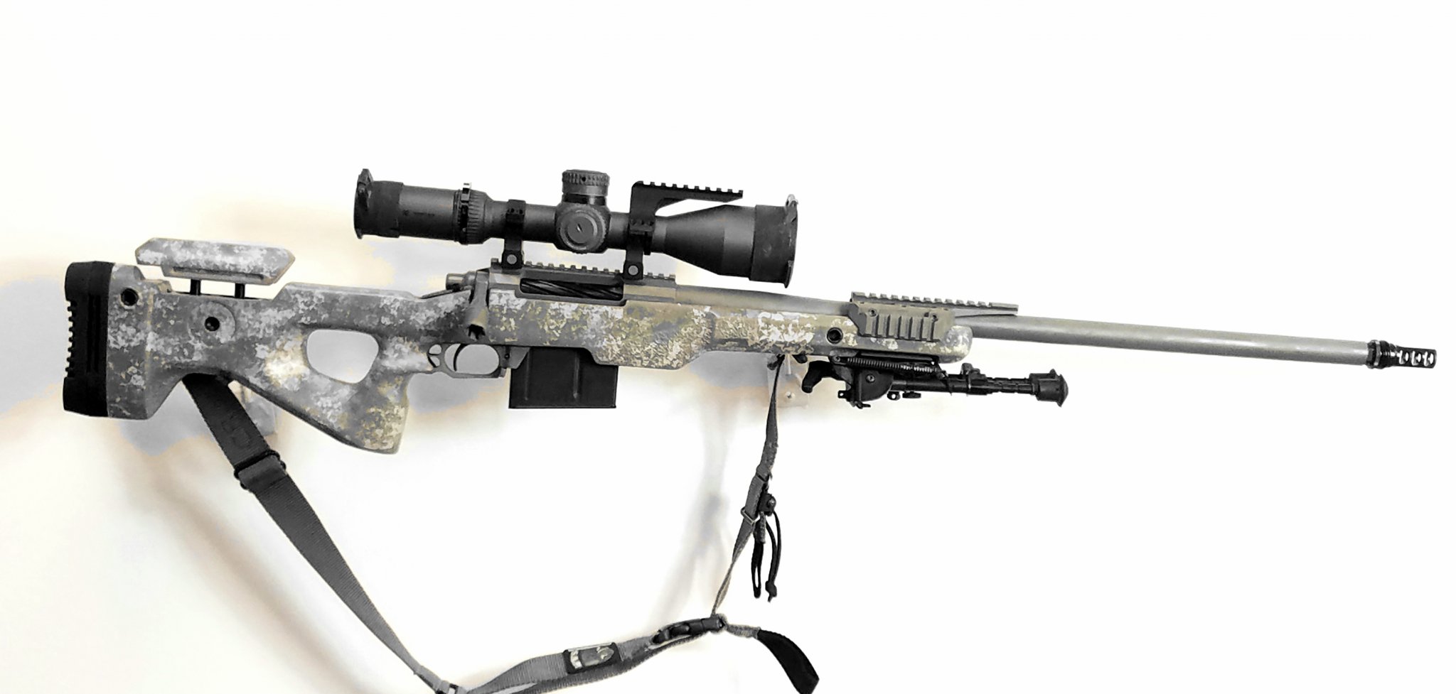

Some worked through this issue years ago.
When the SENTINEL stock was designed, the goal was to allow good hand position regardless of what contortions the rest of your body might be forced into. Those concerns are what drove the entire grip section design of this stock up to an including the "reach" between the trigger pad and where the web of your hand would rest when using the thumbhole.

I did a lot of measuring and surveyed a ton of good shooters before finalizing on the shape and dimensions of my stock but my goal was to have a usable "compromise" that would work across a spectrum of hand sizes and training/capability for the average officer/user that the stock/rifle would be issued to. My idea was that even if a shooter knew little or nothing about hand placement, I was going to get them pretty close just by default.
Stocks are THE user interface for extracting the most technical accuracy out of the rifle under field conditions. Even though we can assign standards you would like to meet, ultimately personal user preferences and shooting styles seem to drive the market. There are some designer grip and stock makers showing up to take their money.

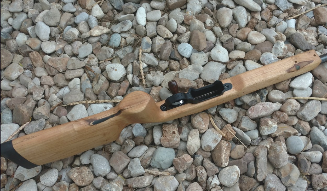

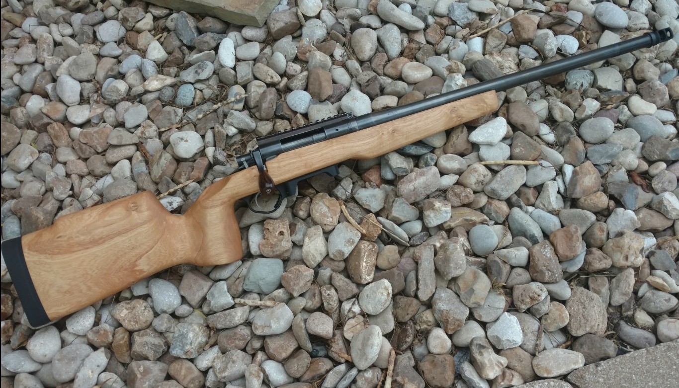

I was able to get the grip on a wood stock this close to the bottom metal with a mini mill and zero experience with making stocks OR using a mill. I'm confident the stock makers can figure it out. With this set up, my middle finger is very close to the trigger guard. If you have sausage fingers it might be too close. BUT it works so much better than a Manners for getting your trigger finger at 90 degrees. I'm 6'1 and have pretty long fingers. You'll notice a lot of people shooting Manners stocks just float their hand over the grip. I really don't understand why they are made that way. Once you've experienced a stock/chassis that has the grip closer to the trigger it's hard to go back to hovering your hand over the grip.
-Dan

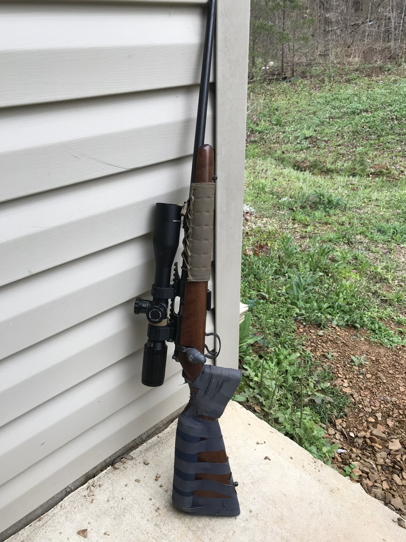

I’m a shorter guy (5’8”) and do wish Manners and McMillian made their grips closer to the trigger. The A10 from McMillian seems to look right though. I actually modified a factory CZ 452 sporter stock for this reason. Looks awful, but it was very comfortable for my hands.
Reactions: carbonbased
A10 is pretty good. It’s slightly further back than AI and Sentinel (they are very close to the same feel IMO).
