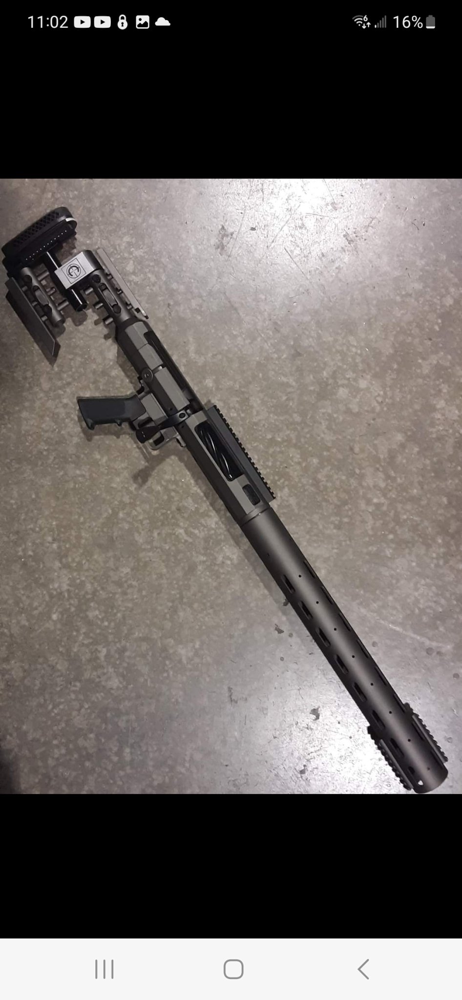

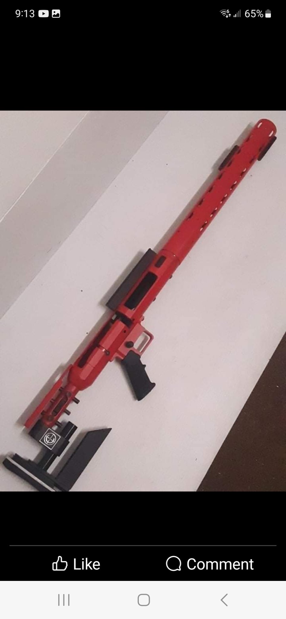

I've had one on order for about six months now, it's the last piece I need. Waiting another 6 months to a years isn't ideal, I might look into other options.
