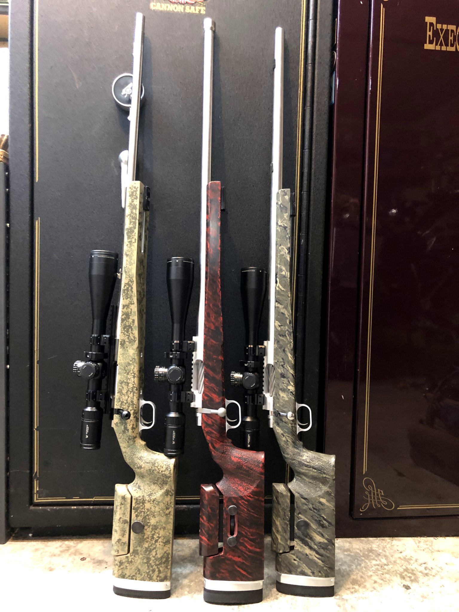

I have 2 F Class Panda's, both in McMillan Kestros stocks. They are perfect. The one on the left is a Barnard S.
John

Beautiful rifles... with the Anschutz rail, is it easy to get picatinny rails to fit? I don't shoot F Class an I build like to use existing bipods. I did get a SEB Joypod-X and I think it might have a piece of pic rail with Anschutz adapter...
Scott

Greetings,
I'm a long time highpower / prone shooter. I'm playing with F class due to an elbow injury. I have both Barnard P's and an S in .223. I absolutely love the Barnard! Simple, bulletproof and a top shelf trigger. But, they are heavy for an FTR build. My dad had a Panda based BR rifle. Made me want one. So, when I went to FTR, I went with the F Class Panda. They are the best for my purpose.
John
