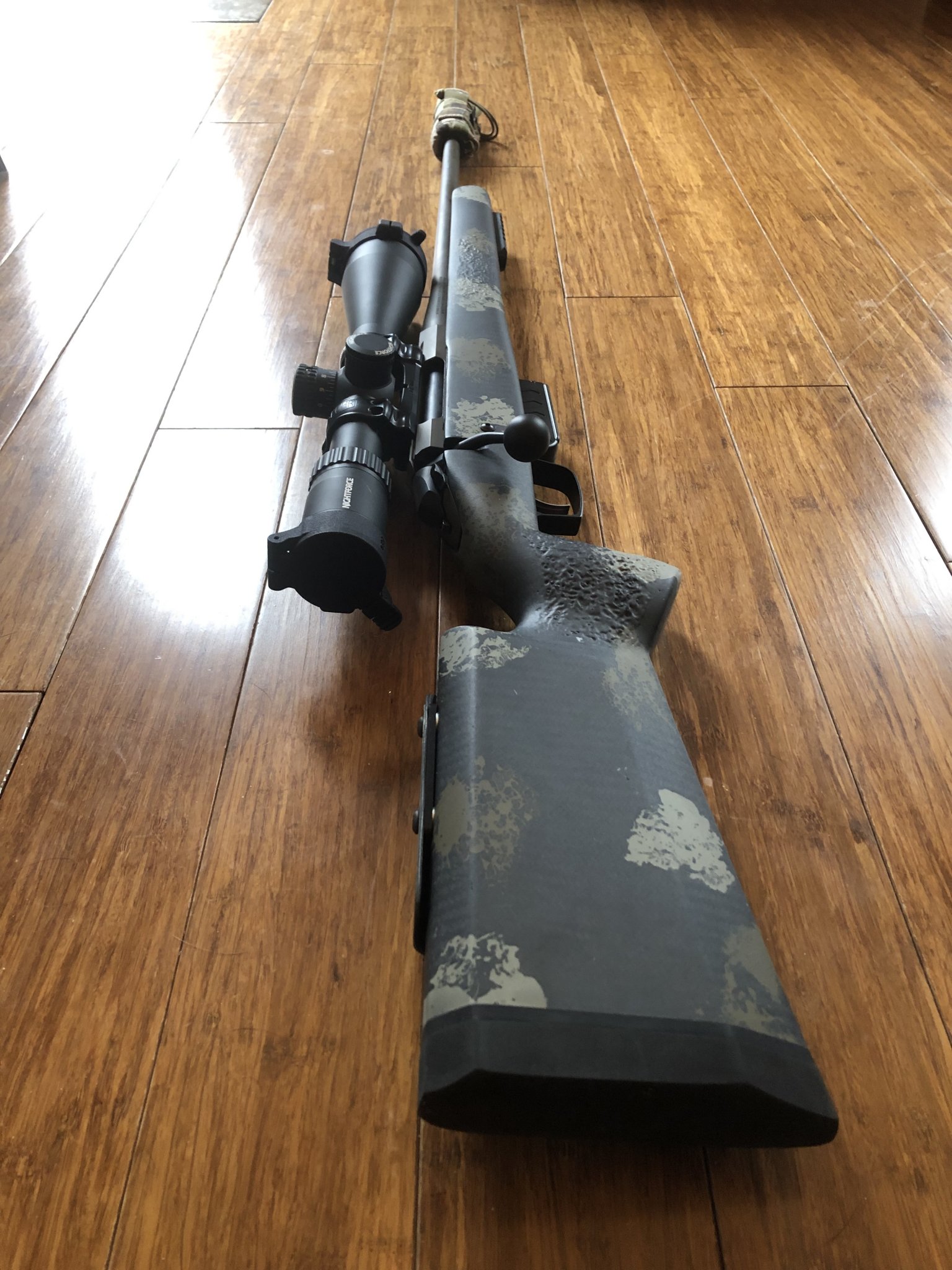

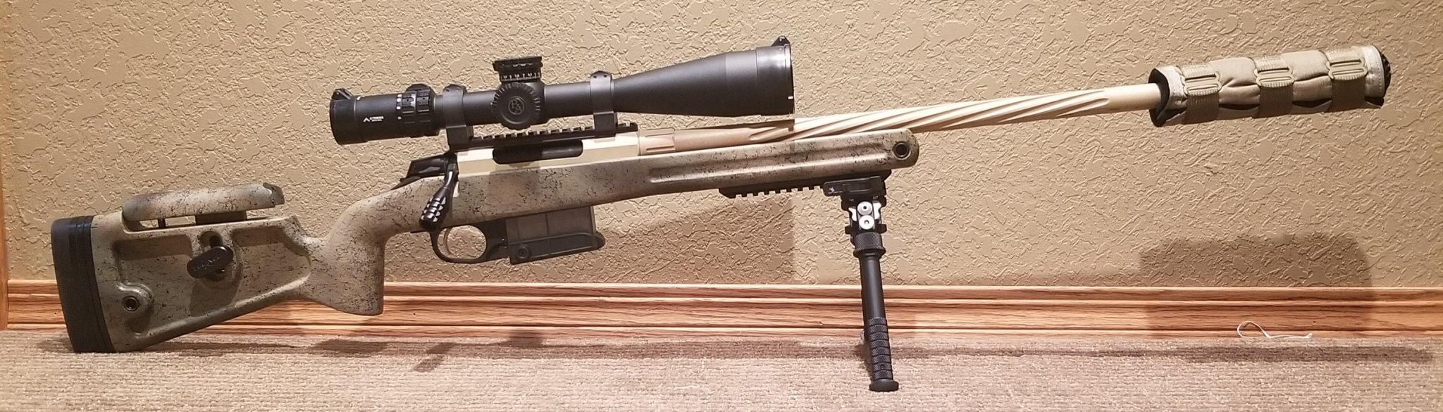

I have the A3 on my CTR. I'll try and take a pic of it tonight when I get home from work.
It feels robust. I have a lot of confidence in it that I didn't have for the stock CTR stock.

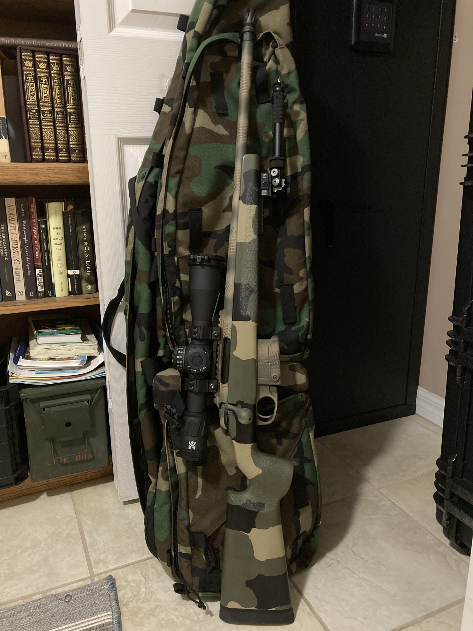

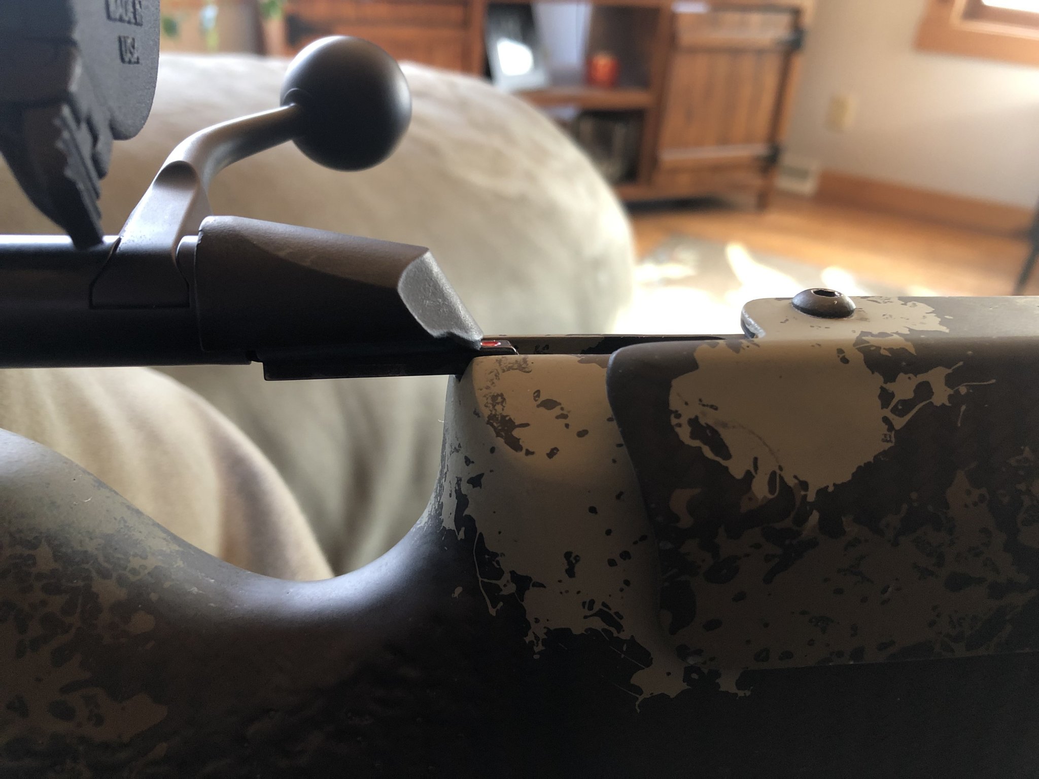

Is there a rail carved out on the top of the comb of your stock? So you can remove the bolt?
If so, did you do that? Or is that something you can order from Manners?

Comes with a slot for the bolt, I can pull the bolt without taking off the cheek piece on this one. It’s an awesome stock, close to a bravo in form and function. Main reason I went this way was because I like the flush tikka mags for a hunting gun.

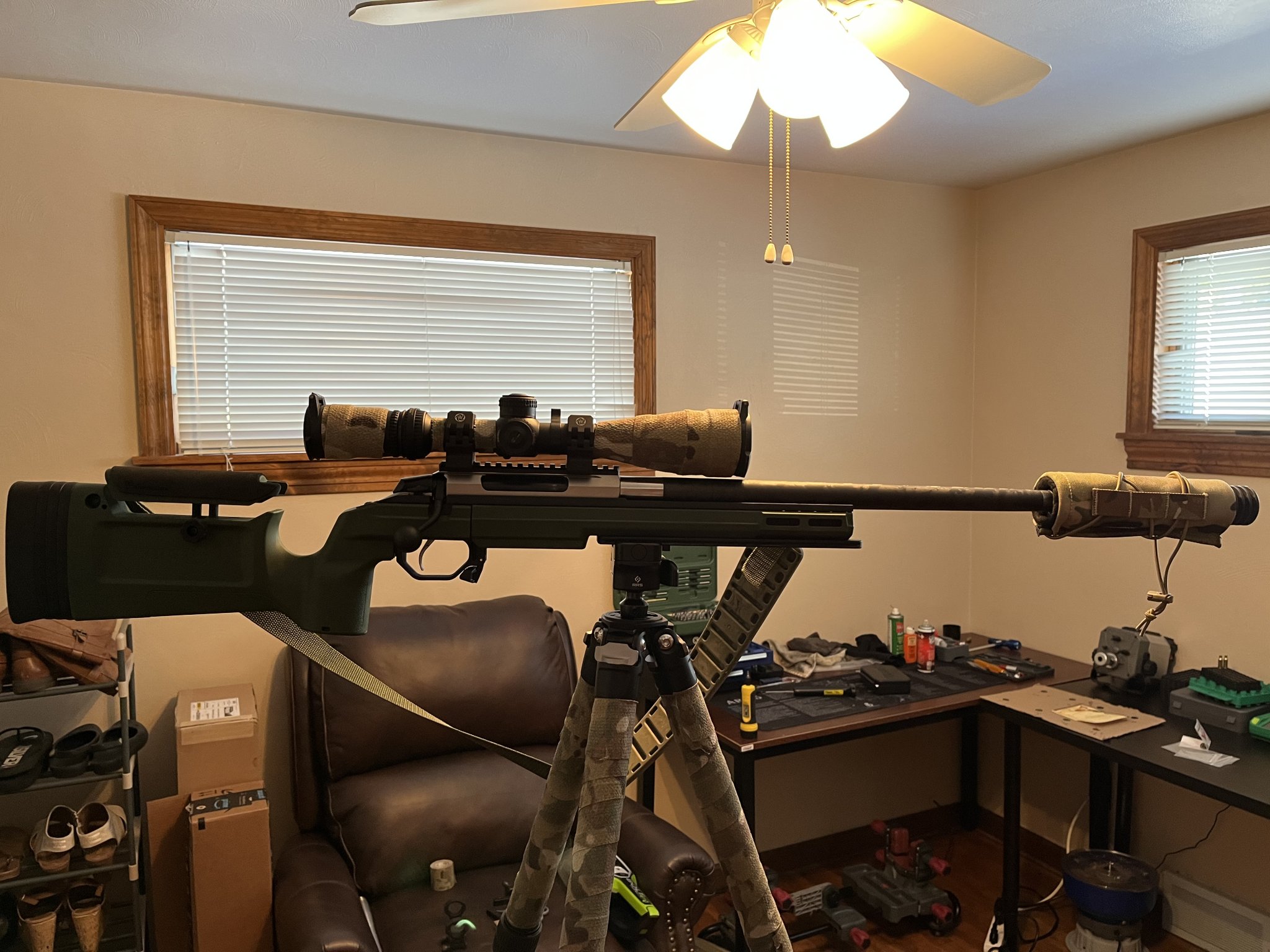

There are three types of mini chassis for the tikka. One that takes aics mags, and is one solid piece, no bottom metal required. I have one of these and if you want a longer mag this is what I’d go with, not a fan of Ctr mags. This is on my match rifle, not the above photo.
