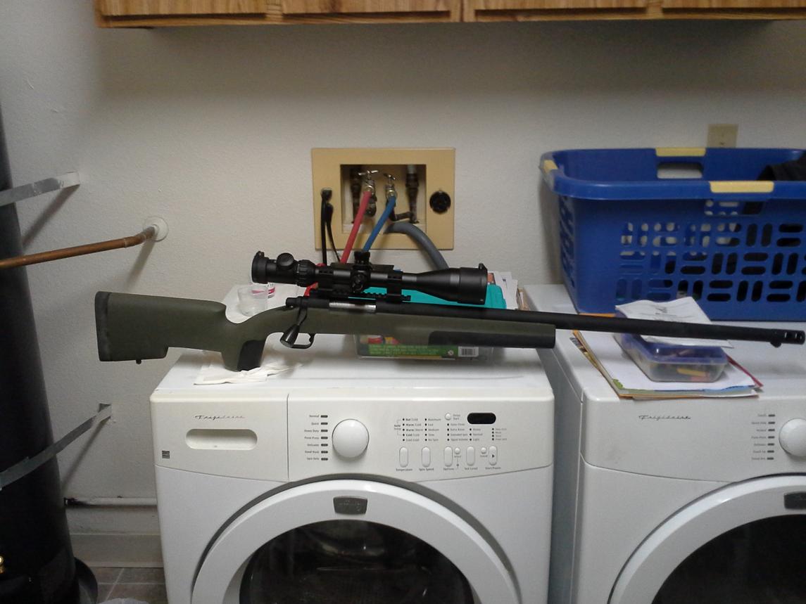

I know this is a pretty easy task to accomplish but I have had a few people from another site ask me how I did it. I also installed a few flush cups and will be installing a LOP spacer kit soon.
I purchased a Manners T4 with mini chassis for my new build from StockyStocks. They only had OD at the time, so I already planned on painting it. When it arrived I noticed that the texture was very weak and barely visible through the paint.
I first stripped down the stock and prepped it for paint.
I then tapped the areas where the new texture would be applied with blue painters tape.
I used to straight edge to mark the areas to be textured. Then using a socket, I marked the corners to round everything for a clean look.
I use Marine Tex for all my texturing and bedding. Follow directions in the box for mixing.
Using a tongue depressor or something similar, I take the Marine Tex and apply a light smooth coat over the area. I then take the tongue depressor and lightly bounce it up and down to give it texture.
Next, I set the timer for 1 hour and go bother the wife. After an hour, I lick my finger and lightly run it over the Marine Tex. Pull the tape at an angle to give it a nice and sharp edge.
Then I paint it.
