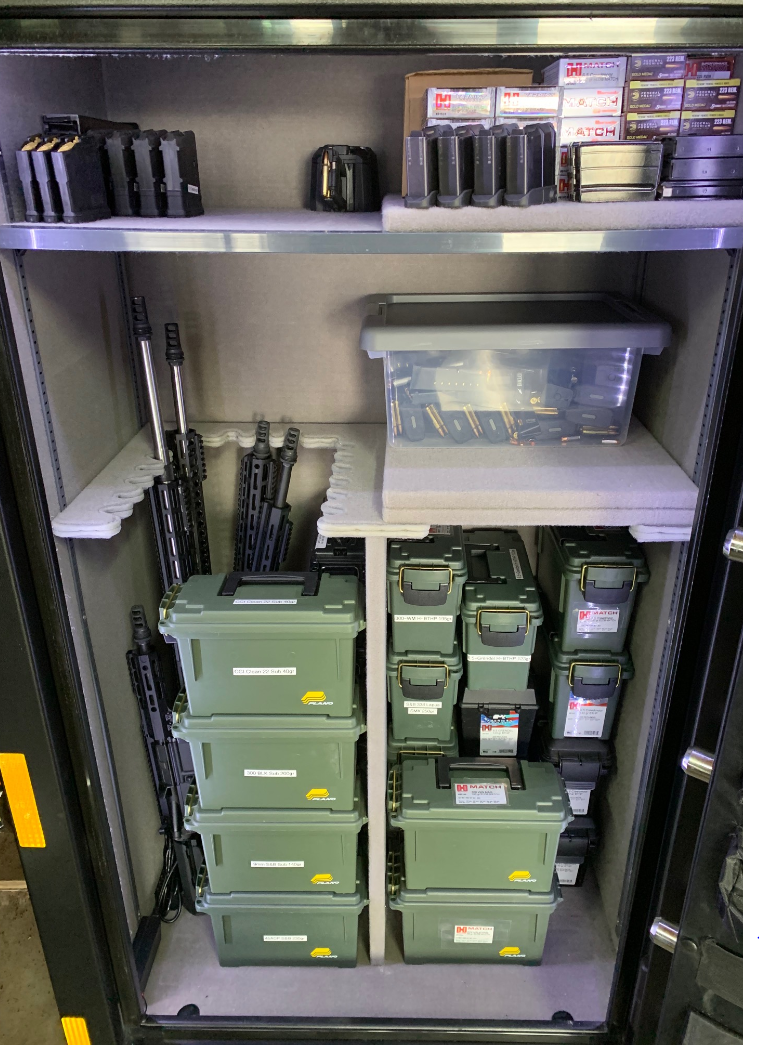

This is my ammo safe (and small rifle overflow). Without dumping to ammo cans instead of factory boxing ... I'd never have room in the safe for the ammo I need to safely store. One Plano ammo can stores about 300 rounds of .223-to-6.5 ... a bit less for 300-to-338. Also has the advantage of just "grabbing a can" when I head to the range. Not sure how I'd keep it all organized and easily transportable without the ammo cans, but to each his own.
